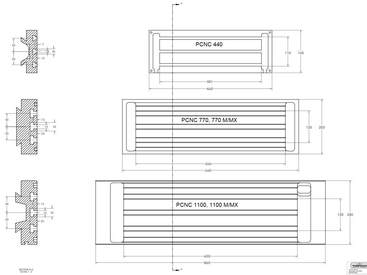

The image below, provides dimensioning of the table t-slots, across the entire Tormach mill line.
