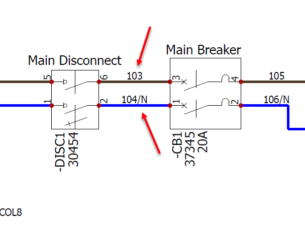

1300PL
104/N and 103
230 Vac nominal

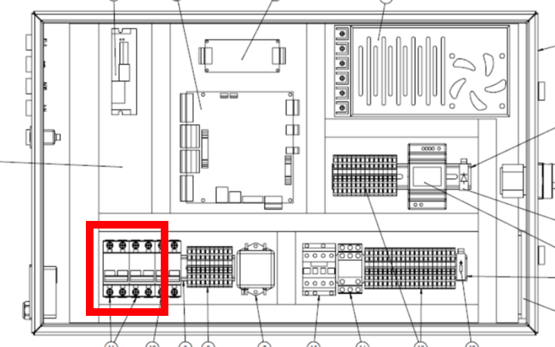

Reset the CB1 and/or CB3 Circuit Breaker
Reason: The CB1 and/or CB3 circuit breaker tripped.
  1. Identify your machine in the following table and measure the wires as indicated.
  2. If required, power off the machine and reset the tripped breaker.
Machine
Wires (CB1 and CB3)
Measure for…
1300PL
105 and 106/N
and
111 and 112/N
230 Vac nominal
CB1 and CB3 Breaker Location.

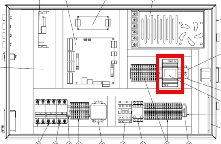

Inspect the DC power supply (PS1)
Reason: The DC power supply PS1 is defective.
  1. With a multimeter measure the Vdc between 401 and 402.
  2. If the digital multimeter reads below 22 Vdc, with a multimeter measure between 113 and 114/N for the input Vac.
    If the input Vac is correct, replace the DC power supply.
Machine
Wires
Measure for…
1300PL
401 and 402
24 Vdc nominal
Machine
Wires
Measure for…
1300PL
113 and 114/N
220 Vac nominal
PS1 Location
