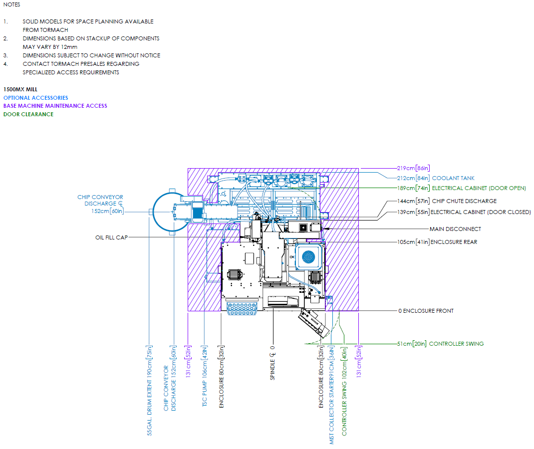

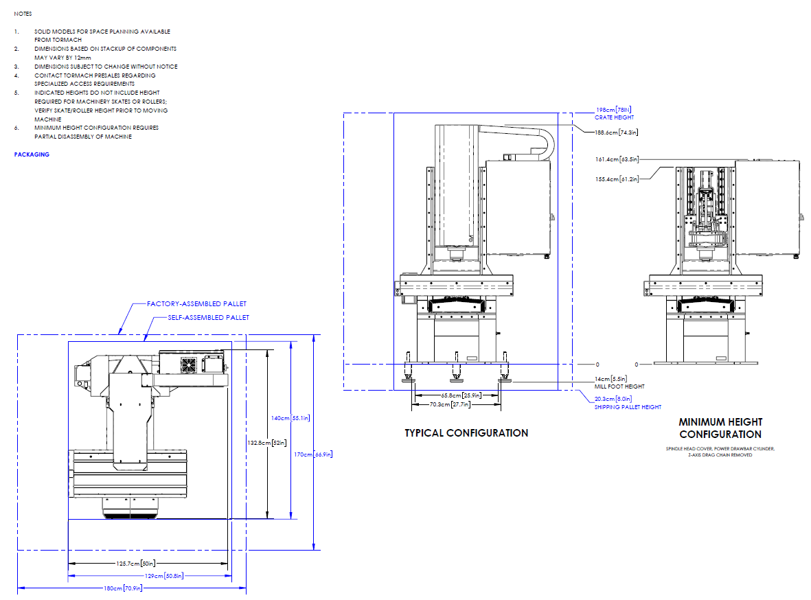

Space Requirements
The area must meet the following space requirements. Allow more space to access the rear of the machine for maintenance and repairs.
NOTE: For a detailed drawing of the space requirements, refer to the end of this chapter.
  • Machine Size 86" × 104" (2.2 m × 2.6 m)
  • Machine Height 94" (2.4 m)

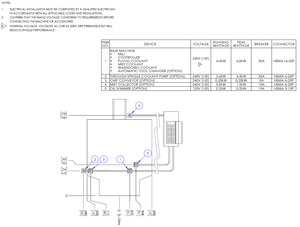

Electrical and Power Requirements
You must verify that the site conforms to the following electrical and power requirements.
Electrical Requirements
A certified electrician must make all electrical connections, and it's your responsibility to verify that the electrical installation of the machine meets all local regulations and electrical codes.
  • Primary Power Required Single-Phase 230 Vac, 50/60 Hz
  • Recommended Circuit Amperage 30 A breaker
Power Requirements
If the site conforms to the electrical requirements, verify that it meets the following power requirements:
  • No Electrical Noise Primary power must be provided by a dedicated circuit, which must be isolated from electrically-noisy devices like welders or plasma torches. The machine should be isolated from inductive loads from items like vacuum cleaners or air compressors.
  • No Ground Fault Circuit Interrupter Power for the machine must not be protected by a ground fault circuit interrupter (GFCI), as it interferes with the operation of the servo drives.
  • Proper Grounding You must properly ground the power input to the machine. Examine the continuity between bare metal on the machine frame and true earth ground (a water pipe or similar) to verify that it's properly grounded.
  • Correct Plug Pattern The machine is shipped with a NEMA L6-30P plug, designed for use with a NEMA L6-30R receptacle.

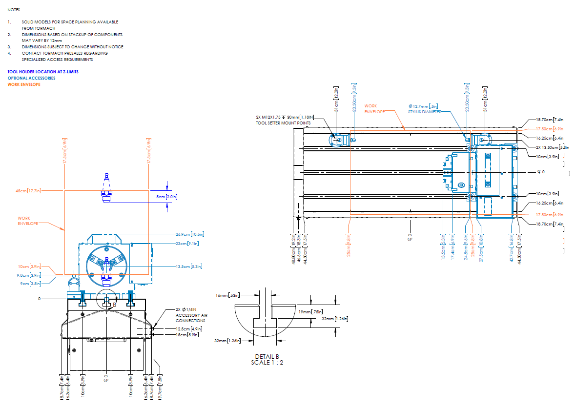

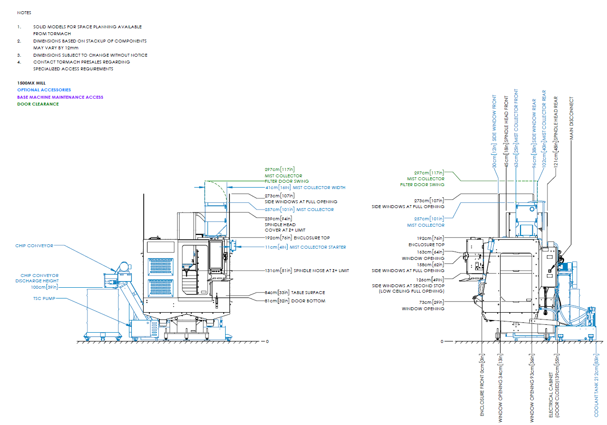

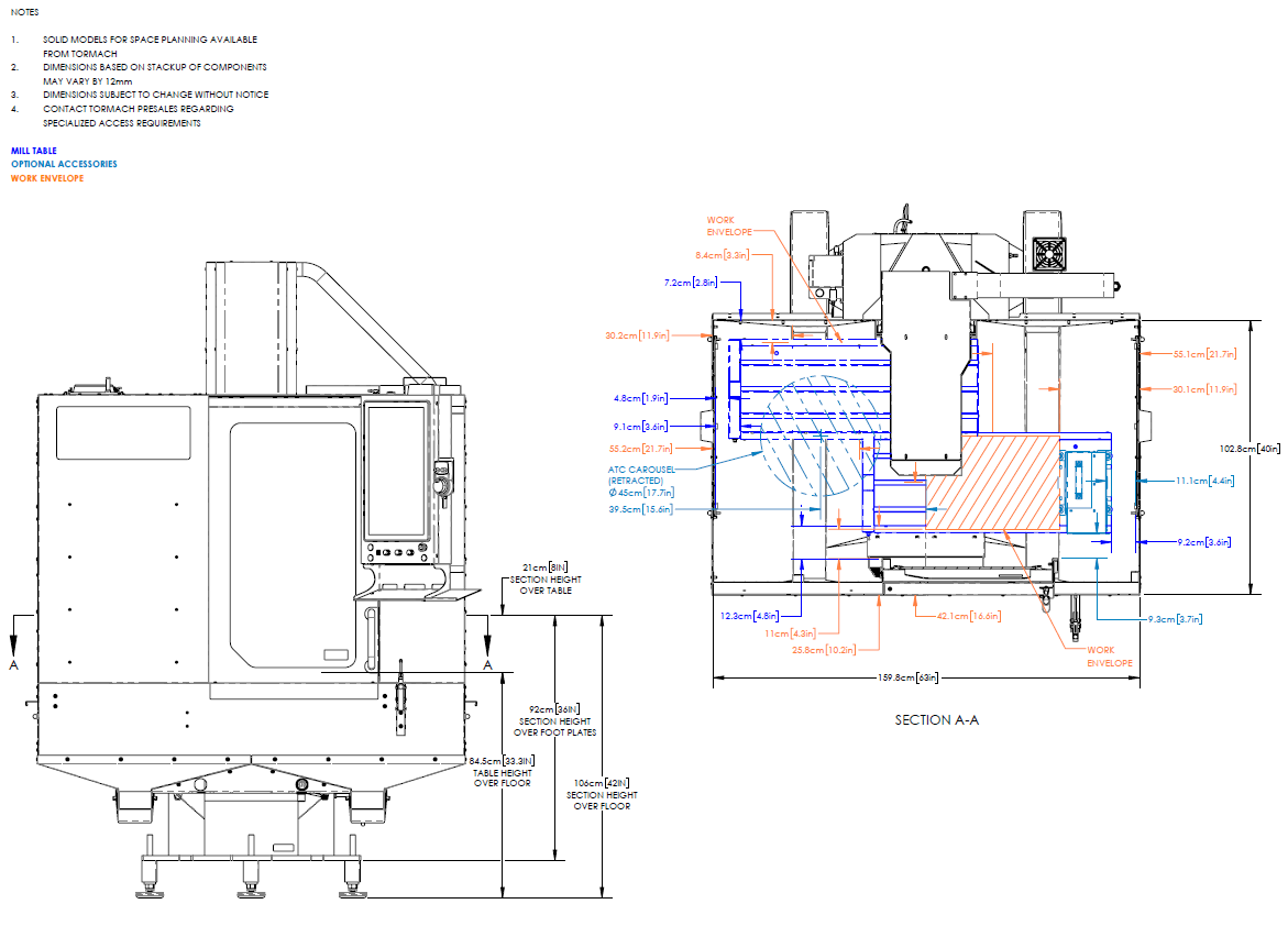

Space Planning Drawings
Space Planning
Minimum Transport Height
Table Clearance
Table Details
Electrical Site Plan Drawings
