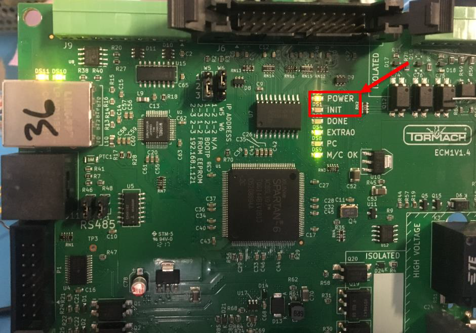

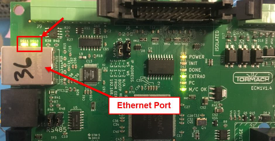

ECM Board
    If it is not lit at power up but lights up later, that means that there was a successful connection to the controller, but it has since disconnected. Go to Step #4.
ECM Board
Orange LED
OFF
Blinking
ON
ON
ON
Green LED
OFF
N/A
OFF
ON
Blinking

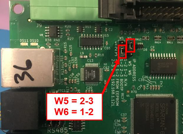

ECM Jumper Location

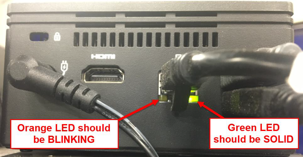

  1. Use a laptop, another computer, or a router to plug a known working cable from your device directly into the PathPilot Controller. If the orange light on the PathPilot Controller ethernet port isn’t blinking after ~15 seconds or no lights at all, then there is a configuration issue with ethernet port on the controller and continue to Step # 8. Otherwise skip to Step # 9.
Back of PathPilot Controller
  3. If you are still getting the “No Ethernet Link Detected” error, then we will need to restore the software using the “Restore PathPilot v2.0 from Hard Disk” document. This will wipe all files and settings from the controller. If you have settings/files you need to save, contact tech support.
  4. If you are still getting the error after restoring PathPilot, then the controller needs to be replaced.
