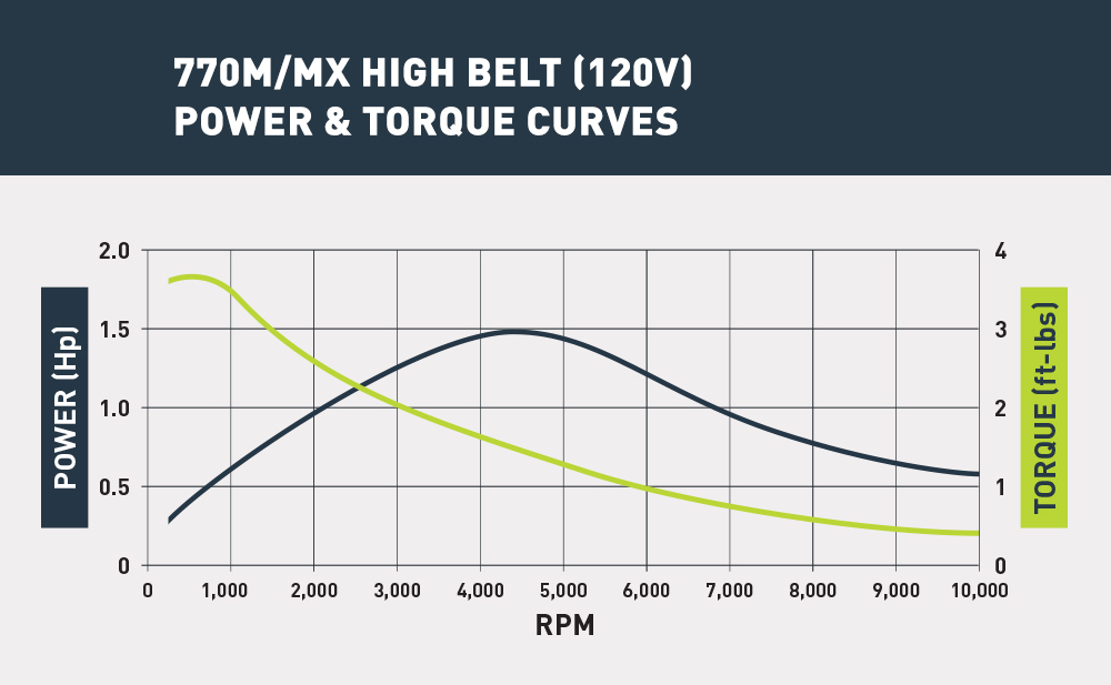

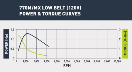

770M/MX Torque Curves (MX - MF/MH Serials)
Shown below are the results of motor testing done on the 770M/MX spindle.
120V High Belt
120V Low Belt
