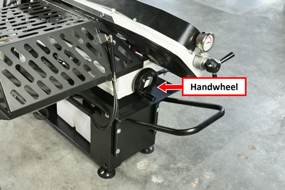

  2. Open the clamps on both vises with the handwheel and the clamp handle. Then, load the material between the vises.

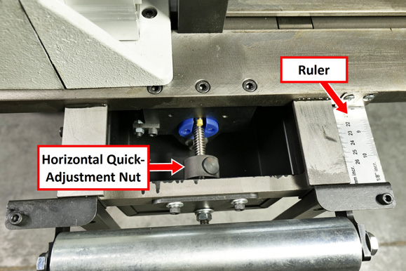

  2. On the infeed table, identify the horizontal quick-adjustment nut. Press the button on the quick-adjustment nut to loosen it. Then, move it away from the blade and past the desired length of cut.
Figure 3: Horizontal quick-adjustment nut.
The horizontal quick-adjustment nut controls the length to which the infeed table moves.
NOTE: Use the ruler to determine how far to move the components to achieve the desired cut.
  1. Adjust the infeed table until the back edge of the table is just past the desired length of cut on the ruler.
  2. Rotate the horizontal quick-adjustment nut to make fine adjustments to the infeed table until the back edge of the table is aligned with the desired length of cut on the ruler.

  3. Use the handwheel to close the fixed vise clamp until it is approximately 1/8 in. from the material.

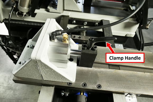

  4. Loosen the clamp handle to close the feeding vise clamp until it is approximately 1/8 in. from the material.
  5. Tighten the clamp handle to lock it in place.
  6. Remove any backlash: pull the feeding vise by hand toward the clamp handle. Then, verify that there's still approximately 1/8 in. gap between the vise and the material.

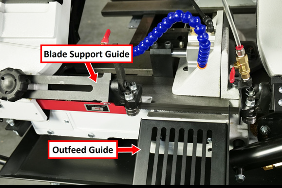

  8. On the front of the machine, locate the blade support guide. Move the blade support guide until it is 1/4 in. from the material.
Figure 4: Blade support guide on the front of the machine.

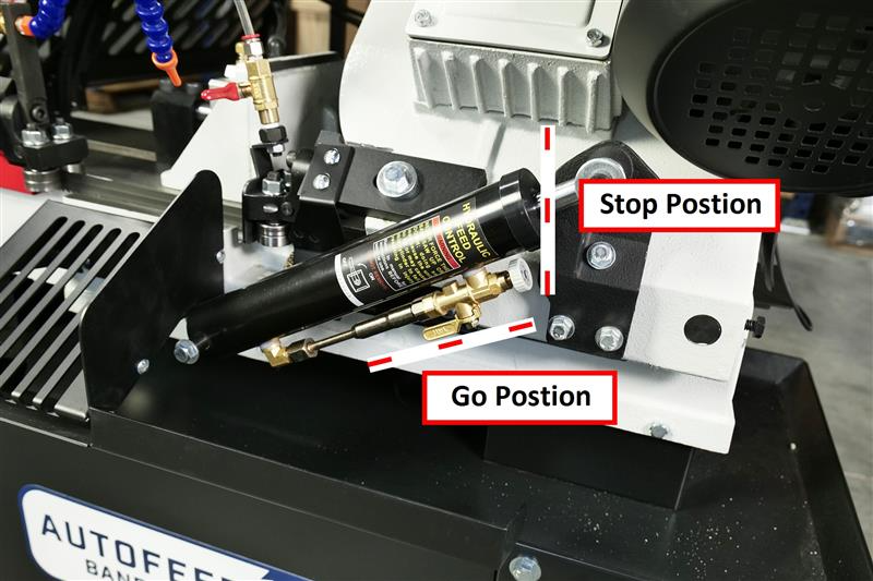

  2. On the front of the machine, identify the blade feed lever, and then move it up.
Figure 5: Blade feed lever.
The blade feed lever is now in the Stop position. While in the Stop position, the saw head doesn't move down.

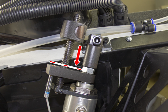

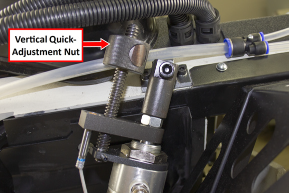

  1. On the back of the machine, identify the vertical quick-adjustment nut. Press the button on the quick-adjustment nut to loosen it. Then, move it to the top of the threaded rod.
  2. Lift the saw until the blade is about two inches above the material.
  3. Press the button on the quick-adjustment nut to loosen it. Then, lower it until it meets the lift height sensor as shown in the following image.
Figure 6: Vertical quick-adjustment nut.
The vertical quick-adjustment nut controls the level to which the saw head lifts after completing one cut and before beginning another cut.

  2. Verify that the blade feed lever is down (in the Go position).

  1. On the back of the machine, identify the vertical-quick adjustment nut. Press the button on the quick adjustment nut to loosen it. Then, move it to the top of the threaded rod.
Figure 10: Vertical quick-adjustment nut.

  1. On the front of the machine, locate the blade support guide. Move the blade support guide until it is 1/4 in. from the material.
Figure 11: Blade support guide on the front of the machine.
