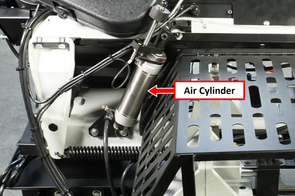

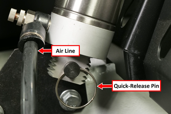

  1. On the back of the machine, identify the air cylinder, as shown in the following image.
Figure 1: Air cylinder on the back of the machine.

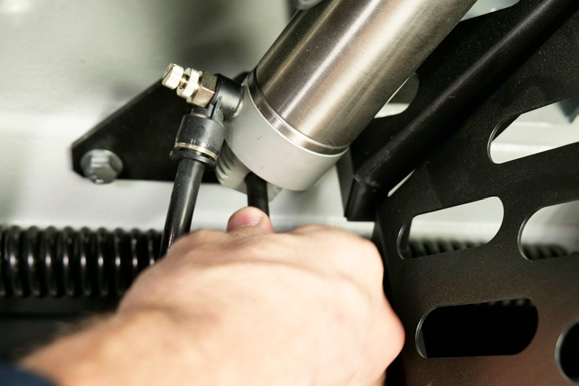

  1. Remove the cotter clip (on the end of the quick-release pin).
Figure 2: Quick-release pin on the air cylinder.
  1. Pull the quick-release pin out of the air cylinder, and set it aside.
    The air cylinder hangs from the saw head.

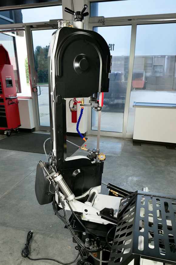

  2. Lift the saw head to the upright position, as shown in the following image.
Figure 3: Bandsaw head lifted upright.

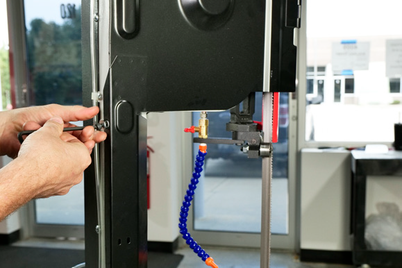

  1. Loosen the bolt securing the air cylinder to the bandsaw with an 8 mm hex wrench until the door can open. Make sure the bolt is still secure enough to hold the air cylinder in place — letting the air cylinder hang adds extra strain to the wires.
Figure 4: Bolt on the air cylinder.

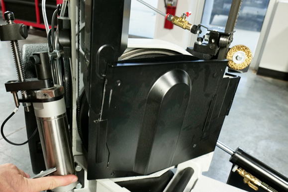

  1. Slide up the bottom of the blade cover, and then slide the blade cover up until it clears the base casting.
Figure 5: Blade cover.
  1. Remove the two screws from the side of the blade cover with a 5 mm hex wrench, and then set aside the screws.
Figure 6: Removing the screws securing the blade cover to the bandsaw.
  1. Open the blade cover, as shown in the following image.
Figure 7: Blade cover opened.

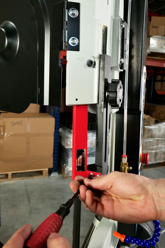

  1. Remove the two screws securing the blade guard with a Phillips screwdriver. Set the screws and the guard aside.
Figure 8: Removing the blade guard.

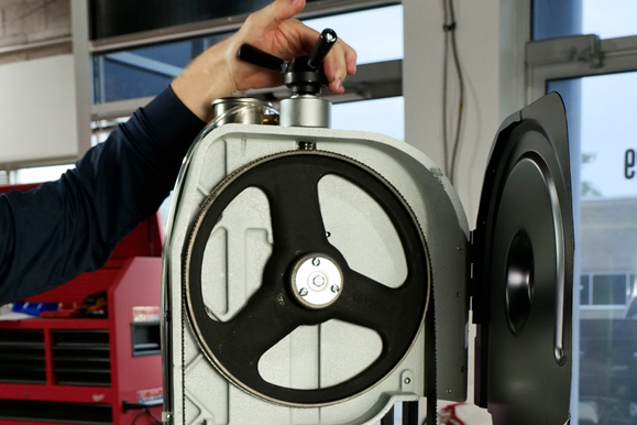

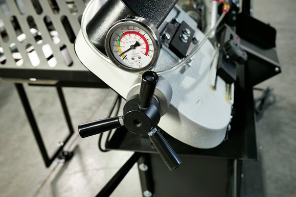

  1. Identify the tensioner on the top of the saw head.
Figure 9: Tensioner on top of the saw head.
NOTE: Only use the inner circle on the tensioner for 3/4" blades.
  1. Loosen the tensioner to remove the tension on the blade.

  4. Keep one hand on the blade to hold it in between the blade guides, and use the other hand to tighten the tensioner. Continue tightening until the needle on the blade tensioning gauge is aligned with the tip of the arrow.
Figure 10: Tensioner dial aligned with the tip of the arrow.

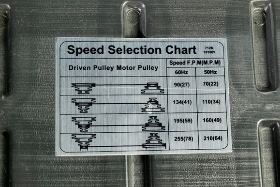

  2. Open the pulley cover.
  3. Loosen the clamping bolt under the motor.
  4. Turn the belt tensioning bolt counterclockwise to loosen the tension on the belt. Continue to turn the bolt until you can remove the belt from the pulleys.
  5. Move the belt from one position on the pulleys to another. Refer to the speed selection chart inside the pulley cover for more information.
Figure 11: Speed selection chart inside the pulley cover.

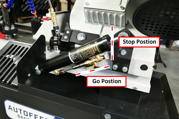

Change the Feed Rate
Determine the feed rate by observing how the bandsaw is operating and the chip formations that it's cuts are producing.
NOTICE! If the feed rate is too high, it could cause stalling or the blade to break. If the feed rate is too low, it could dull the blade too quickly.
To change the feed rate:
  1. Open the hydraulic flow on the blade feed lever: turn the lever so that it's inline with the cylinder.
Figure 12: Blade feed lever.
  1. Adjust the feed rate:
  • To Increase the Feed Rate Turn the dial on the blade feed lever counterclockwise.
  • To Decrease the Feed Rate Turn the dial on the blade feed lever clockwise.
  1. Close the hydraulic flow on the blade feed lever: turn the lever so that it's perpendicular with the cylinder.

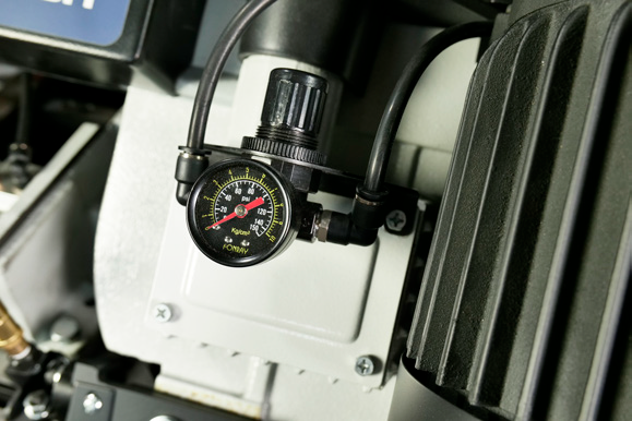

Change the Clamping Pressure
NOTE: Choosing the clamping pressure — or the amount of force that the jaws exert onto the part — depends on the type of material you're cutting. For more information, see a machinist's handbook.
To change the clamping pressure:
  • Adjust the pneumatic regulator on the gearbox to increase or decrease the clamping pressure.
