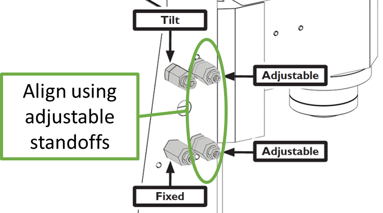

Alignment
Reason: Upon install, or after a ATC malfunction, adjustment may be needed on your ATC.

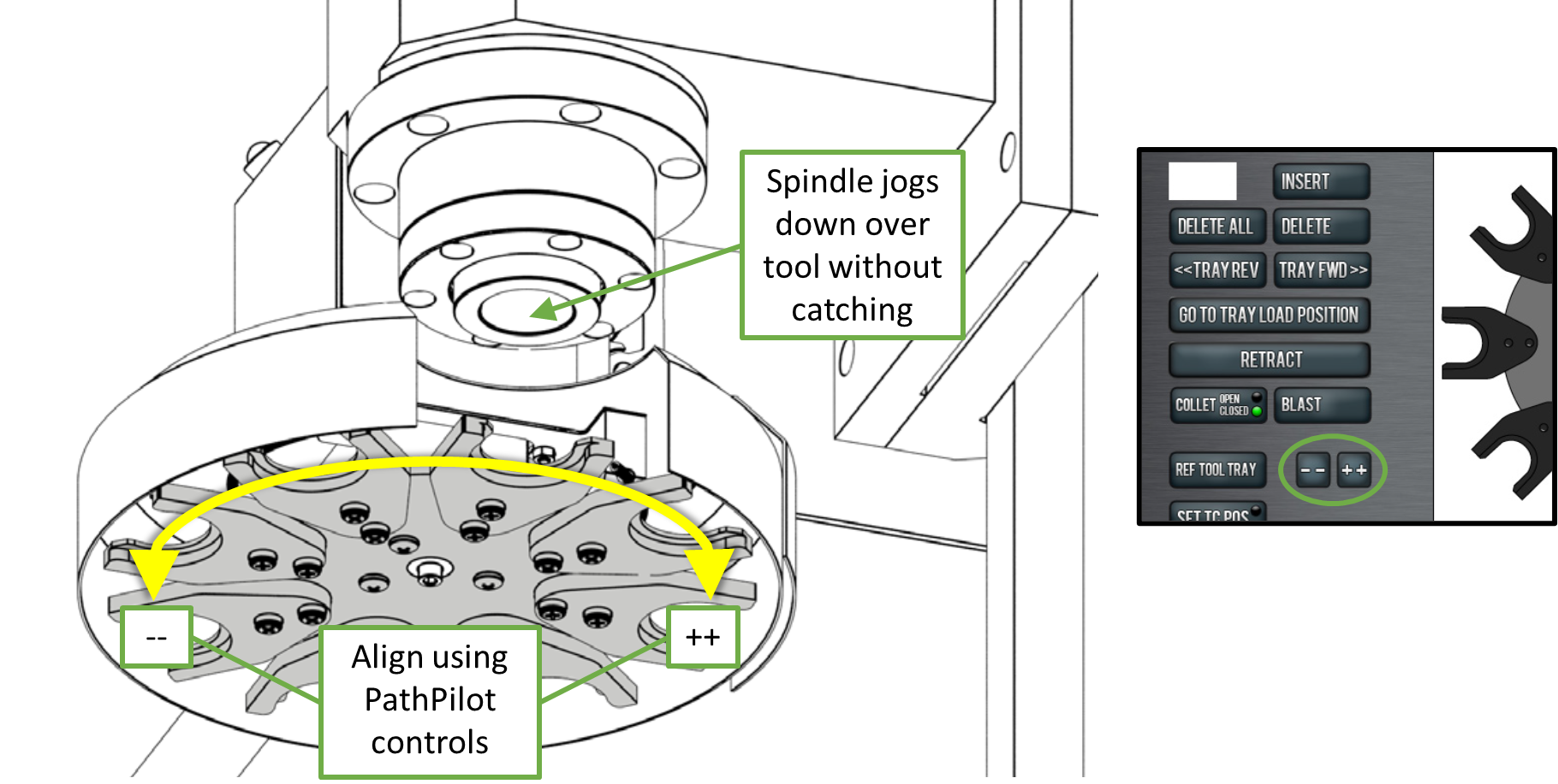

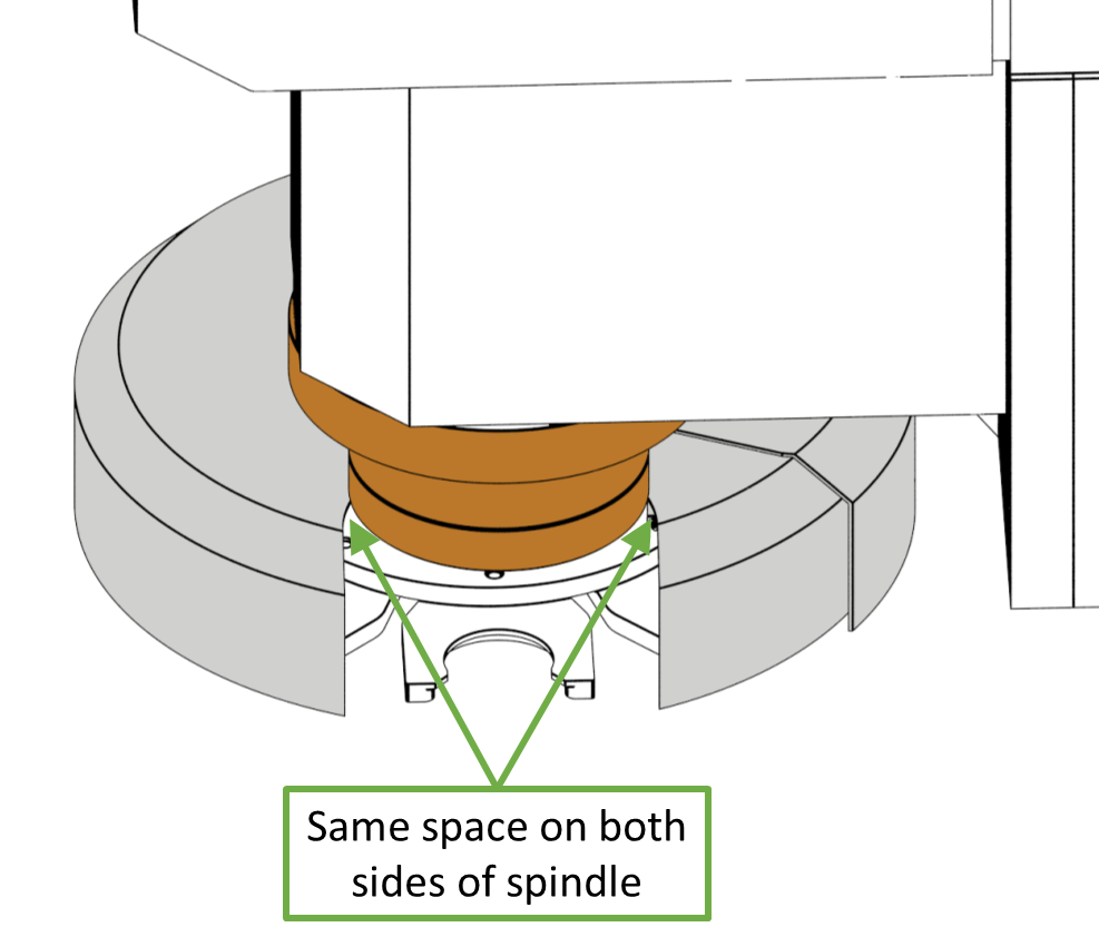

  1. Align the ATC with the Spindle Nose.

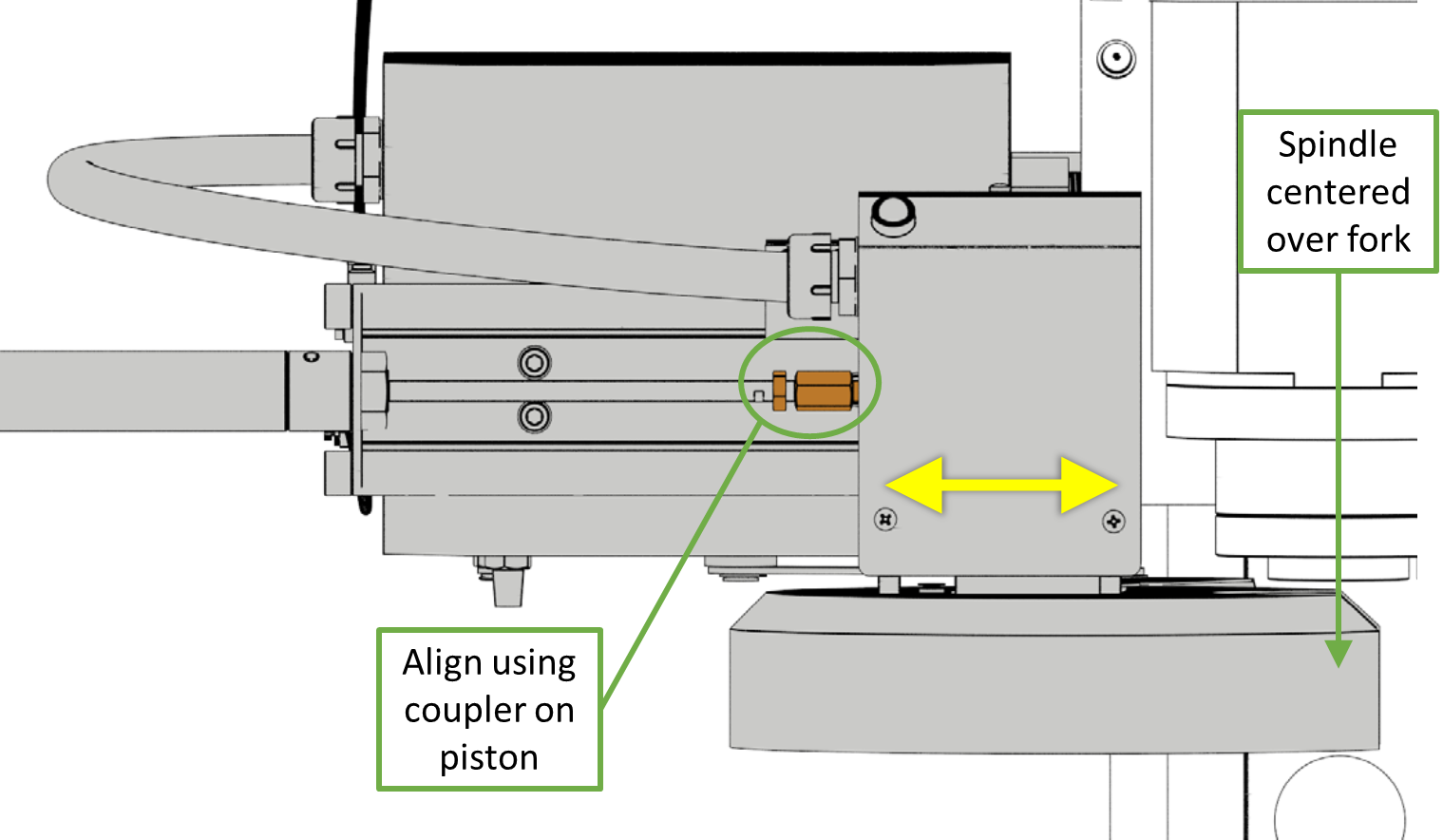

  1. Align the ATC in the X direction.

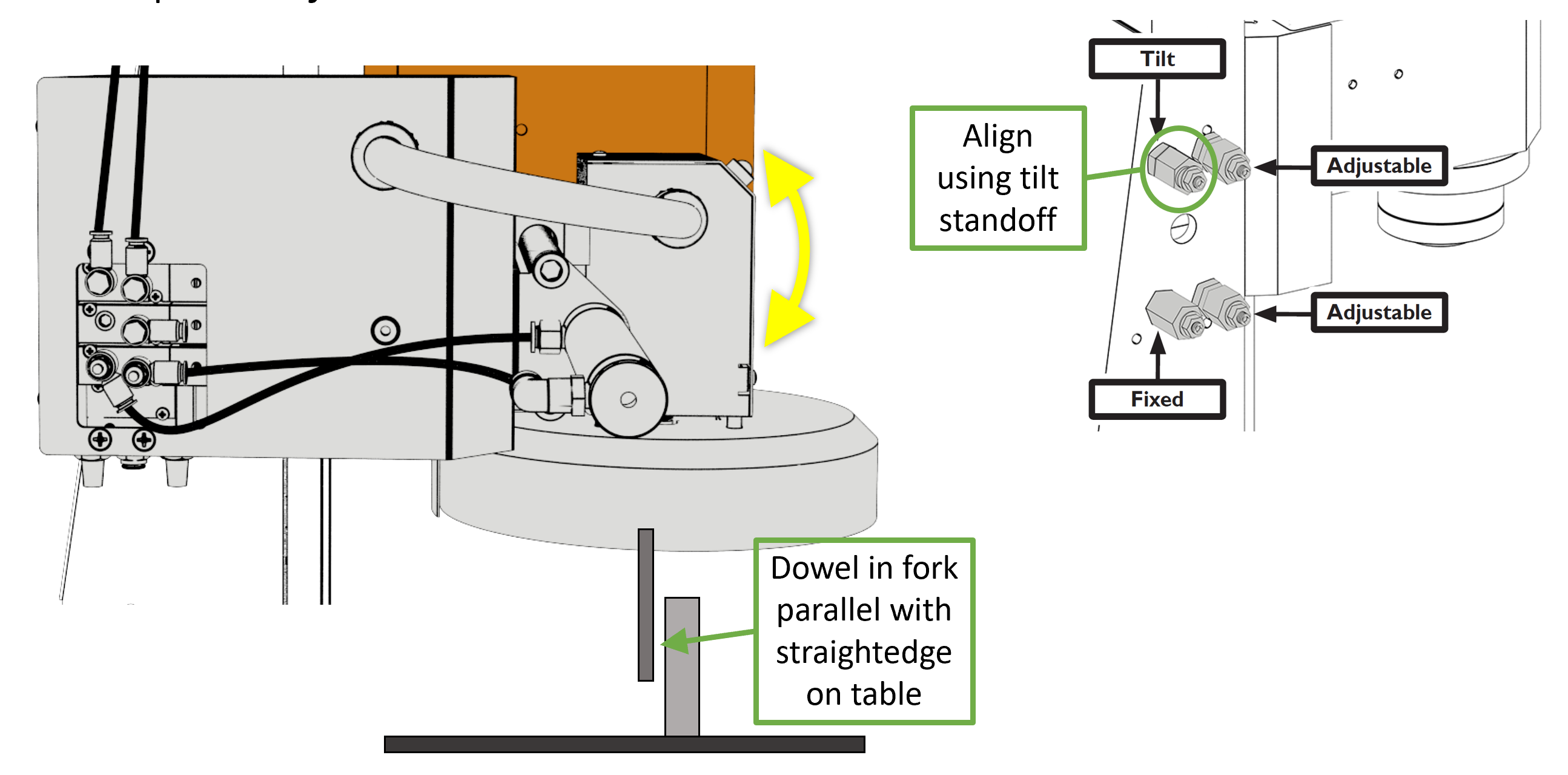

  1. Adjust ATC Tilt in X Axis
  1. Adjust ATC Tilt in Y Axis
  1. Adjust Tray Rotation

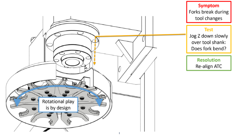

Forks Breaking During Tool Changes
Reason: Misalignment

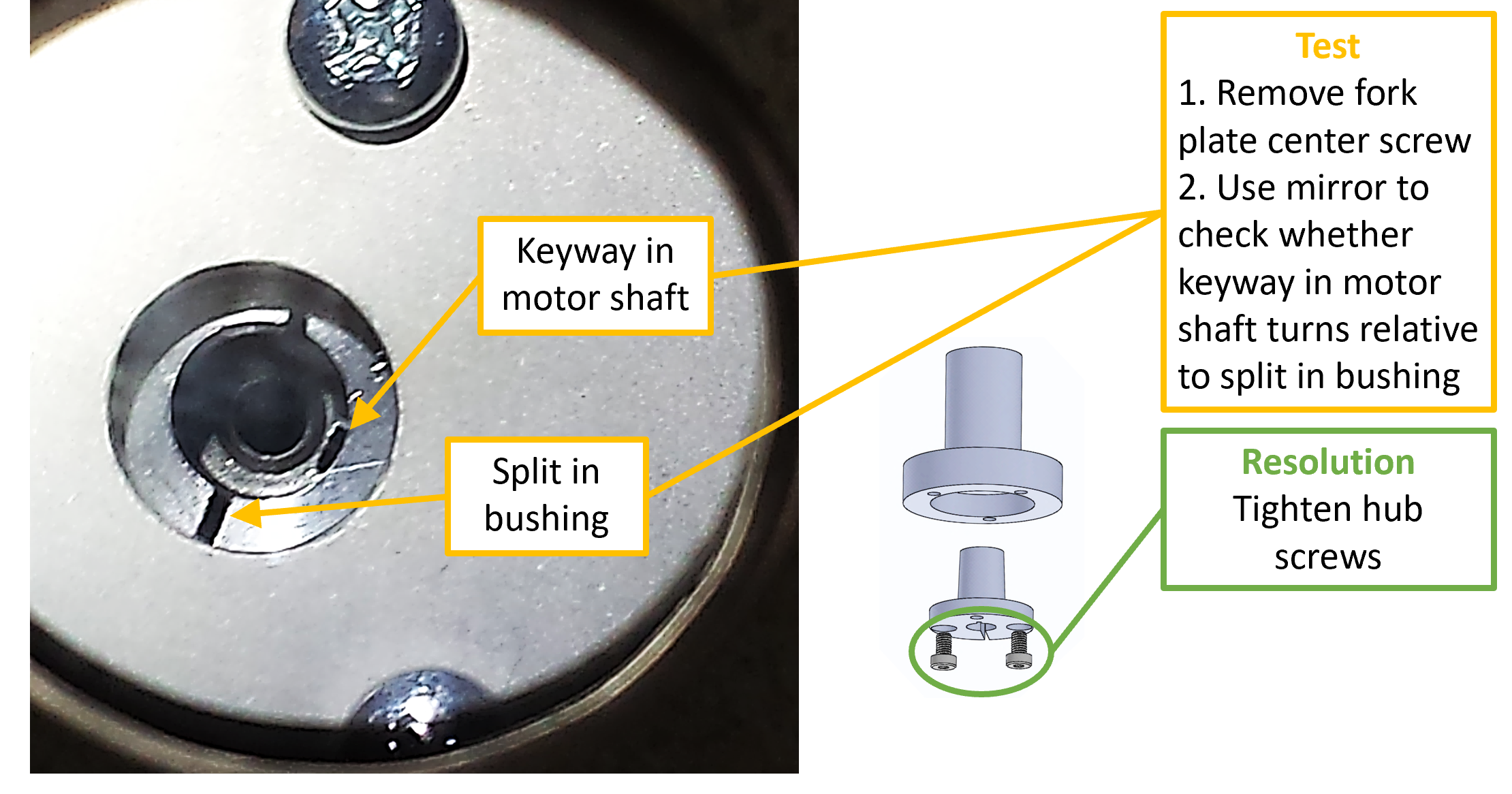

Forks Breaking After Several Successful Tool Changes
Reason: Loose hub

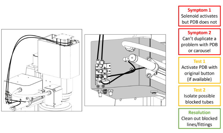

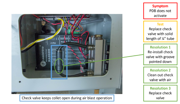

Power Draw Bar Does Not Activate
Reason: Check valve
Solenoid Activates but PDB Does Not
Reason: Blocked air lines
