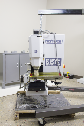

Lift and Move the Machine
  1. Move the machine's pallet and stand as close as possible to the desired location with a pallet jack. The machine stand must be positioned behind the machine.
  2. Put the chip pan on top of the machine stand.
  3. Remove any excess shipping grease on the machine with a mild degreaser (like WD40® or similar).
  4. Remove the nuts from the four studs that hold the machine to the pallet with a 16 mm wrench. Discard the nuts.
WARNING! Transportation and Lift Hazard: Before moving the machine, you must confirm that all persons are clear of the area below the machine. Qualified professionals must transport, lift, and move the machine. Moving parts can entangle, pinch, or cut you, causing death or serious injury.
  1. Secure an engine hoist to the eye bolt on the top of the machine column, and then lift the machine from above.
Figure 2: Engine hoist secured to the eye
WARNING! Crush Hazard: While lowering the machine onto the machine stand, you must keep your hands away from all moving parts. Moving parts can entangle, pinch, or cut you, causing death or serious injury.
  1. Slowly and steadily lower the machine on to the chip pan. Confirm that the holes in the chip pan, machine, and machine stand are aligned.
Figure 3: Lowering the machine onto the stand.
  1. Secure the machine to the machine stand with a 10 mm hex wrench and four M12 × 100 mm socket head cap screws, four M12 washers, and four M12 nuts.
  2. Once the machine is completely supported by the machine stand, remove the engine hoist.
