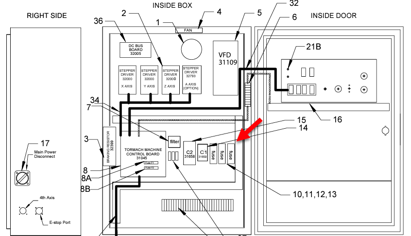

  1. If the monitor and the controller both don't have power:
    1. Examine the power cables for damage or exposed wires and replace if needed.
    2. Replace the FU6 fuse.
PCNC 770 FU6 Fuse Location
