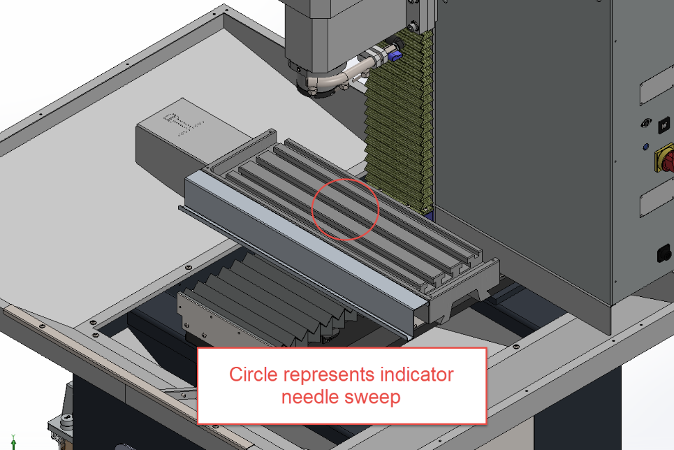

Mount the dial test indicator to the spindle such that rotating the spindle by hand rotates the indicator. Move the table to have it’s center in the Y axis positioned under the spindle centerline. Adjust the magnetic base of indicator rod such that when spun by hand the indicator needle reaches both edges of the table in the Y axis (sweeping the greatest circle possible).
Record the indicator readings at each of the positive and negative most points of the X and Y axis. Different indicators will reach either positive high or positive low, but positive high will be most common.
“Positive high” is indicated by the indicator needle reading high when the surface rises. If your indicator reads positive high, a shim will be placed opposite the position with the low reading. The shim thickness will differ based on the exact diameter of the measured circle and the reading; inserting a shim the thickness of the indicator reading is recommended.

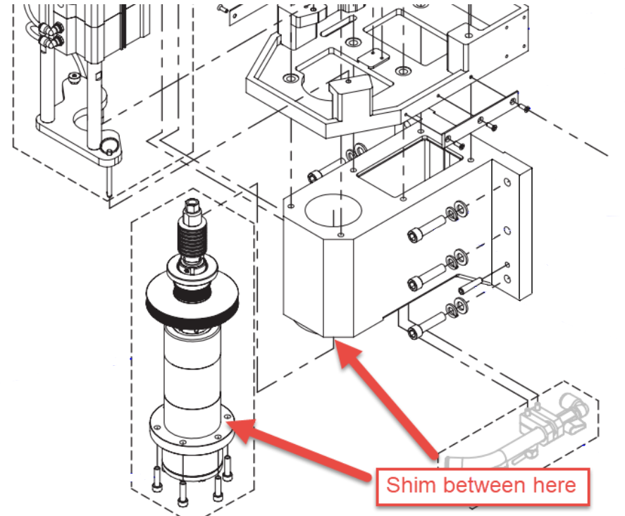

To insert the shim, remove the indicator from the spindle, loosen the spindle belt tension, then loosen the spindle flange bolts, but do not remove them. Ensure that the flange drops enough to insert a shim of the needed thickness. If it does not drop, tap the drawbar or spindle pulley with a dead blow hammer, until it drops.
After inserting the shim in the desired location, tighten the flange bolts, then take another reading with the indicator. Repeat the procedure until the indicator needle shows less than .0005” movement in at least a 6” circle.
