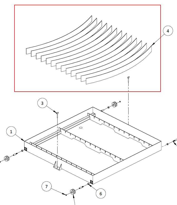

Over time, as you use your 1300PL Plasma Table, you will inevitably need to replace the 13 water table slats.
The original slats are a metric stock size. We have found it easiest to convert the slats to imperial units for the widest selection of material. We recommend changing all the slats at the same time, which also presents a good time to do a full cleaning of your water table. Use the dimensions listed below, to order some replacement slats from your preferred local metal distributor.
1/8” x 3-1/2” x 49-3/16” CRS or HRS
