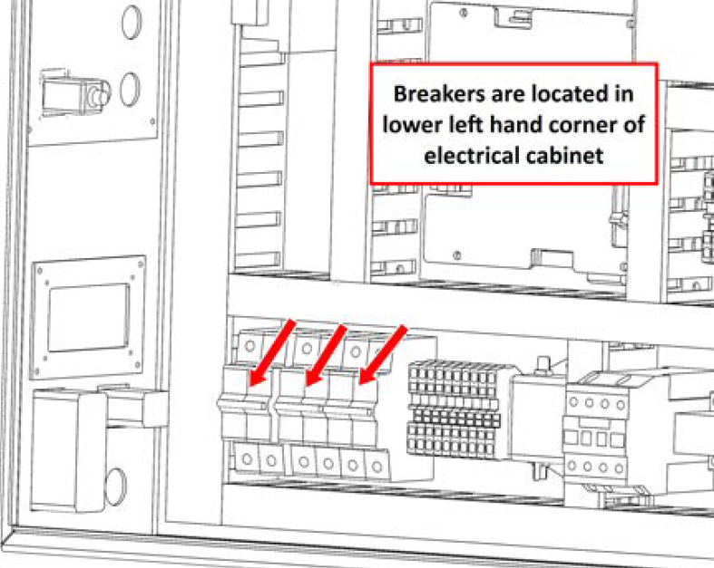

Check Machine Breakers
Check that all breakers in the electrical cabinet are switched on (up position).

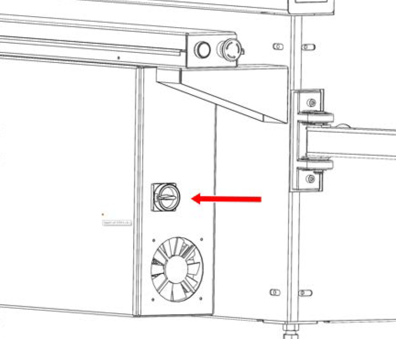

  2. Find the Main Disconnect switch, and then remove the hang tag.
Figure 1: The Main Disconnect switch on the side of the machine's electrical cabinet.

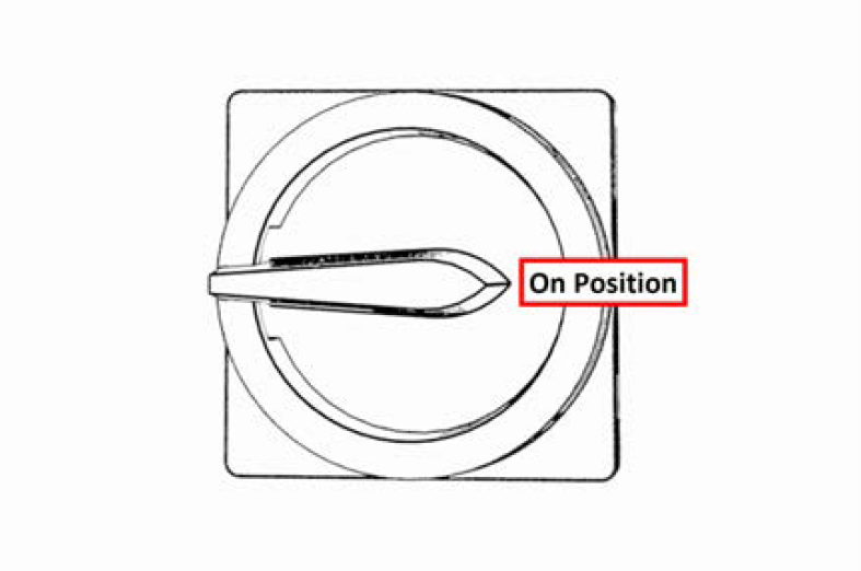

  1. Turn the Main Disconnect switch to ON.
Figure 2: Example of the Main Disconnect switch in the On position.
Mains power is now connected to the machine.

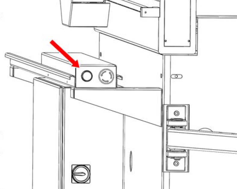

  2. Rotate the Emergency Stop button one-quarter turn clockwise to release it.
Figure 3: Emergency Stop button.

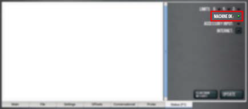

  1. Verify that the blue Reset LED comes on. From the PathPilot interface, on the Status tab, verify that the Machine OK light changes from yellow to green.
    Once both are on, the machine is powered on and ready to operate.
Figure 5: Machine OK light on the Status tab.

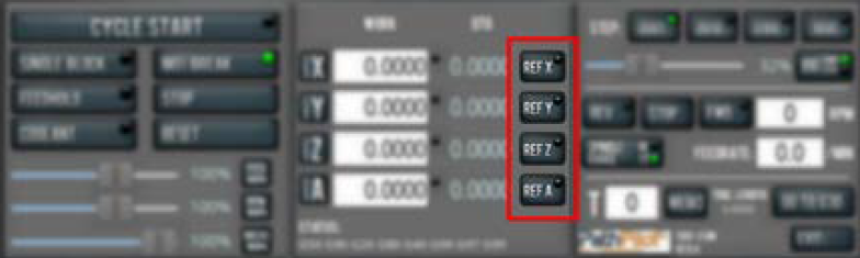

  1. Reference the axes: from the PathPilot interface, select Ref Z, Ref X and Ref Y.
Figure 7: Ref Z, Ref X, and Ref Y buttons.
The machine moves to the reference position.

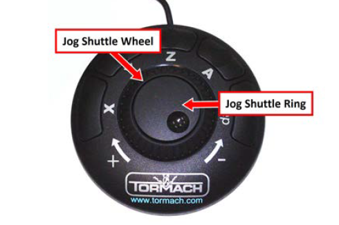

  1. If applicable, verify the optional Jog Shuttle:
  • Press any axis button on the Jog Shuttle — X, Y, Z, or A — to select an axis.
Figure 8: Functions on the optional Jog Shuttle.

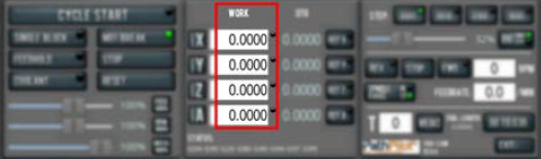

From the PathPilot interface, on the Main tab, the corresponding green Axis light comes on.
Figure 9: Axis lights.
  • Turn the Jog Shuttle Ring in any direction to move the selected axis, then turn it in the opposite direction to reverse the direction.

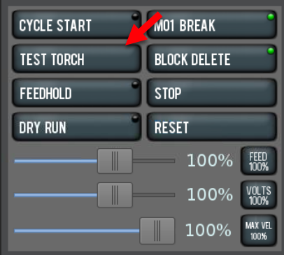

  3. Activate the plasma source and create a pilot arc by pressing the TEST TORCH button in PathPilot.
  1. Verify that your plasma source activates and creates a pilot arc (you may have to press the button twice to bypass the "warning puff" function on some plasma sources).

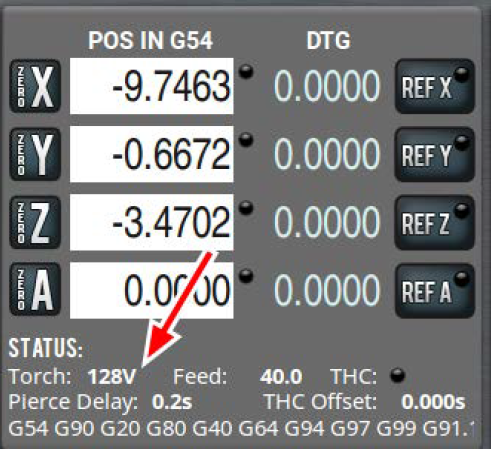

  2. While the pilot arc is active, watch the "Torch Voltage" readout at the bottom of your control screen.
  1. You should see an open-circuit voltage of above 100V. If you do not see a voltage reading, follow the "Voltage Feedback" section of the Troubleshooting guide.

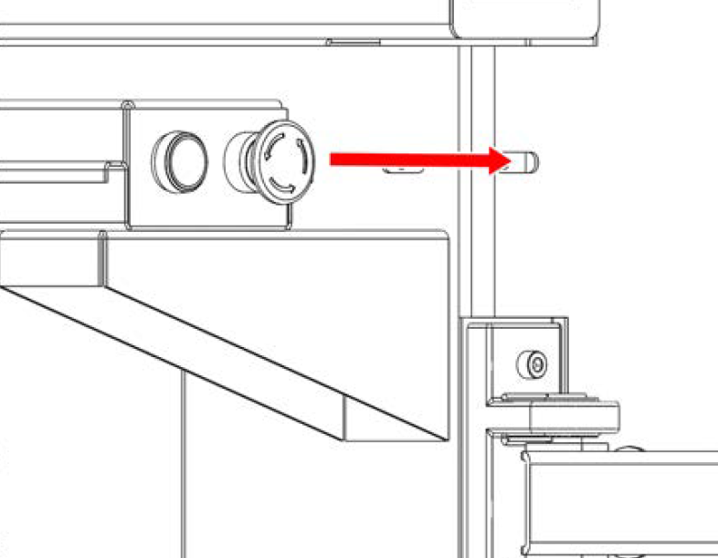

  1. Push the Emergency Stop button to lock it into the disabled position.
Figure 10: Emergency Stop button.
With the Emergency Stop button in the disabled position all motion function stops, the Reset button is disabled , and the blue Reset LED goes off. From the PathPilot interface, on the Status tab, the Machine OK light illuminates yellow.
