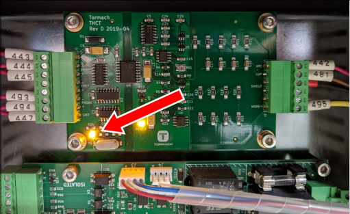

What does proper ohmic connection look like?
Open the electrical cabinet and locate the Tormach THCT Board (PN 39096). Have a helper touch the ground clamp to the torch cap and watch LED D8 on the bottom left of the board. If the LED lights up when the ground clamp contacts the torch cap, the THCT board is measure contact between the cap and ground as intended.
Indicated: D8 LED
