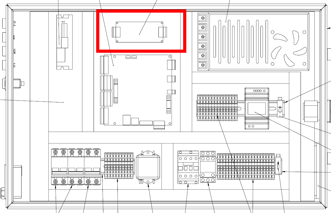

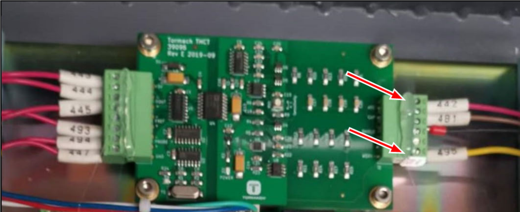

Measure Voltage Input to the THCT Board in the Electrical Cabinet
Reason: Bad control connection to a plasma source.
  1. Using a multimeter set to DC Volts, probe wires 442 and 495 on the THCT board with the torch off. You should read close to 0v DC.
  1. Have a helper press the Test Torch button in PathPilot and check the voltage. You should read your plasma source’s open circuit voltage by 50 or around 2.5v DC. (Your plasma source is required to have an internal voltage divider. By default, PathPilot is configured for a 50:1 divider.)
  2. If you do not read a voltage, you may need to replace your plasma source control cable. If you do a voltage, proceed to checking THCT communication with the ECM board.

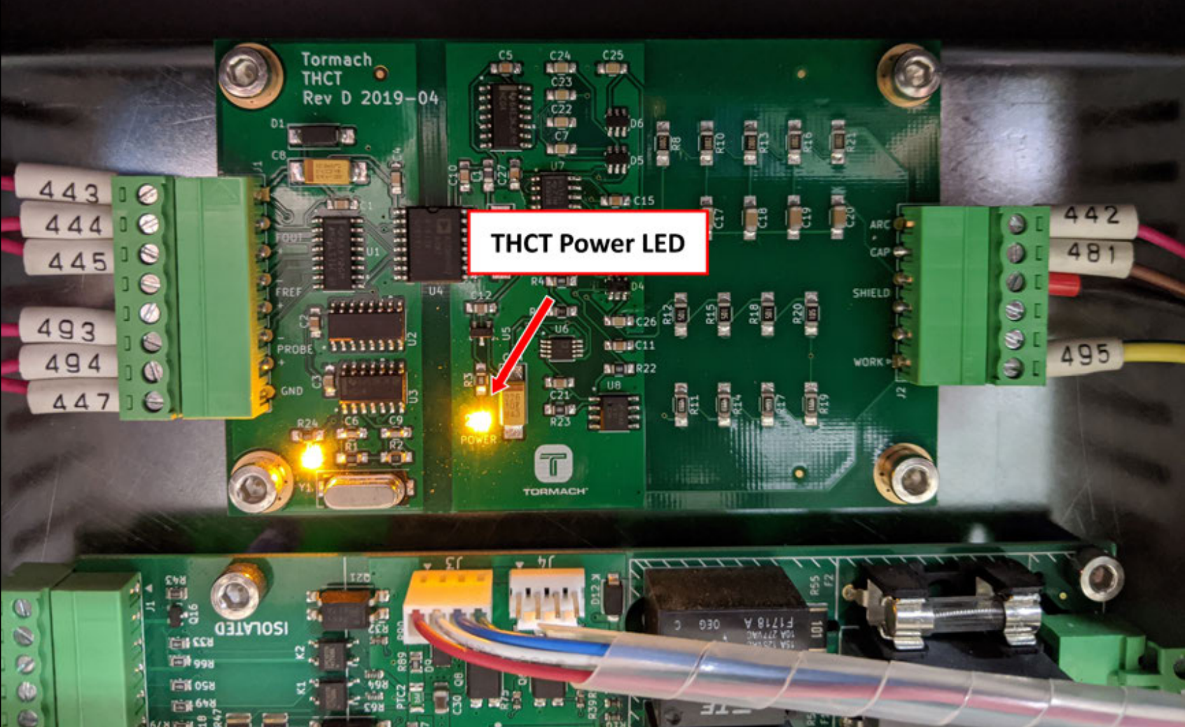

  1. Verify that the THCT board power LED is on.
