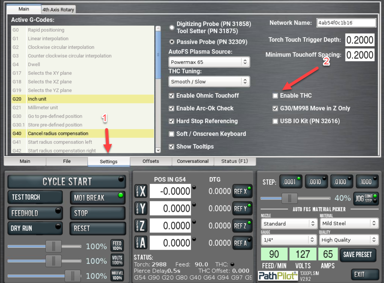

Turn Off Torch Height Control (THC)
In PathPilot, click on the Settings tab/ Then, uncheck Enable THC.

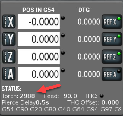

Make a Test Cut with THC Off
With THC disabled, make a test cut. While the cut is in progress, pay attention to the lower center of the PathPilot screen watch what voltage your torch cuts at. Remember this value.

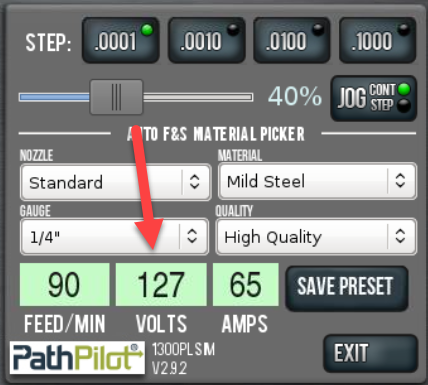

Change the Programmed Voltage in the Auto F/S Field
Type the voltage that you observed from your test cut with THC disabled into the Volts field.
Go back into the Settings tab. Check the box to re-enable Enable THC.
Make a test cut with THC re-enabled. If your torch continues to dive, contact technical support.
