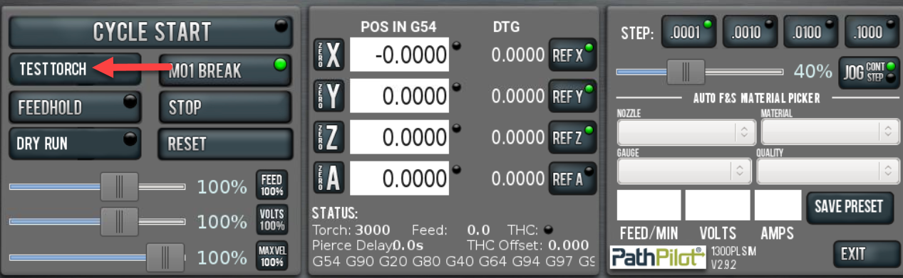

Press the Test Torch Button
Reason: Consumables are dirty or wey.
If you are using ohmic touchoff, and your consumables are dirty or get wet, this can falsely trip the ohmic probe. You can attempt to clean out the consumables by using the Test Torch button in PathPilot. This will fire torch wherever it currently rests. So, if you have a good piece of material you don’t want damaged, use this button off to the side.
