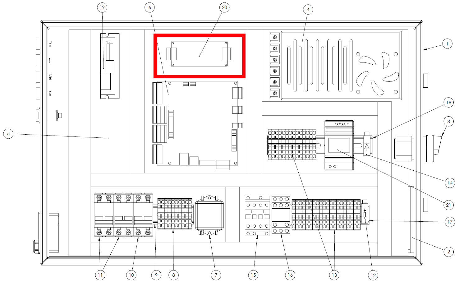

  1. Position the torch in above the workpiece in a small puddle of water, so that the torch cap is touching the water but not the workpiece.
  2. Open the electrical cabinet and locate the Tormach THCT board (PN 39096)
THCT Board Location
  1. Adjust the “RV1” potentiometer counterclockwise to decrease the sensitivity until the ohmic probe is not triggered by the water but is still triggered if you lift the workpiece to touch the torch cap.
