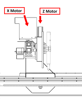

Z Torch Head
The Z Torch head is responsible for control of torch height during cutting. It also contains the magnetic torch breakaway head and the proximity sensor required to detect a breakaway.
The Z head can travel 3.9" (100 mm) vertically, which allows for cutting bulky items or even changing the height of the slats in the water table if cutting conditions require it.

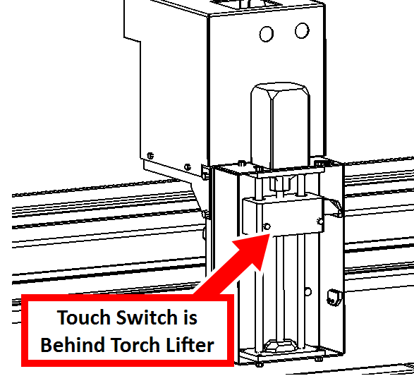

Physical Touch Switch
The physical touch switch acts as a backup to the ohmic touch system. It consists of a micro-switch inside the lifter head that detects when the spring-loaded lead nut on the Z lifter is pushed back by contact with the workpiece.
The physical touch switch will automatically be used when the ohmic touch switch does not trigger first. This can be useful in situations like cutting painted metal, where no continuity with the workpiece is possible.
NOTE: Even though the physical touch switch allows you to touch off on painted metal, you will still need to grind away enough paint for the ground clamp to make contact!
