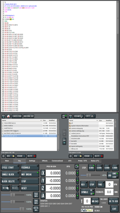

Create and Load G-Code Files

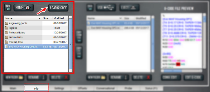

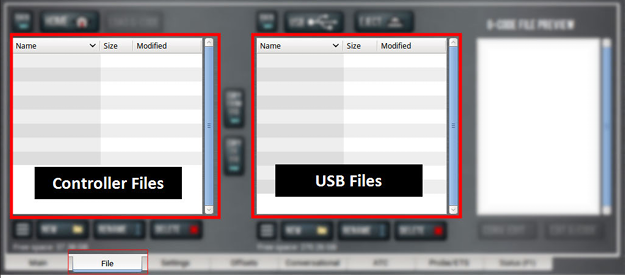

Load G-Code
To load G-code:
  2. Select Load G-Code.

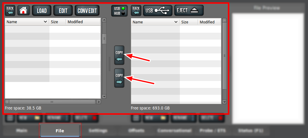

Figure 1: Controller Files window on the File tab.

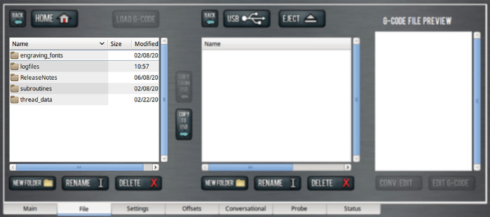

Figure 2: File tab.

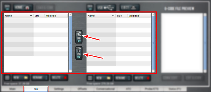

  2. Select either Copy ← or Copy →.
Figure 3: File tab.
  1. If you're using a USB drive, select Eject.

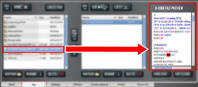

Preview G-Code Files
To preview G-code files:
Figure 4: File tab.

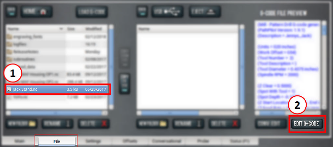

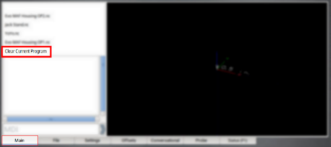

Close the Current Program
Figure 6: Recent Files menu on the Main tab.
Figure 7: Edit G-code button on the File tab.
  2. Close the text editor.

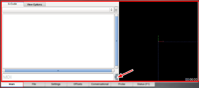

Expand the G-Code Tab
To expand the G-Code tab:
  • Select the Window Expander.
Figure 8: Window Expander on the Main tab.

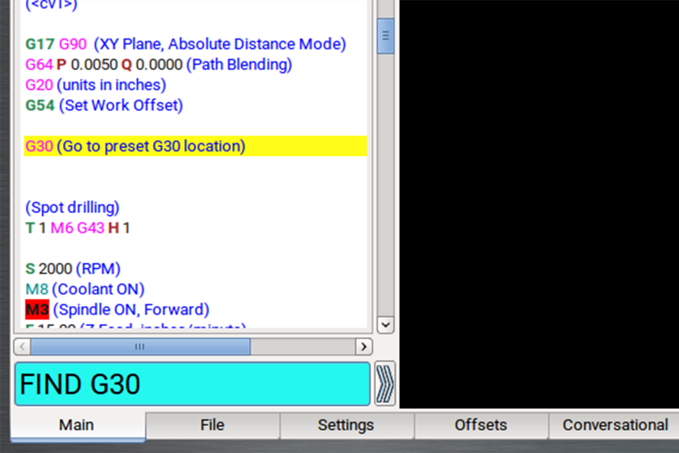

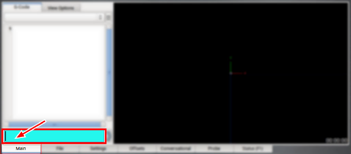

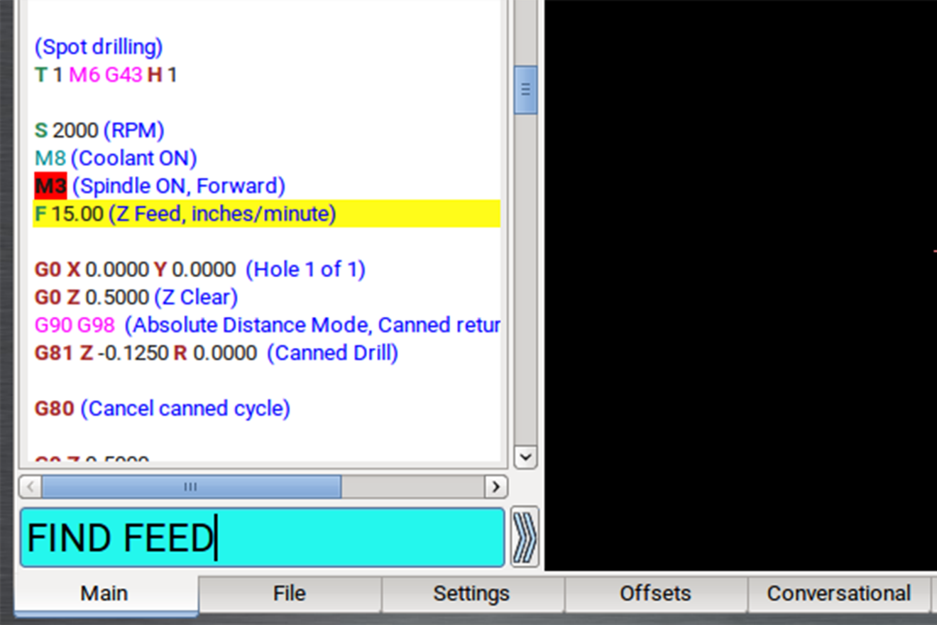

Search in the Code
To search in the code:
Figure 9: Search for a text command.
Figure 10: Search for a feed command.
  1. Select the Enter key.
  2. (Optional) Select Enter.

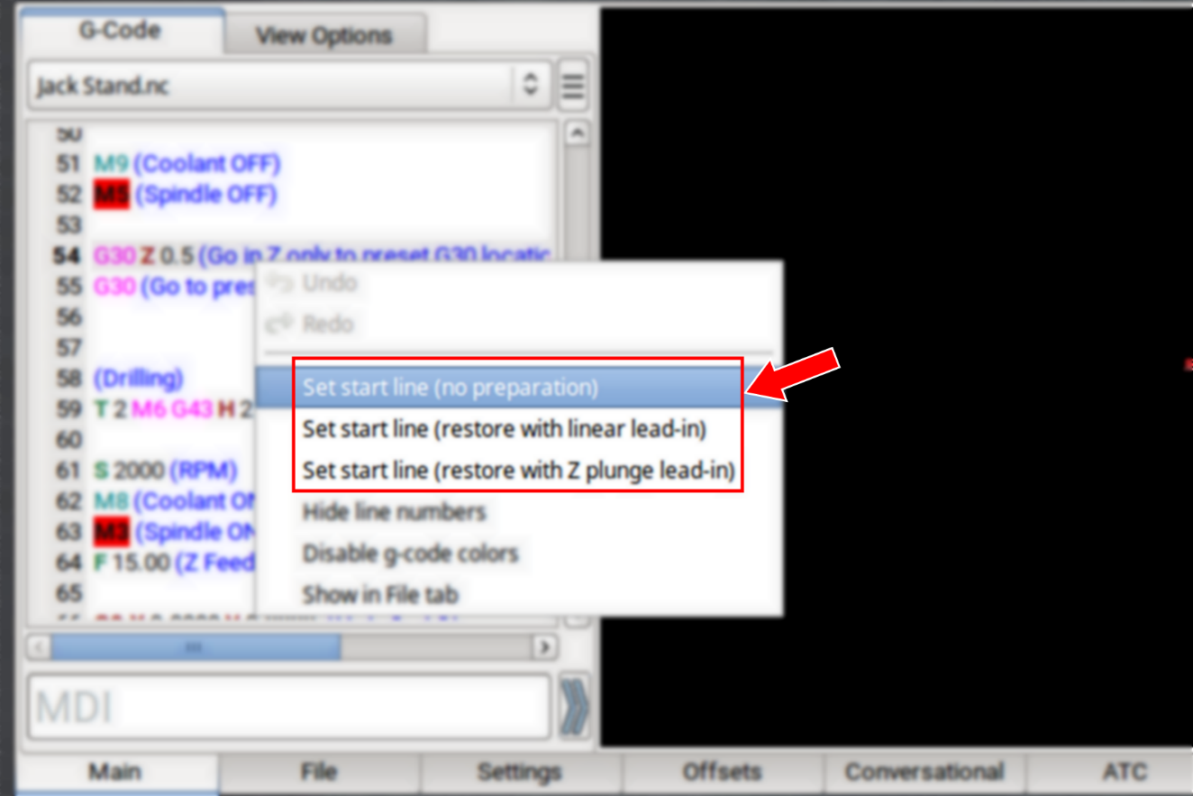

Set a New Start Line
To set a new start line:
  • Right-click any line in the program.
Figure 11: Accessing the Options menu by right-clicking.
  • Tap the line. Then, select the Options menu.

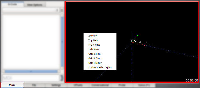

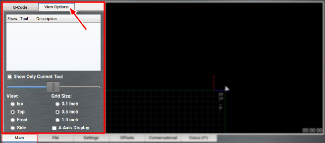

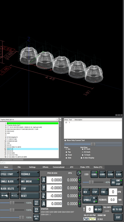

Figure 12: Tool Path display on the Main tab.
Figure 13: View Options tab on the Main tab.
  1. Select a new view.
About the Tool Path Display
Depending on which programming mode you're in (G20 or G21), PathPilot defaults to one of the following grid line spacings:

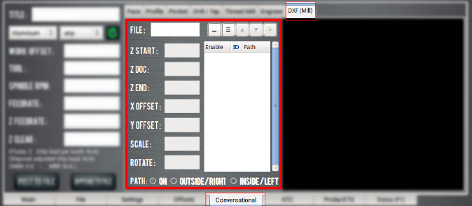

Import a DXF File
Figure 14: DXF tab on the Conversational tab.
  1. Select the File DRO field.
Example

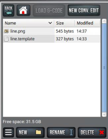

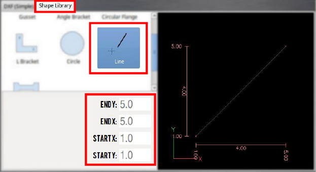

Create and Add Shape Library Templates
Starting with PathPilot v2.9.0, you can create and add new templates to the Shape Library system.
Templates consist of two files:
  • .template: A parametric G-code file that serves as the actual template.
  • .png: A thumbnail image to identify it in the shape library.
Tip! We recommend that you create templates externally in your favorite G-code editor and then copy them to your PathPilot controller like you would any other file.
Create a Template
  1. Create a new file named [shape_name].template, where [shape_name] is your desired template name.
Example
To create a template for a welding bracket, make the file name welding_bracket.template.
  1. Inside the file that you created in Step 1, you can write regular G-code with the addition of special parametric variables that PathPilot uses to display adjustable parameters in the Shape Library.
    The following example is a template file that creates a line from one (X, Y) location to another:
line.templateText#<start_x> = 1.0 (PARAMFLOAT)
#<start_y> = 1.0 (PARAMFLOAT)
#<end_x> = 5.0 (PARAMFLOAT)
#<end_y> = 5.0 (PARAMFLOAT)
G20 (set units to inches)
G91.1 (Restore Incremental Arc Distance Mode)
G90 (Absolute Distance Mode)
G30
M200
G0 X[#<start_x>] Y[#<start_y>]
G15
G16
(Cut to end of line)
G1 X[#<end_x>] Y[#<end_y>]
M205
NOTE: The special lines at the top each create a parameter that PathPilot recognizes and displays on screen. Each parameter can either have the type PARAMFLOAT or PARAMINT for floating point numbers or integers, respectively.
  1. (Optional) Once you've written the G-code for your template, you can create a .png image to use as the thumbnail. The image must:
  • Be sized to 256 pixels × 256 pixels.
  • Use a file name that matches the template name.
Example
A thumbnail for the template welding_bracket.template requires an image with the file name welding_bracket.png.

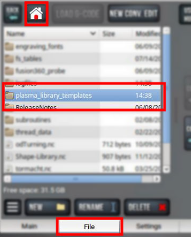

Add a Template
  1. From the PathPilot controller, on the File tab, find the plasma_library_templates folder inside the Home directory. If you don't see this folder, make sure that you've updated to the latest version of PathPilot.
  1. Copy the .template file and the .png file that you created into the plasma_library_templates folder.
  1. Restart PathPilot.
    Your new template displays on the Shape Library tab, with any defined parameters from the .template file displayed as configurable options.

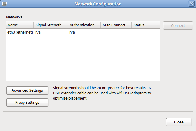

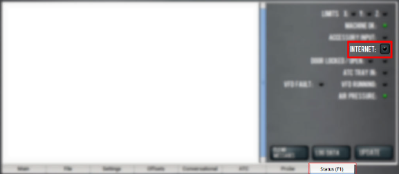

Enable an Internet Connection
If desired, you can enable an internet connection on your PathPilot controller. An internet connection allows you to receive automatic PathPilot updates and transfer files with PathPilot HUB instead of a USB drive.
Figure 15: Internet button on the Settings tab.
Figure 16: Network Configuration dialog box.

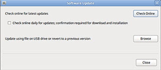

Enable Automatic Updates
To enable automatic updates:
Figure 17: Software Update dialog box.
  2. Select Close.

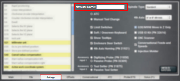

Change the Network Name
To change the network name:
Figure 18: Network Name field on the Settings tab.

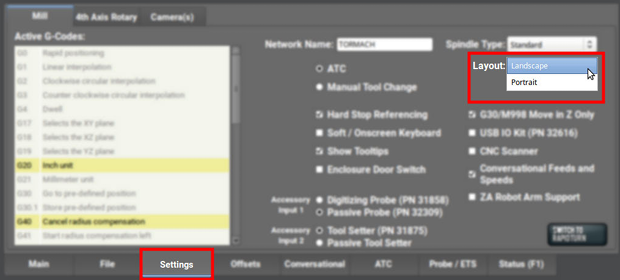

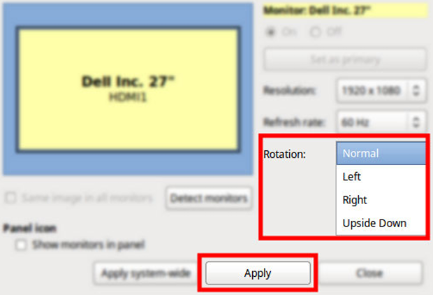

Change the Screen Orientation
A vertical orientation for 1920 × 1080 monitors is supported in PathPilot v2.10.0 and later. For more information on the portrait layout, go to "About Portrait Screen Layout" (page 16).
Figure 19: Layout drop-down menu on the Settings tab.
Figure 20: Monitor configuration dialog box.
Figure 21: Tool Path window in portrait screen layout.
Figure 22: File tab G-code preview in portrait screen layout.

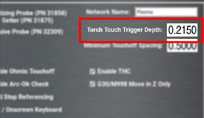

Set Torch Touch Trigger Depth
When using the physical touchoff switch for material height sensing, there's a certain amount of lost motion in the Z-axis between when the torch head touches the material and when the micro-switch in the torch lifter triggers.
It's important to set an accurate value for the distance between torch touch and touch switch triggering so that the initial pierce height can be correctly computed.

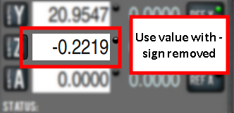

To set torch touch trigger depth:
  1. Power on the machine and reference all axes.
  2. From the PathPilot interface, on the Settings tab, disable Ohmic Touchoff.
  3. Put a piece of material on the machine table and position the torch above it.
  4. Using a slow jog speed (~5 IPM), jog the torch down until it's just contacting the material.
  5. Zero your Z-axis at this position.

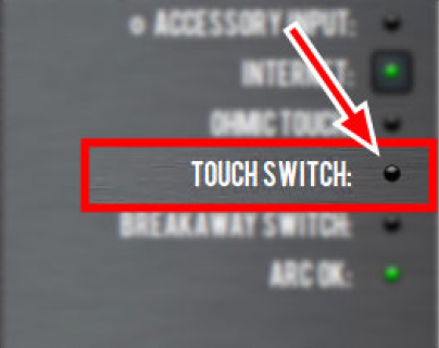

  1. Switch to the Status tab and watch the Touch Switch LED. Very slowly, jog downwards until the LED comes on.
  1. Note the value in the Z DRO field. This is your Torch Touch Trigger Depth. Convert this value to a positive number and enter it on the Settings tab.
  1. Re-enable Ohmic Touchoff on the Settings page.

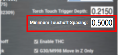

Set Minimum Touchoff Spacing
Minimum touchoff spacing is a time saving setting designed to avoid unnecessary probing during programs with a large number of individual cuts.
After the machine has probed for initial cut height, if the next cut begins within this distance it will be assumed that the material height is the same. This allows the machine to skip the probing routine and proceed straight to pierce height.
If your material is very flat and uniform, you can use a large distance for this setting (>2 in.). If your material is uneven or you would simply prefer to probe for height every time a cut begins, enter zero for this value.

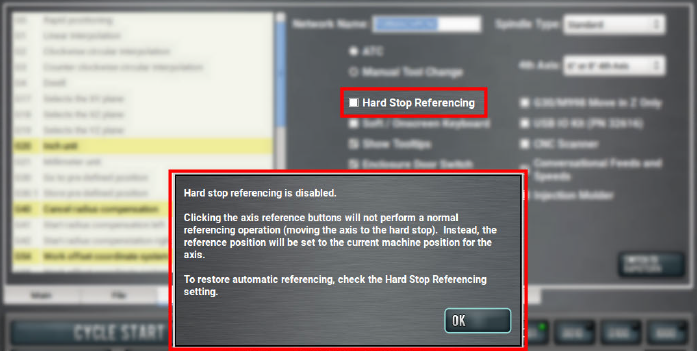

Disable Hard Stop Referencing
To provide a temporary workaround for a malfunctioning limit switch circuit, you can disable the limit switches.
NOTE: By default, the Hard Stop Referencing checkbox is selected.
To disable :
  1. From the Settings tab, clear the Hard Stop Referencing checkbox.
Figure 23: Hard Stop Referencing checkbox on the Status tab.
  1. Select OK.

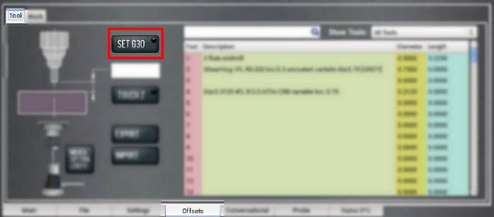

Limit G30 Moves
To limit G30 moves:
Figure 24: Settings tab.
About G30

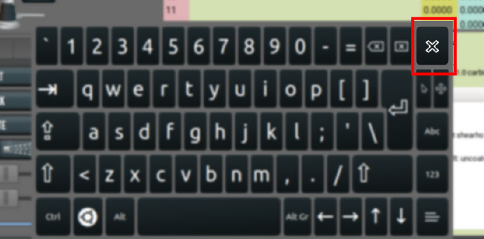

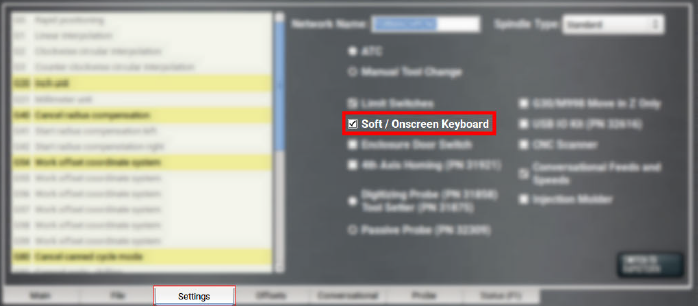

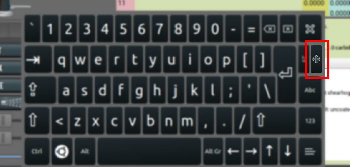

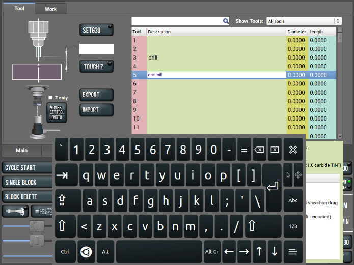

Enable the On-Screen Keyboard
If you have an (optional) Touch Screen Kit (PN 35575), you can use a soft keyboard to type information in the PathPilot interface. For information, see "About Soft Keyboards" (page 23).
Figure 25: Settings tab.
Figure 26: Soft (on-screen) keyboard.
Figure 27: Settings tab.

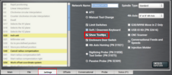

Enable Tooltips
Figure 28: Show Tooltips checkbox.

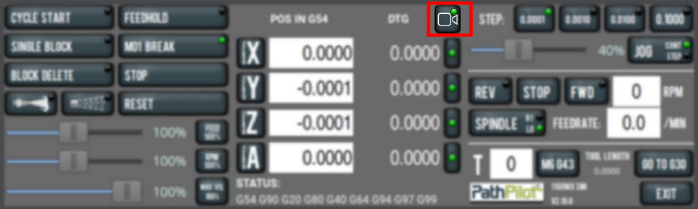

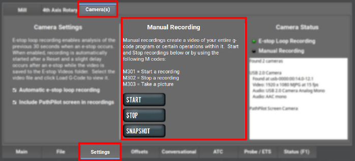

Use a USB Camera
Figure 29: USB camera status.
About USB Cameras

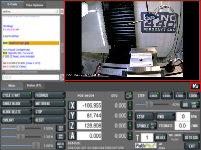

Manual Recording
Figure 30: Manual recording controls.
Figure 31: Video Camera Recording button.
Figure 32: Camera settings.
    The Main tab displays.
Figure 33: Example of taking a photo.

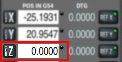

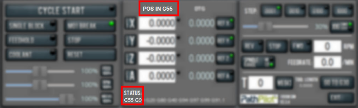

Set Work Offsets
  • Select Zero [Axis].
Figure 34: Work Offset DRO fields.
To change work offsets:
Figure 35: Work offset indicated in the PathPilot interface.

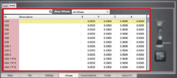

View Work Offsets
Figure 36: Work Offsets Table window.

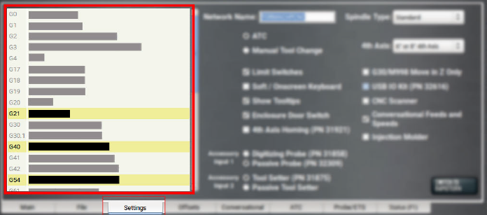

View Available G-Code Modes
Figure 37: G-code Description window on the Settings tab.

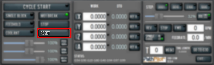

Run G-Code Programs
  • Select Reset.
Figure 38: Reset button.
About Reset Mode
  • Clears alarms

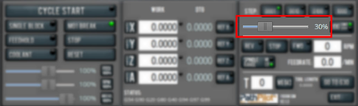

To set the velocity:
  • Drag the Jog Speed slider.
Figure 44: Jog Speed slider.

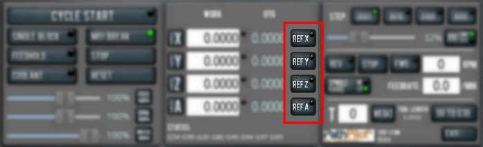

Reference the Machine
Figure 47: Reference buttons.
About Referencing
  • Before using MDI commands

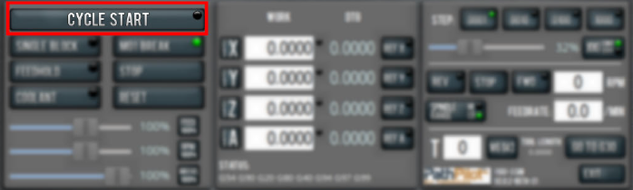

Start a Program
Figure 48: Cycle Start button.
About Cycle Start
  • Single block
  • Feed hold
  • M01 break
Cycle Start Reference
  • While you're not in the Main tab. For information, see “Main Tab” Reference.
  • Before referencing the machine. For information, see "Reference the Machine".

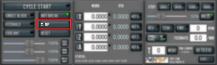

Stop Machine Motion
Figure 49: Stop button.

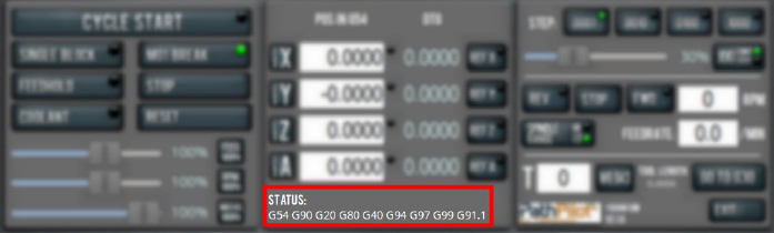

View the Active G-Code Modes

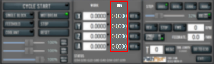

Figure 50: Status read-only DRO field.
View the Distance to Go
To view the distance to go:
Figure 51: DTG read-only DRO fields.

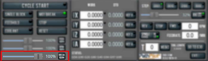

Figure 55: Maxvel Override slider.
  • Select Maxvel 100%.
About Maxvel Override

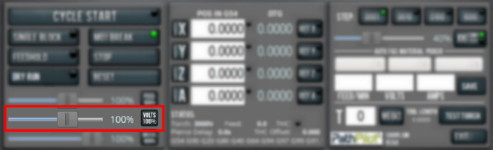

Use the Voltage Override Function
To use the voltage override function:
  • Using the Voltage Override slider, change the programmed voltage by a specific percentage.
Figure 57: Voltage Override slider.
To remove the voltage override function:
  • Select Volts 100%.
    The voltage returns to 100% of its programmed value (it's no longer overridden).

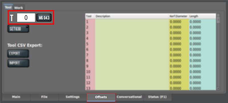

Change the Tool Number
The Tool DRO field shows the tool number currently active.
Figure 58: Tool DRO field.
  1. In the Tool DRO field under the Offsets tab, type a number (the valid range is from 0-1000). Then select the Enter key.
NOTE: You can also select M6 G43. For information, see "About M6 G43".
About M6 G43
Use a G30 Position
To set a G30 position:
Figure 59: Set G30 button.
To go to a set G30 position:
  • Use a G30 command in a G-code program or in the MDI Line DRO
About G30

Admin Network
Configure a Wi-Fi network.

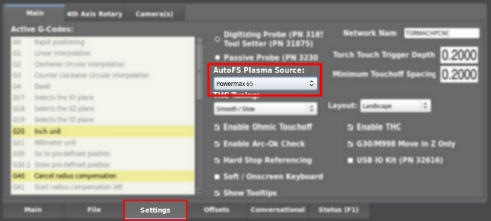

  1. On the Settings tab, select which plasma source you're using from the Auto FS Plasma Source drop-down menu.

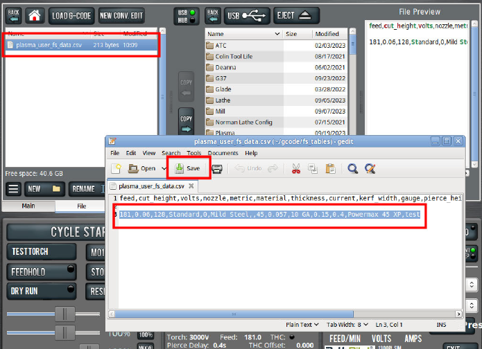

Deleting Custom AutoFS Presets
  1. From the File tab, navigate to the fs_tables folder, and open the plasma_user_fs_data.csv file.
  2. Highlight the line of the preset you want to delete and delete it. Then, save the file.
NOTE: This file is read on boot only, so the preset remains visible until the controller is power cycled.

System File Management
Manage System Files
Use the File tab to manage system files on the PathPilot controller. For information, see "Transfer Files to and From the Controller".
To manage system files:
    • Select a file, and go to the Options menu. Then, select Copy, Cut, or Paste.
  • Select Back or Home.

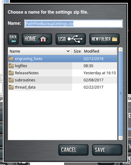

Create Backup Files
Figure 61: Admin Settings Backup dialog box.
  2. Select Save.
Figure 62: Controller Files window on the File tab.
  • logfiles
  • media
  • ReleaseNotes
  • subroutines
  • USB
  1. Select Copy to USB.
About Backup Files

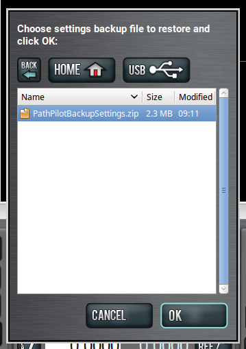

Restore Backup Files
Figure 63: Admin Settings Restore dialog box.
Figure 64: USB Files window on the File tab.
  2. Select Copy From USB.

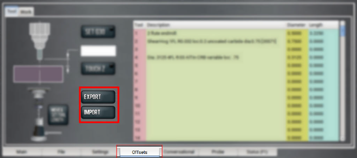

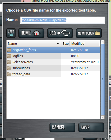

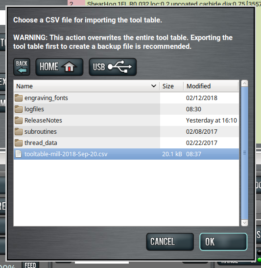

Figure 65: Export and Import buttons on the Offsets tab.
Import a .csv File
Figure 66: Import dialog box.
Figure 67: Export dialog box.
  2. Select Save.
  4. Select Eject.
