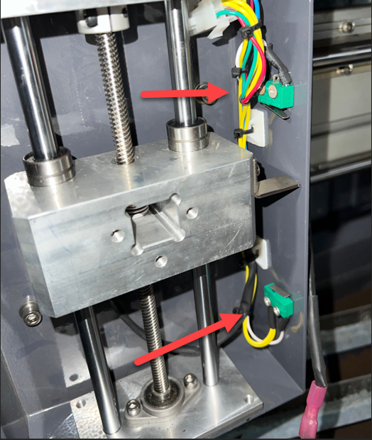

Inspect the Z Limit Switch and Harness
  1. To check the condition of the 1300PL Z-axis Limit Switches, you will need to remove the torch head, and torch mount, and torch mount plate.
  2. In the event that there is a damaged limit switch, the entire harness will need to be replaced. That process can be found here: Z-Axis Limit Switch Harness Replacement
87c6f87f-f48c-478c-835f-49053f5957bf#media-blob-url=true&id=adc686f6-72d4-42f5-b8cc-5fcdd24a6eb8&contextId=3328639054&collection=contentId-2849865757
Upper and Lower Z Limit Switches
