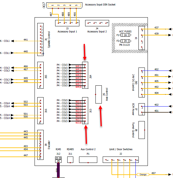

  2. Examine the data cables at the machine control board and the servos/motor removing then re-connecting them to ensure they are seated.
    1. Machine control board: Degson style (X and Y) and 26 pin IDC (Z ribbon cable)
      1. (J13) (X-axis)
      2. (J14) (Y-axis)
      3. (J6) (Z-axis)
    2. Servos: Molex style
    3. Stepper driver controller: 10 pin IDC (ribbon cable)
1300PL ECM Board

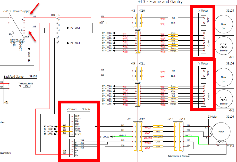

  1. Examine the power cables at the DC Power supply and the servos/motor removing then re-connecting them to ensure they are seated.
    1. DC Power Supply:
      1. 225/226 (X-, Y-, and Z-axis)
    3. Stepper: Degson style
      1. 209, 210, 211, 212, 225, and 226 (Z-axis)

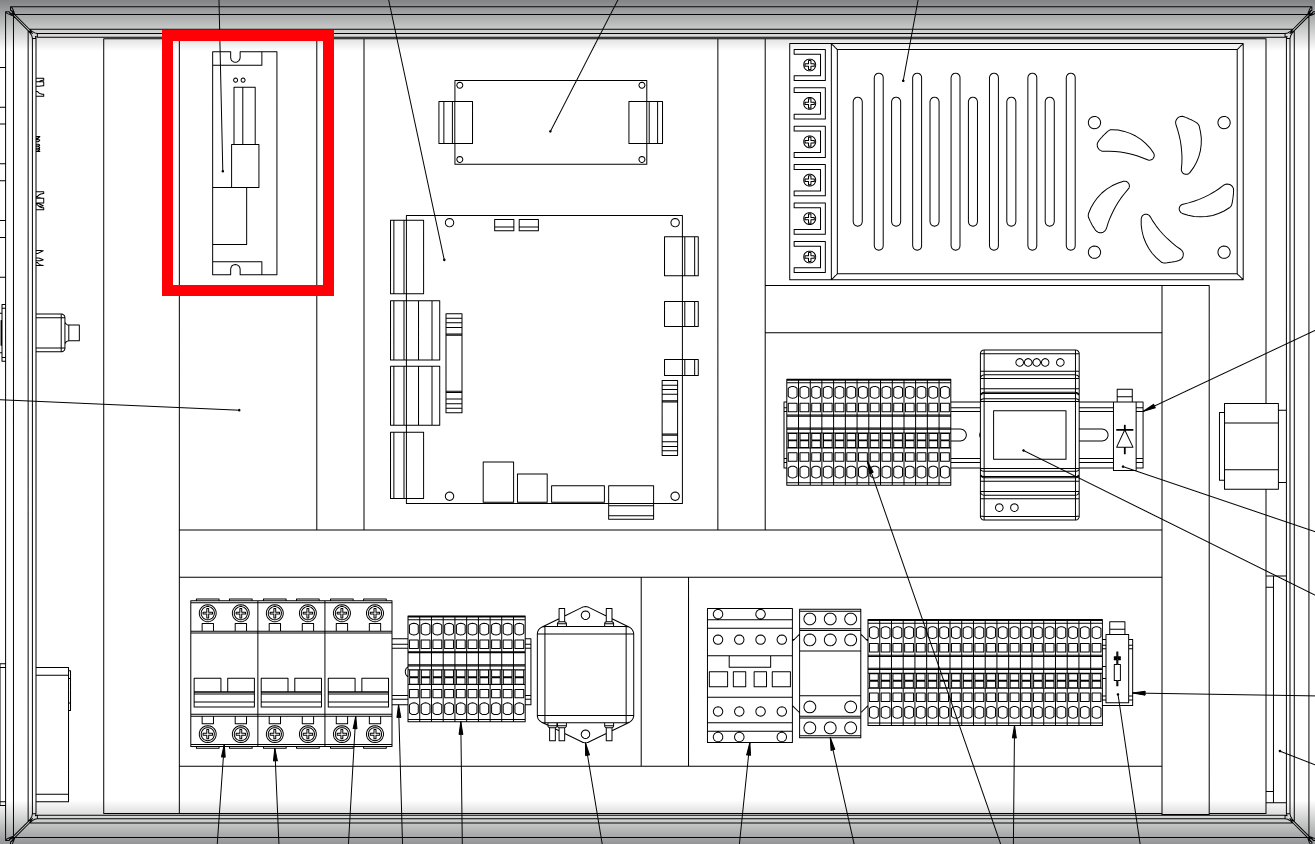

Inspect the Z Motor Driver
Assess the state of the motor or stepper driver controller
Reason: There's a defective or malfunctioning axis driver/cable.
Z Driver Location
Inspect the DC Power Supply
Reason: The DC Power Supply is faulty.
  1. Inspect the DC power supply for power by examining if the green power light is illuminated.
    1. If it does: The stepper driver controllers or motors will be illuminated.
    2. If it doesn’t: Go to All Axes Won't Move When Commanded - 1300PL .

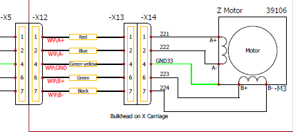

  3. With machine power still off, remove the Z stepper motor power plug from the X gantry bulkhead. Identify Pin 1, 2, 6, and 7.
a. Measure the resistance between 221-222 and 223-224.
  1. You should ideally see between 0.5-2.0 Ω.
    2. If the resistance is within spec: Then inspect the cable and connectors between the axis motor and axis driver. This includes measuring resistance from the X gantry bulkhead all the way to the Z axis driver.

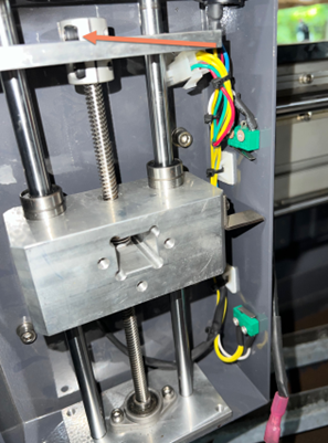

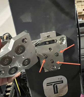

Inspect the motor coupling
  2. Remove the cover plate over the coupling and make witness marks across the coupling and lead screw.
Remove these three screws to access the lead screw assembly.
  1. Jog the axis to determine if the motor's turning but the screw isn't.
Lead Screw and Motor Coupler
