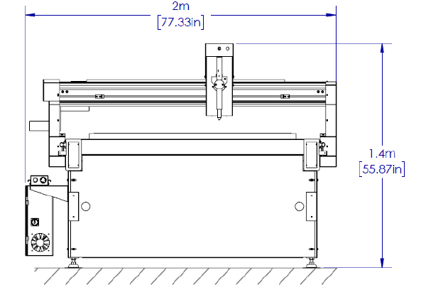

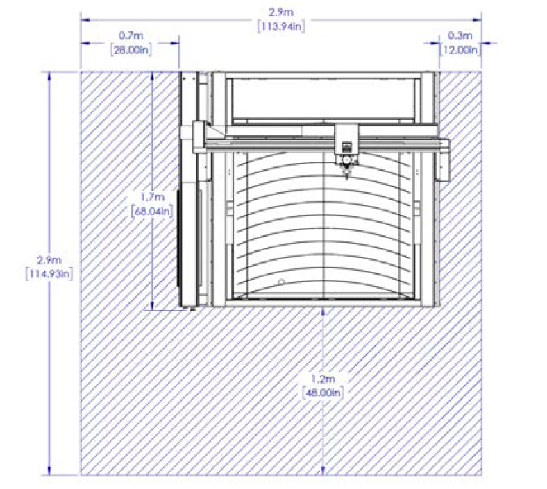

Space Requirements
The area must meet the following space requirements. Allow more space to access the rear of the machine for maintenance and repairs.
  • Machine Size 78" × 70" (1.95 m x 1.7 m)
  • Machine Height 55" (1.4 m)
  • Typical System Footprint 89" × 67" (2.3 m × 1.7 m)
Figure 1: Dimensions of the machine and it's required added space, as viewed from above.
