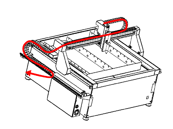

  1. Install the cable retention loop into the base plate.

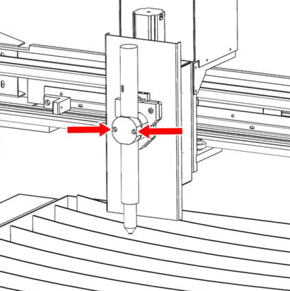

  1. Using the manufacturer's instructions, install the torch consumables.
  2. Install the plasma torch into the breakaway torch holder using the two socket head screws. Only tighten these screws enough to securely hold the torch, do not overtighten.
Tip! We recommend positioning the torch nose about 1" below the Z-axis cover plate to start.

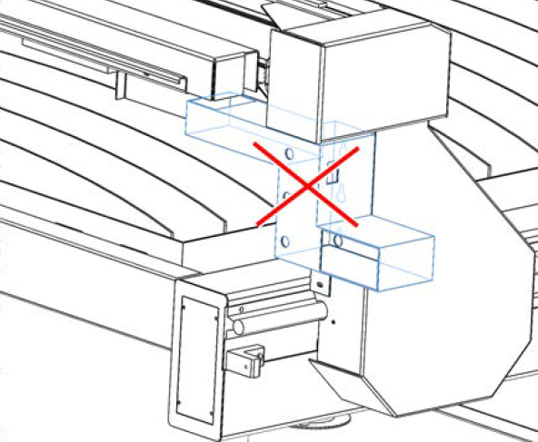

  2. Install plasma torch lead into the cable guard from the X carriage to the electrical cabinet and pass it through the rectangular access hole to bottom of track.
NOTE: Do not try to pass the torch lead through the stepped section between the Y and X axis cable guards. Simply run the torch lead along the outside.
