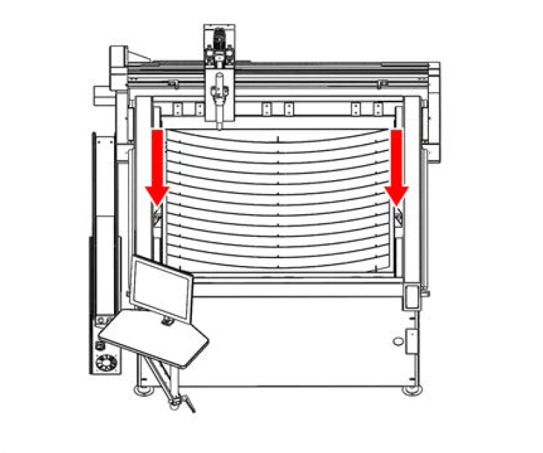

  1. Ensure that the drain valve on the bottom of the water table is in the closed position.
  2. Check that the two lock bolts that hold the table in place on the front-to-back tracks are in place.
  1. Using a hose or buckets, fill the table with tap water until the level is about 1" below the top of the slats.
  2. Add cutting fluid to the water to inhibit corrosion. Use the ratio recommended by the cutting fluid manufacturer. For reference, full water table capacity on the 1300PL is 59 US gallons (223 liters).
  3. Top the water table off to 0.5" below the top of the slats after adding cutting fluid if desired.
