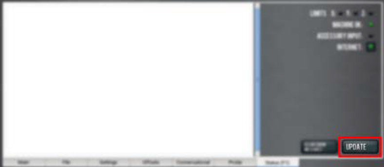

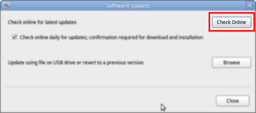

Update PathPilot

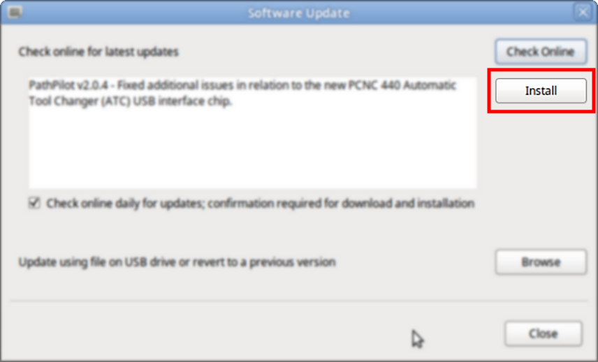

  1. Select Install.
Figure 3: Install button on the Software Update dialog box
