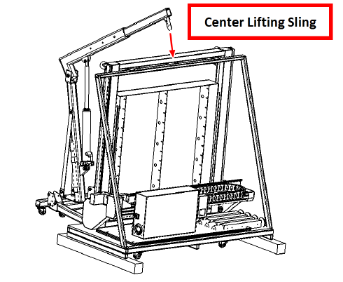

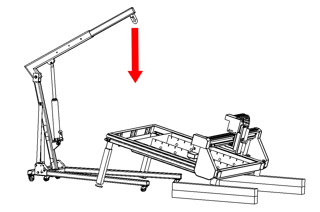

Lifting Frame

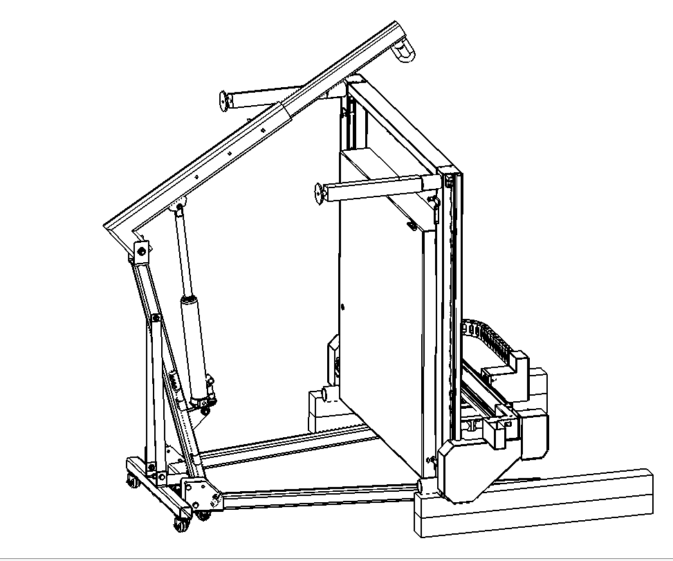

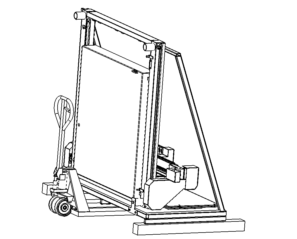

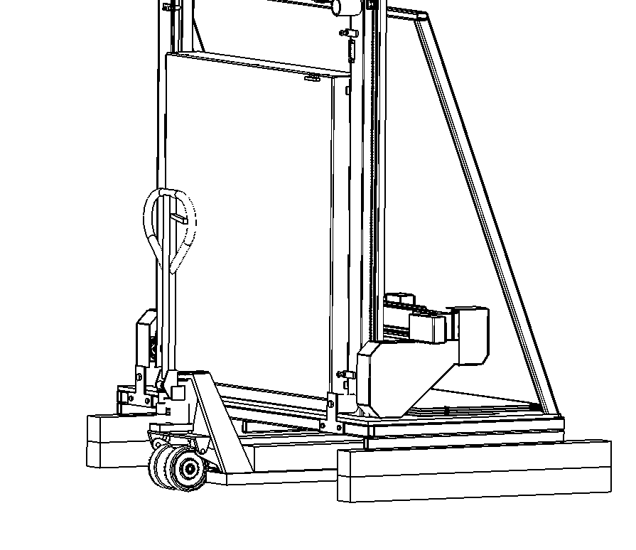

  1. If using an engine hoist, perform the following steps to lift the crate for clearance underneath. If using a forklift or gantry, proceed to the next step.
    1. Position a pallet jack under the machine and lift high enough to place a 4x4 under the side supports.
    2. Place two 4x4 pieces on the pallet jack legs and repeat the lift. Place another 4x4 under the side supports.
    3. Repeat the above steps until the crate clears the front legs of your engine hoist.
  2. Attach a sling to the top frame rail of the plasma. Make sure the sling is positioned securely between two of the raised accessory mounting pads to prevent side-to-side slippage of the frame.
WARNING! Make sure that the lifting device you are using is rated for the weight of the machine frame - 825 lb (375 kg).

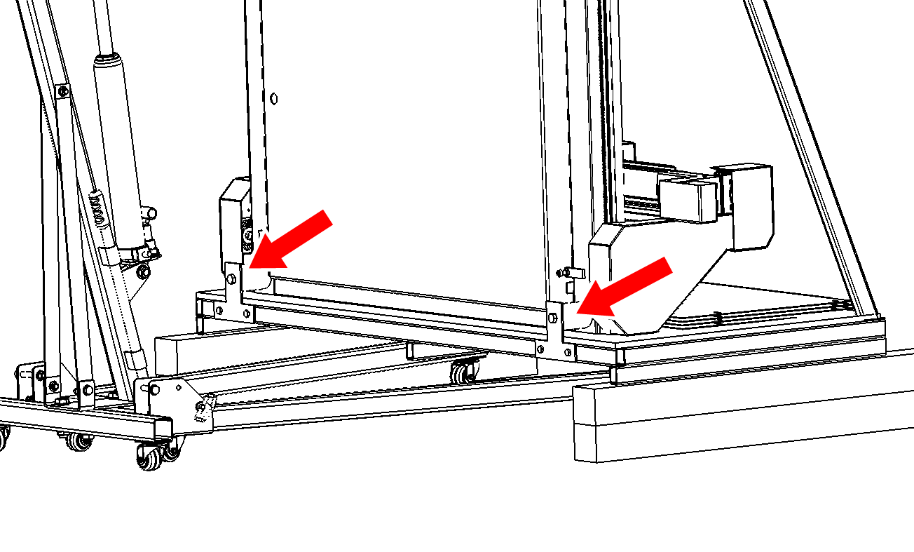

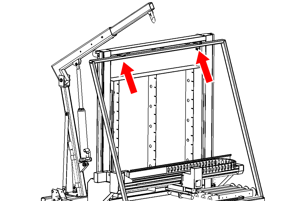

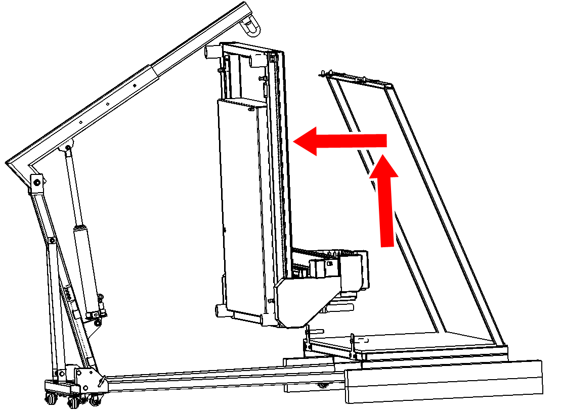

  1. Position your engine hoist, crane or forklift above the sling and put light tension on it, just enough to hold the frame upright when it is released.
  2. Remove the top two bolts holding the A-frame support of the crate to the machine frame.
  3. Remove the two bottom bolts connecting the crate frame to the machine leg mounting pockets.
  4. Use your lifting device to put enough upwards pressure on the machine that it will be fully supported. Use a pry bar to push the lower leg mounting pockets off of the crate mounting bosses.
  5. Lift the machine frame enough to clear the crate and use a pallet jack to remove the crate from the area.

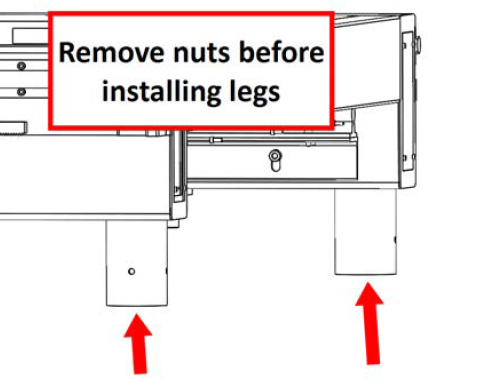

Installing Legs and Righting Machine

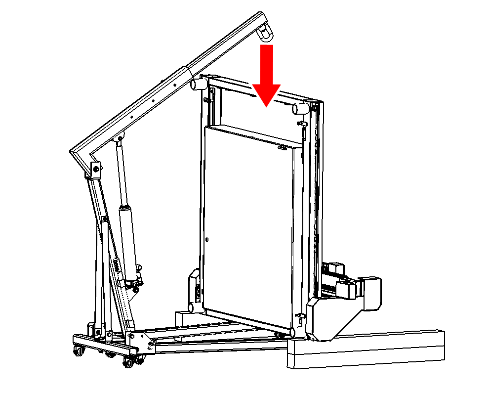

  1. Lower the bottom end of the frame down on to 4x4 blocks to protect the paint and clear the engine hoist legs (if present).
  2. Install the top two legs on the machine on the end supported by the lifting sling.
  3. Using gantry crane, slowly lower the top side of the machine frame until the two legs are on the ground.
  4. Move the lifting sling to the same position on the opposite end of the frame.
  5. Lift the remaining end of the frame off of the 4x4 blocks.
  6. Remove the two nuts (used to bolt to the crate frame) from inside the leg mounting holes. Do not discard the socket head cap screws attaching the nuts, these are used to attach the last two legs.
  1. Install the last two legs.
