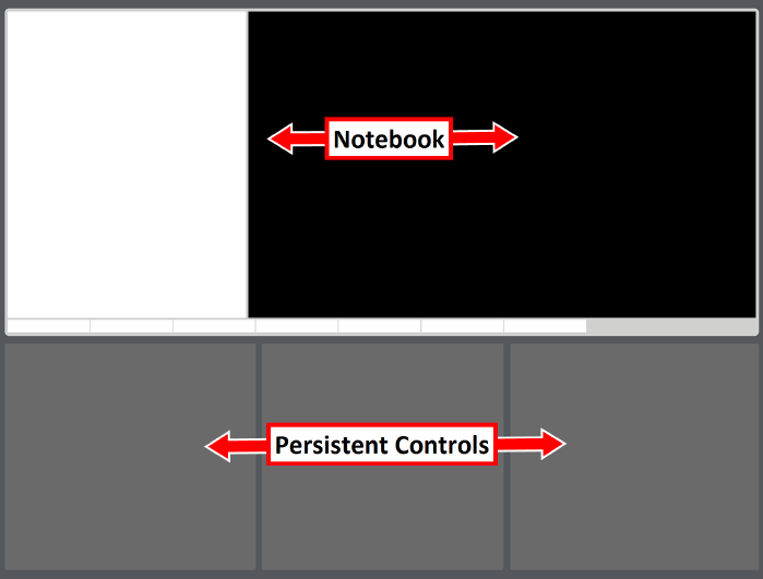

About PathPilot

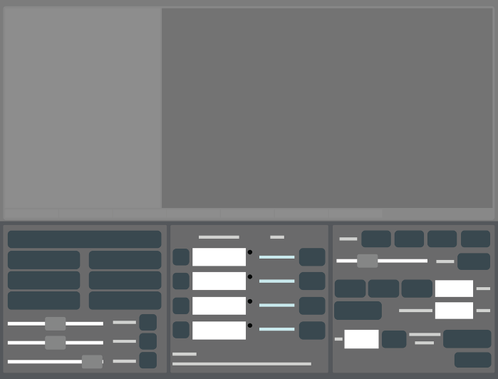

Notebook Section

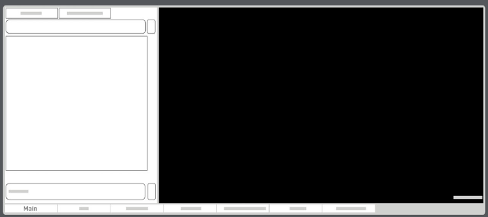

Main Tab
Access G-code files that are already loaded into PathPilot, and open or close them.
For information, see “Create and Load G-Code Files ”. -
Send G-code commands directly to the machine using the Manual Data Input (MDI) Line DRO field.
For information, see “Manually Enter Commands ”. -
In a G-code program, do tasks like finding specific terms in the code, reading the code, or viewing the generated tool path.
For information, see “Read G-Code ”.

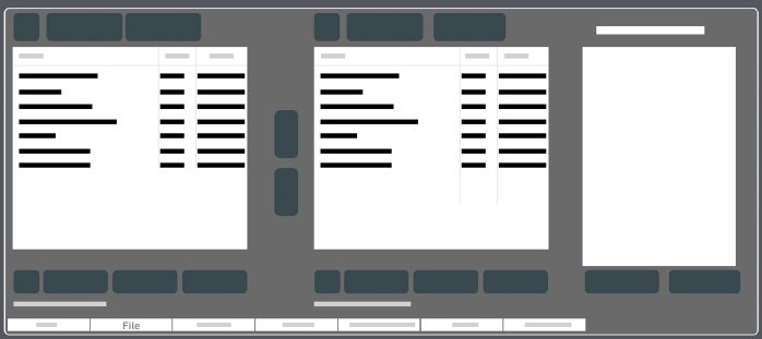

File Tab
Transfer G-code files into the PathPilot controller.
For information, see “Load G-Code ”. -
Edit G-code files.
For information, see “Edit G-Code with a Text Editor ”. -
Load .nc files into PathPilot to run a program.
Move files within the system.
For information, see “Load G-Code ”; “ Manage System Files ”.

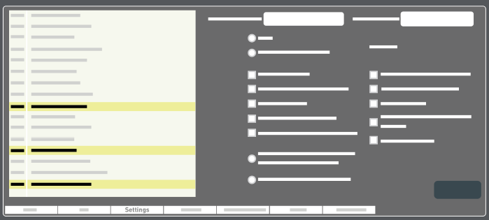

Settings Tab
Change the network name with which you're using PathPilot.
For information, see “Change the Network Name ”. -
Change the screen's layout orientation (landscape or portrait).
For information, see “Change the Screen Orientation ”. -
Configure PathPilot for the accessories you're using.
For information, see “Enable the On-Screen Keyboard ”; “ Enable the USB M-Code I/O Interface Kit ”; “ Use a USB Camera ”. -
Disable the limit switches for troubleshooting.
For information, see “Disable Hard Stop Referencing ”. -
Specify the way in which you want to use a G30 move.
For information, see “Limit a G30 Move ”. -
Identify the available G-code modes that you can use.
For information, see “View Available G-Code Modes ”. -
Adjust plasma settings.
For information, see “Set Torch Touch Trigger Depth ”; “ Set Minimum Touchoff Spacing ”; “ Enable Ohmic Touchoff ”; “ Enable Torch Height Control ”; “ Enable Arc-Ok Checking ”.

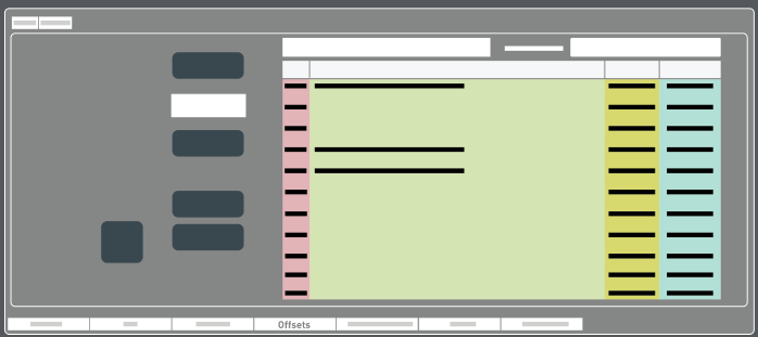

Offsets Tab
Make and restore backup files of your settings.
For information, see “Create Backup Files ”; “ Restore Backup Files ”. -
Import and export .csv files of your tool table.
For information, see “Import and Export the Tool Table ”. -
Preset a G30 position.
For information, see “Use a G30 Position ”. -
Read the currently programmed work offsets.
For information, see “View Work Offsets ”.

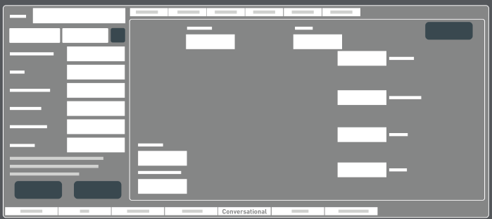

Conversational Tab
Import a .dxf file.
For information, see “Import a DXF File ”.

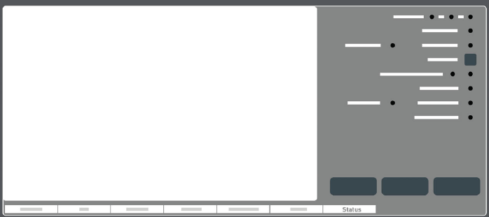

Status Tab
View diagnostic machine information.
Read error messages.
Configure your internet connection.
For information, see “Enable an Internet Connection (Optional) ”. -
Update or install a previous version of PathPilot.
For information, see "Manage PathPilot Versions ".

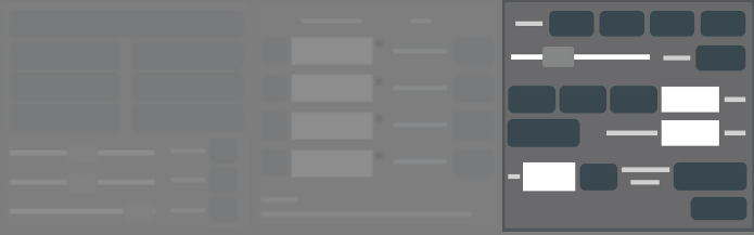

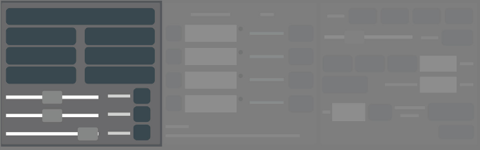

Persistent Controls
Program Control Area
Reset the machine.
For information, see “Bring the Machine Out of Reset ”. -
Start, stop, or pause a G-code program.
For information, see “Start a Program ”; “ Stop Machine Motion ”; “ Use the Feed Hold Function ”. -
Use overrides to change the feed rate, voltage, and maximum velocity.
For information, see “Use the Feed Rate Override Function ”; “ Use the Maxvel Override Function ”; “ Use the Voltage Override Function ”. -
Manually control a G-code program.
For information, see “Use M01 Break Mode ”; “ Use Single Block Mode ”.

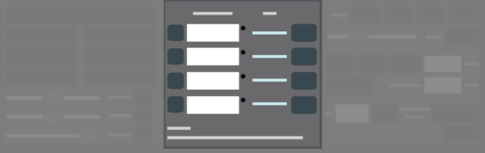

Position Status Area
Reference the machine axes.
For information, see “Reference the Machine ”. -
Create work offsets.
For information, see “Set Work Offsets ”. -
Understand how you're jogging the machine.
For information, see “View the Active Axis to Jog ”; “ View the Current Machine Position ”; “ View the Distance to Go ”. -
Quickly determine which G-code modes are active.
For information, see “View the Active G-Code Modes ”.
Manual Control Area
Move the machine axes.
For information, see “Jog the Machine ”. -
Use automatic look-up tables to find feed rate, amperage, pierce parameters, and torch height control voltage for the material you're cutting.
For information, see “Use the AutoFS Material Picker ”.

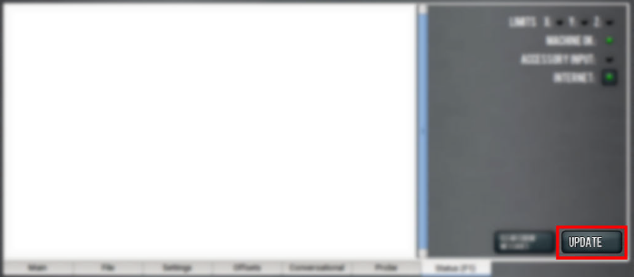

Confirm that the PathPilot controller is powered on and out of Reset mode.

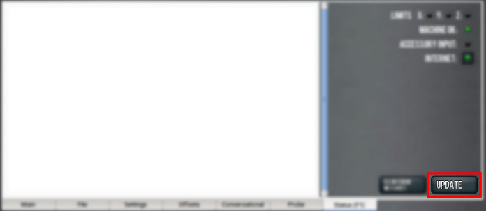

Downloading and installing an update file requires an Internet connection. From the Status tab, confirm that the Internet button LED light is on. (To configure the network, select the LED light.) Then, select Update.

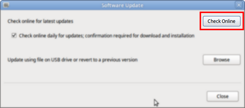

From the Software Update dialog box, select Check Online.

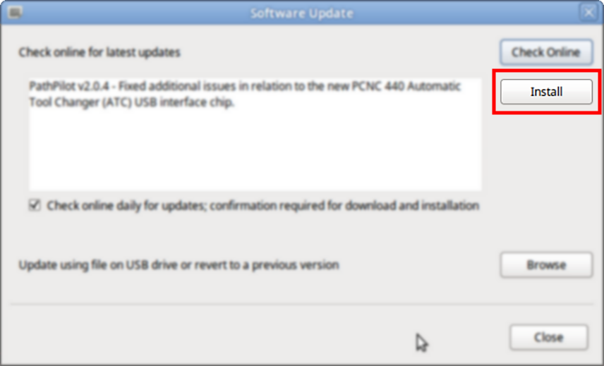

Select Install.
From the dialog box, select OK.
The update file is installed on the PathPilot controller. -

From the Status tab, select Update.

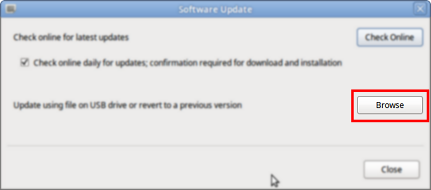

From the Software Update dialog box, select Browse.

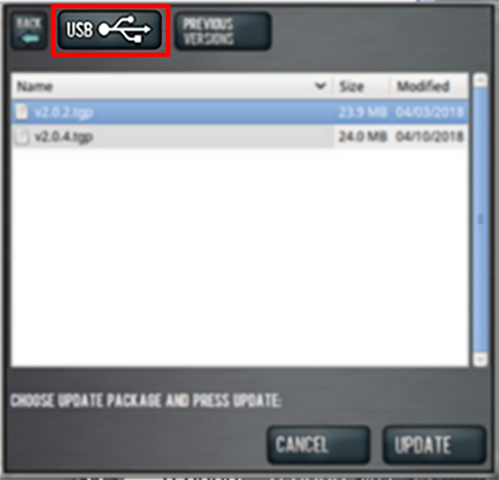

From the Browse dialog box, select USB.
Select the desired update file, and then select Update.

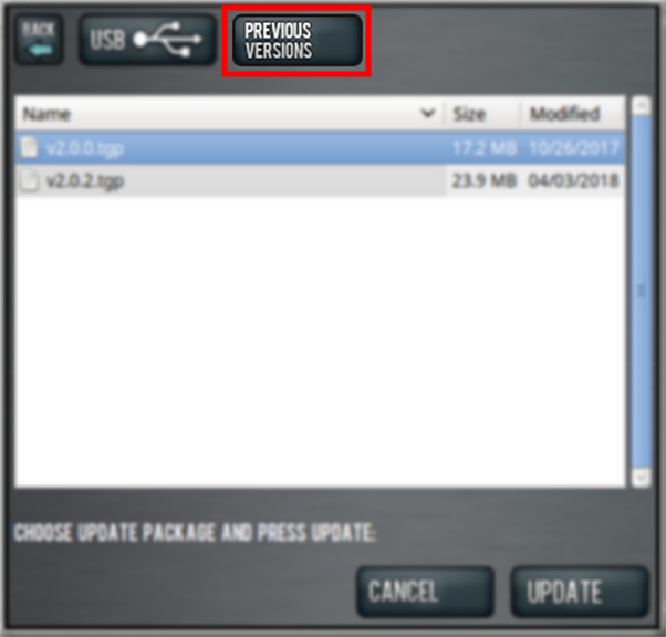

From the Browse dialog box, select Previous Versions.
Follow the on-screen instructions to restart the PathPilot controller.
