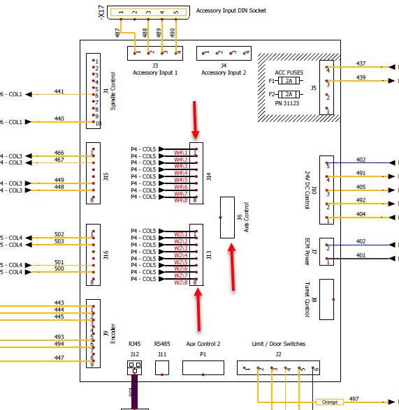

  3. Examine the data cables at the machine control board and the servos/motor removing then re-connecting them to ensure they are seated.
    1. Machine control board: Degson style (X and Y) and 26 pin IDC (Z ribbon cable)
      1. (J13) (X-axis)
      2. (J14) (Y-axis)
      3. (J6) (Z-axis)
    2. Servos: Molex style
    3. Stepper driver controller: 10 pin IDC (ribbon cable)
1300PL ECM Board

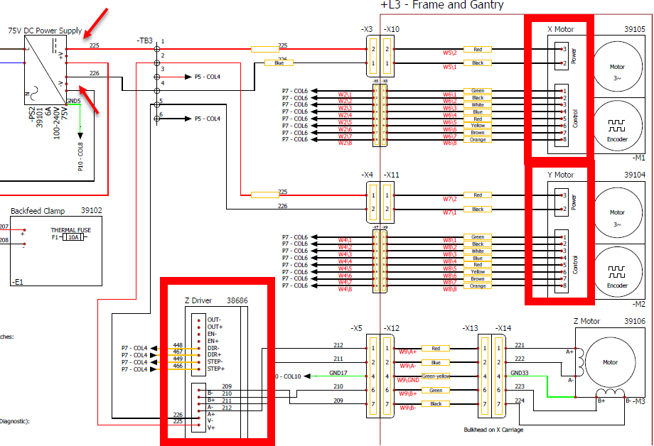

  1. Examine the power cables at the DC Power supply and the servos/motor removing then re-connecting them to ensure they are seated.
    1. DC Power Supply:
      1. 225/226 (X-, Y-, and Z-axis)
    3. Stepper: Degson style
      1. 209, 210, 211, 212, 225, and 226 (Z-axis)

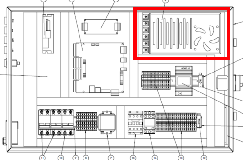

Inspect the DC Power Supply
Reason: The DC power supply is malfunctioning.
  1. Inspect the DC power supply for power by determining if the green power light is illuminated.
    1. If it does: The stepper driver controllers will be illuminated.
  2. Ensure the machine is powered on the machine and measure the Vac entering the DC power supply on:
    1. 116/N
    2. 115
75v Supply Location

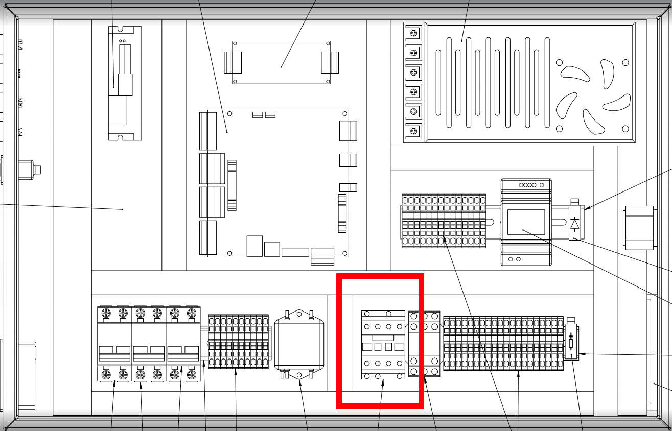

Check the K2 Contactor
Reason: The K2 is defective.
  2. Inspect the K2 to see if the center bar has been pulled in.
    1. If bar is in: The K2 is latched. Using a digital multimeter set to Vac, measure for 220 Vac between:
      1. 116N
      2. 115
  3. Press and hold the Reset button on the operator box and observe the K2. Then release the Reset button and observe the K2.
    1. If the bar only stays in when the button is pressed: There is a loose coil wire, short, or the K2 has malfunctioned.
    2. If the bar never gets pulled in: Go back to the previous troubleshooting topics to ensure your machine is receiving power.
