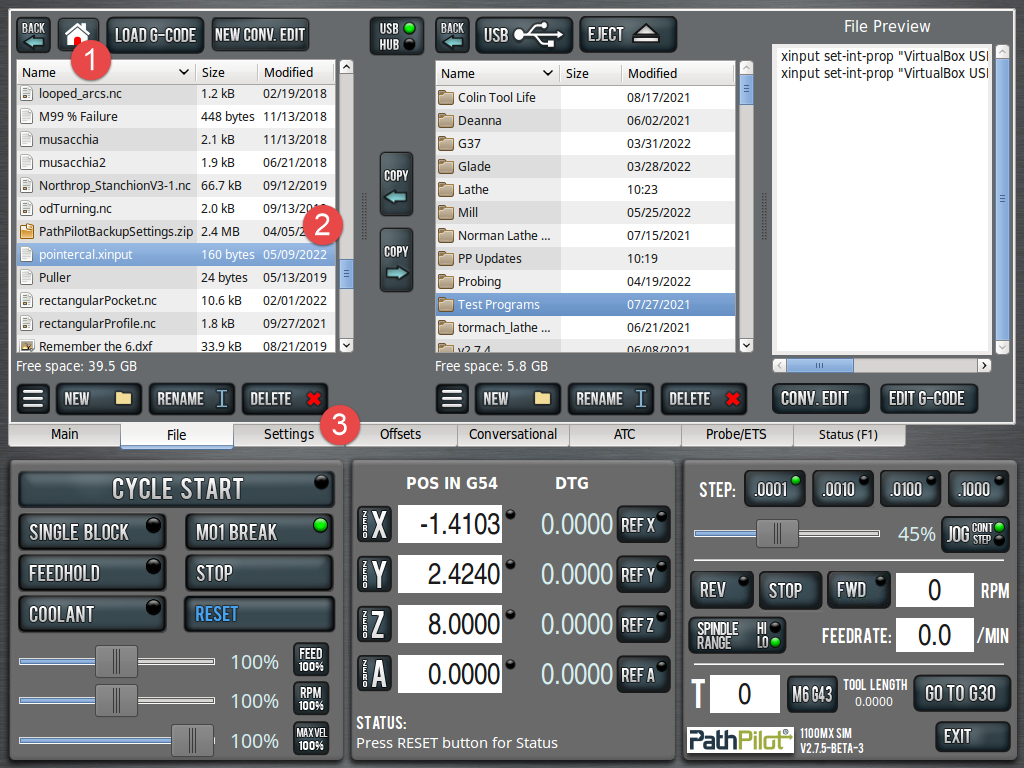

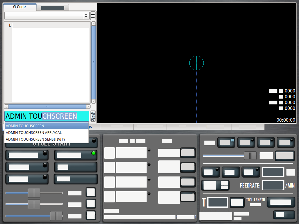

Touch Screen isn't Responding
Reseat the USB Cable (Touch screen only)
  3. Press the Delete button.
