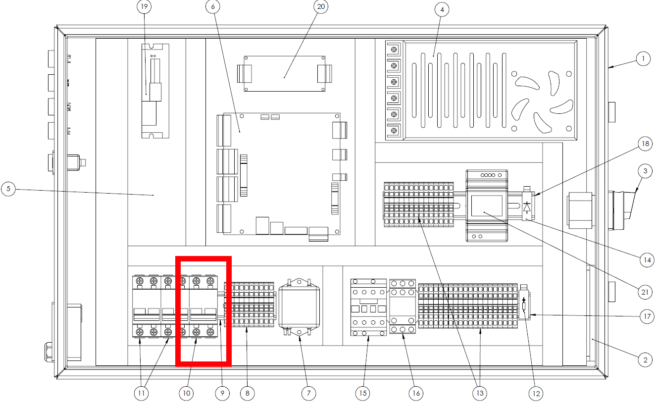

Restore Power to the Controller
  • If the monitor and the controller both have power:
    • Examine the power cables for damage or exposed wires and replace if needed.
    • Reset the CB2 circuit break.
Location of CB2 in 1300PL Electrical Cabinet.
