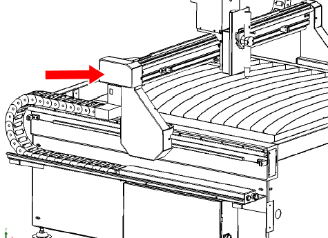

  1. Remove the motor belt cover over the servo motor pulley.

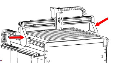

  1. Remove the belt covers from both sides of the gantry.

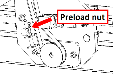

  1. Adjust the preload nut on the pinion mount assembly until the spring is compressed approximately 1/4" (6 mm) from its fully slack position.

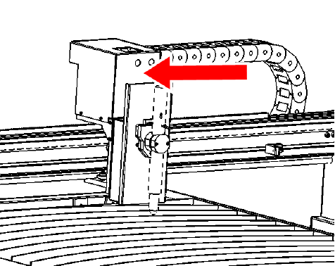

  1. Remove the motor cover on the X-axis carriage.

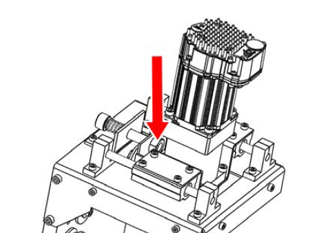

  1. Locate and tighten the preload nut for the X motor assembly until the spring is compressed approximately 1/4" (6 mm) from its fully slack position.
  1. Reinstall all belt covers and guards.
