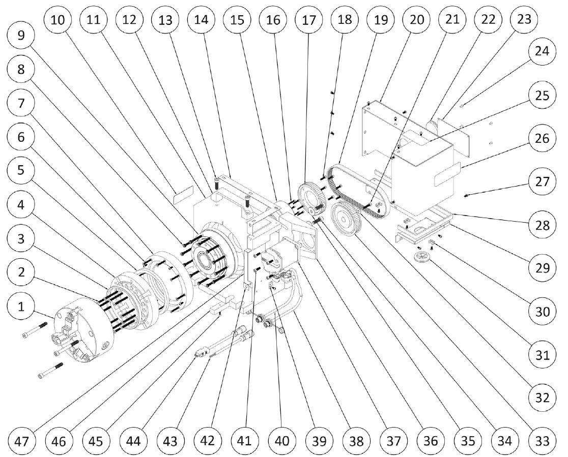

microARC 6 Assembly - 1500MX
Alternative Part Numbers
3-Jaw Chuck, microARC 6 (PN 51822)
Screw, Flat Head Cap, M5 × 0.8 - 50, 18-8 Stainless
McMaster-Carr: 92125A228
12
Pilot Ring, microARC 6 (PN 51826)
Face Plate, microARC 6 (PN 51825)
Shaft Seal, microARC 6 (PN 51828)
Screw, Flat Head Cap, M4 × 0.7 - 30, 18-8 Stainless
McMaster-Carr: 92125A203
Rotary Shaft Seal, microARC 6 (PN 51827)
Screw, Socket Head Cap, M5 × 0.8 - 40, 18-8 Stainless
McMaster-Carr: 91292A194
12
Harmonic Gearbox, 80 mm Trade Size, 50:1 Ratio (PN 51829)
Resin Decal, microARC6, Left View, 28 × 75 mm (PN 52494)
11
Body Casting, microARC 6 (PN 51819)
12
Grab Handle, 140 mm OAL × 41 mm Height (PN 51831)
13
Screw, Socket Head Cap, M8 × 1.25 - 25, 18-8 Stainless
McMaster-Carr: 91292A148
14
Pulley Cover Gasket 1, 1 mm, Neoprene, microARC 6 (PN 52924)
15
Pulley Connector, microARC 6 (PN 51830)
16
Screw, Socket Head Cap, M3 × 0.5 - 20, 18-8 Stainless
McMaster-Carr: 91292A123
17
Gearbox Pulley, microARC 6 (PN 51834)
18
Screw, Socket Head Cap, M4 × 0.7 - 16, 18-8 Stainless
McMaster-Carr: 91292A118
19
Timing Belt, S5M, 565 mm Length, 15 mm Width (PN 51835)
20
Pulley Cover 1, microARC 6 (PN 51820)
21
Screw, Socket Head Cap, M5 × 0.8 - 25, 18-8 Stainless
McMaster-Carr: 91292A129
22
Closed Hole Grommet, 35 × 40 mm × 3 mm, Rubber (PN 52910)
23
Tormach Steel Part Number Plate, microARC 6 (PN 52493)
24
Rivet Aluminum, 1/8 in. × 3/8 in. (PN 52731)
25
Resin Decal, microARC6, Top View, 32 × 77 mm (PN 52496)
26
Resin Decal, microARC6, Right View, 37 × 100 mm (PN 52495)
27
Screw, Button Head Cap, M4 × 0.7 - 8, 18-8 Stainless
McMaster-Carr: 92095A189
23
28
Lid Seal 1/2 in. × 1/8 in., MicroARC6 0.5 m (PN 52427)
0.5 m
29
Pulley Cover 2, microARC 6 (PN 51821)
30
Fastener, Cable Tie Mount, 9/16 in. × 3/8 in. (PN 52354)
31
Hole Grommet, 30 mm × 35 mm x 3 mm, Rubber microARC 6 (PN 51836)
32
Washer, Fender, 5.3 mm × 15 mm, 1.0-1.4 mm, 18-8 Stainless
McMaster-Carr: 91116A140
33
Motor Pulley, microARC 6 (PN 51833)
34
Screw, Socket Head Cap, M8 × 1 .25 - 25, 18-8 Stainless
35
Washer, Fender, 8.7 mm × 25.4 mm, 1.5 • 1.7 mm, 18·8 Stainless (PN 52937)
36
Motor Bracket, microARC 6 (PN 51832)
37
Servo Motor, 400 W, 220 V, 2.8 A, 3000 rpm, Oil Seal (PN 51196)
38
Power Cable, Inside Cabinet, microarc 6 (PN 53100)
39
Wire Tie Holder*
40
Encoder Cable, Inside Cabinet, microARC 6 (PN 53102)
41
Screw, Socket Head Cap, M5 × 0.8 - 16. 18-8 Stainless
McMaster-Carr: 91292A126
42
Pulley Cover Gasket 2, 1 mm, Neoprene, microARC 6 (PN 52925)
43
Power Cable, Outside Cabinet, microARC 6 (PN 53101)
44
Encoder Cable, Outside Cabinet, microARC 6 (PN 53103)
45
Screw, Flat Head Cap, M3 × 0.5 - 20, 18-8 Stainless
McMaster-Carr: 92125A136
46
T-Slot Alignment Key. microARC 6 (PN 51851)
47
Lid Seal 1/2 in. × 1/8 in., microARC6 (PN 52427)
0.14 m
