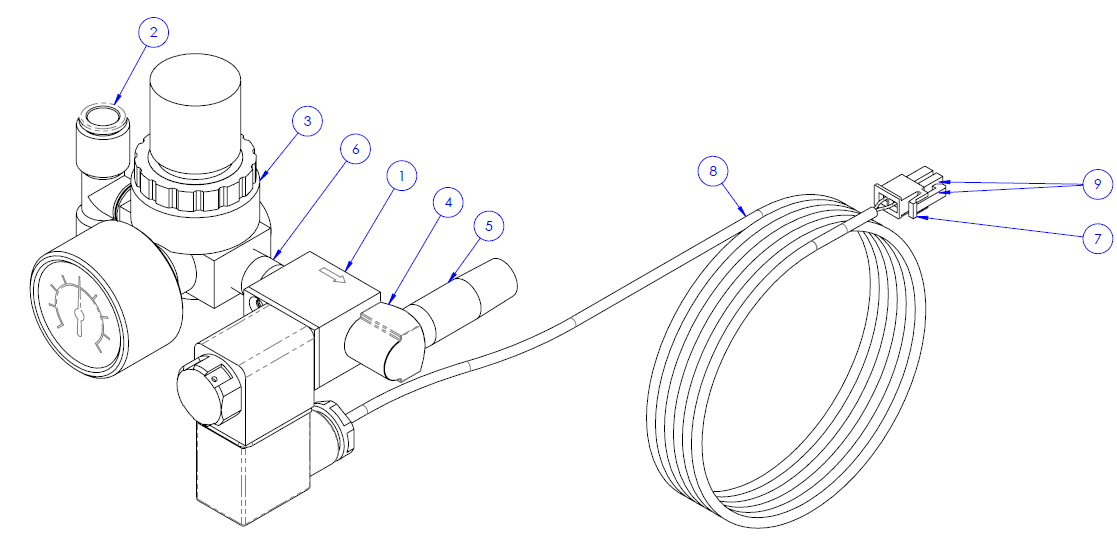

1500MX Knowledge Base
Alternative Part Number
Two Port, Two Way, Two Position, 24 Vdc, Single Solenoid Valve, 1/4 in. (Inlet/Outlet), Normally Closed (PN 38827)
Fitting, Branch Tee, 1/4 in. NPT (Male) - 3/8 in. PTC (PN 52399)
Pressure Regulator, 1/4 n. NPT × 1/4 in. NPT, 1/8 in. NPT Gauge
Port, 7-125 psi, 150 psi (PN 39356)
Fitting, Street Elbow, 1/4 in. NPT (Male) - 1/4 in. NPT (Female),
Brass
McMaster-Carr: 50785K431
Fitting, Pipe Nipple, 1/4 NPT × 2 in., Brass
McMaster-Carr: 2729K26
Fitting, Pipe Nipple, 1/4 NPT × 1.5 in., Brass
McMaster-Carr: 2729K21
Rectangular Connector, 2 Pin Female Dual Row, Receptacle, White
0.165 in. (4.2 mm) (PN 51663)
Cable, SJEOOW, 18/2 AWG, 300 Vac (PN 52404)
2 m
Crimp Terminal, Molex Mini-Fit Jr., Female, 18-24 AWG
(PN 52285)
Cable Tie, 4 in., Nylon, Black
McMaster-Carr: 7130K52
11
7 Tube, 3/8 in. OD, Polyurethane (Black)
McMaster-Carr: 5648K261
2 m
