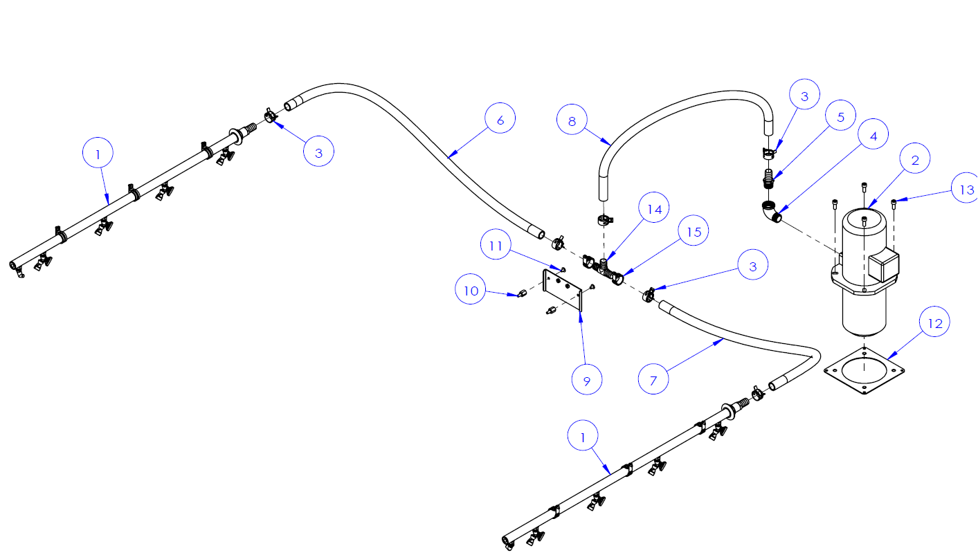

Alternative Part Number
Coolant Washdown Bar Assembly, 1500MX*
Coolant Pump, Dual Voltage (Preset to 240), 1/2 hp, 180 mm Length, 3/4 NPT Outlet, 2 m 14 AWG Cord (with Right-Angle C14 Plug) (PN 51385)
Hose Clamp, Spring, for 1 in. OD Hose
McMaster-Carr: 7329K16
Fitting, Street Elbow Adapter, 3/4 in. NPT (Male) - 3/4 in. NPT
(Female), Brass
McMaster-Carr: 4429K154
Fitting, Straight Adapter, 3/4 in. NPT (Male) - 3/4 in. Barb, Brass
McMaster-Carr: 5346K28
Hose, 3/4 in. ID × 1 in. OD, PVC, 1150 mm Long
McMaster-Carr: 5233K71
Bracket, Washdown Coolant Tee Fitting, 1500MX (PN 52500)
Standoff, 16 mm, M6 × 1 - 13 mm Male, M6 × 1 - 10 mm Female, Steel
McMaster-Carr: 93655A255
11
Screw, Button Head Cap, Flanged M6 × 1 - 10, 18-8 Stainless
McMaster-Carr: 90909A726
12
Coolant Pump Mounting Plate, 1/2 hp, 1500MX (PN 52459)
13
Screw, Socket Head Cap, M8 × 1.25 - 20
McMaster-Carr: 91290A426
14
Fitting, Tee, 3/4 in. Barbed, Brass
McMaster-Carr: 91355K54
15
Loop Clamp, 25 mm ID
McMaster-Carr: 3177T16
