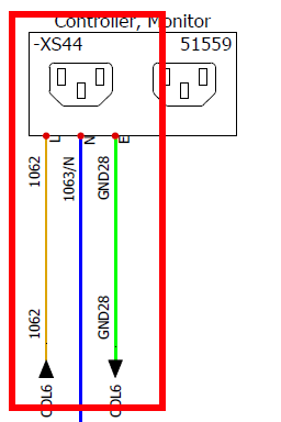

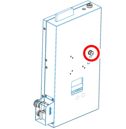

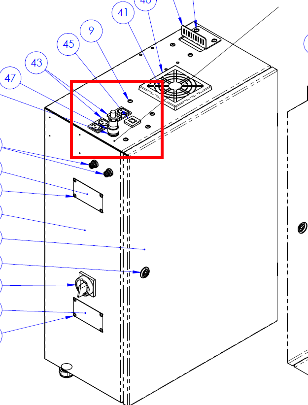

  1. Reseat the power cord connection at both the electrical cabinet outlet (XS44) and the controller.
  2. If needed, measure for 208-240 Vac between wires 1062 and 1063/N at the XS44 Controller/Monitor outlet.
Wires 1062 - 1063/N
1500MX Console Power Outlet (XS44) - Top of Electrical Cabinet
1500MX Console XS3 Connector

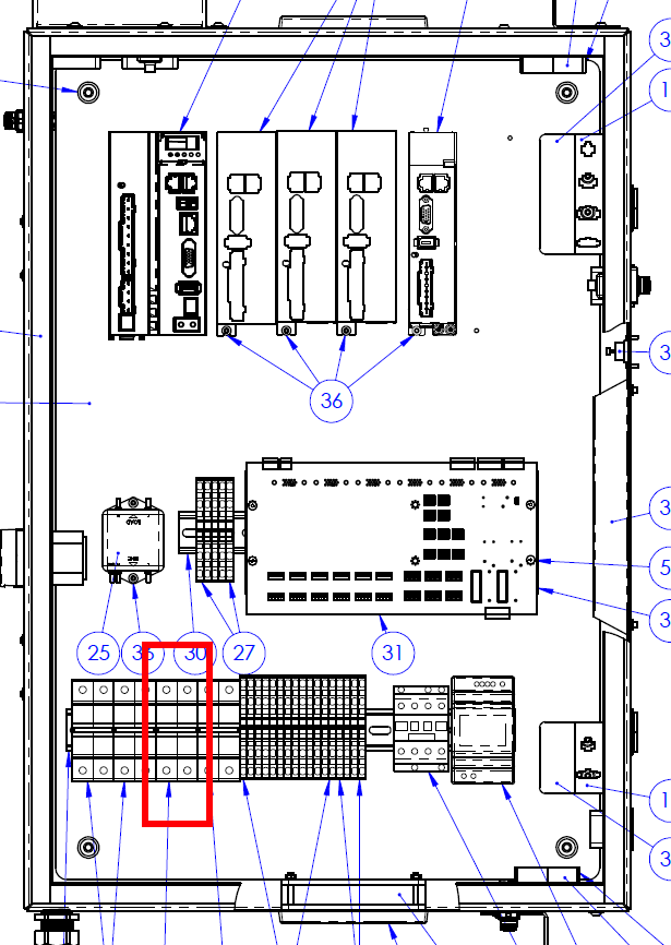

Reset the CB2 Circuit Breaker In the Machine
Reason: The CB2 circuit break tripped.

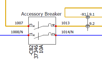

  1. If the operator console, automatic oiler, flood coolant pump, washdown coolant pump, and automatic tool changer don’t have power, examine the power cords and wires for damaged or exposed wires, and then reset the CB2 circuit breaker.
  2. If needed, measure for 208-240 Vac between wires 1013 and 1014/N at the CB2 circuit breaker.
Wires 1013 - 1014/N
1500MX CB2 Location

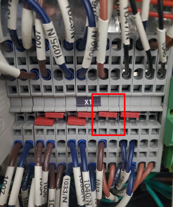

Check the X1 Terminal Block Jumper
Reason: The X1 Terminal Block Jumper is missing or loose.
  1. If one or more of the following don’t have power - operator console, automatic oiler, flood coolant pump, and washdown coolant pump - check that the jumper is in position between terminals 9 and 10 on X1 terminal block.
  2. If needed, measure for 208 Vac-240 Vac between wires 1013 and 1014/N at the CB2 circuit breaker. (See the image above)
1500MX X1 Jumper Location
