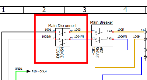

  2. If needed, measure for 208-240 Vac between wires 1001 and 1002/N at the DISC1 Main Disconnect.
Wires 1001 - 1002/N

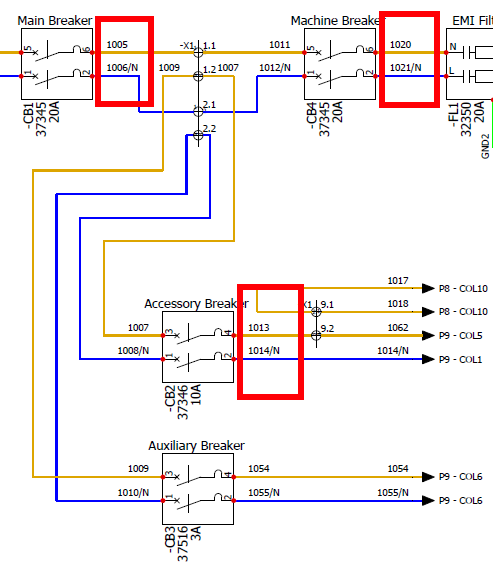

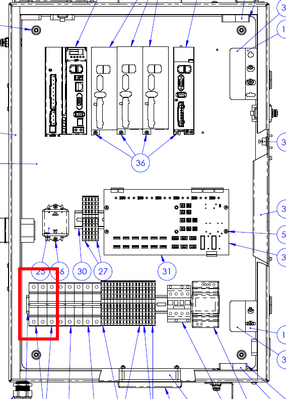

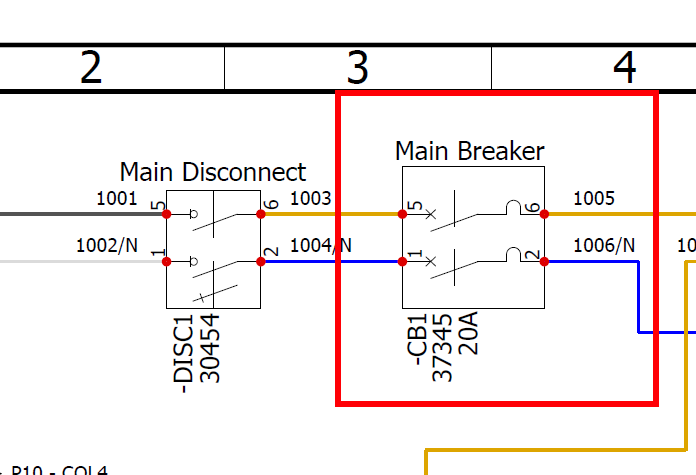

Reset the CB1 Circuit Breaker In the Machine
Reason: The CB1 breaker is tripped.
  1. If the mill, controller, accessories, and enclosure lights don’t have power, examine the power cords and wires for damaged or exposed wires, and then reset the CB1 circuit breaker.
  2. If needed, measure for 208-240 Vac between wires 1005 and 1006/N at the CB1 circuit breaker.
Wires 1005 - 1006/N
CB1 Location

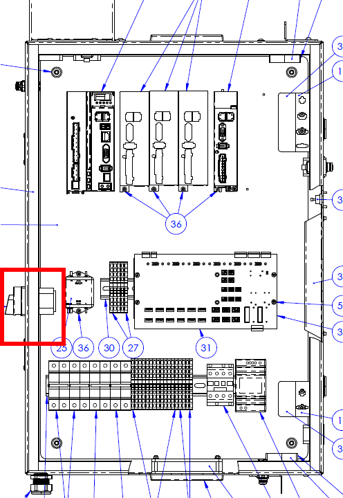

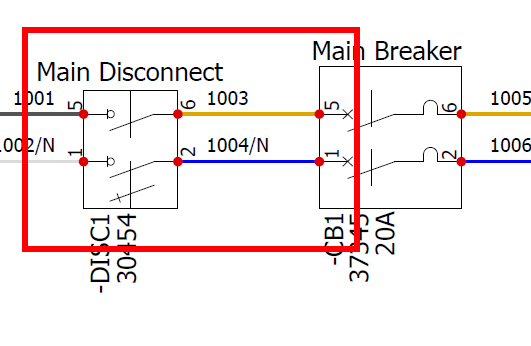

Check the Position of the Main Disconnect Switch
Reason: The Main Disconnect switch is in the OFF position.
  1. Switch DISC1 Main Disconnect to the ON position.
  2. If needed, measure for 208-240 Vac between wires 1003 and 1004/N at the DISC1 Main Disconnect.
Wires 1003 - 1004/N
Main Disconnect (DISC1) Location

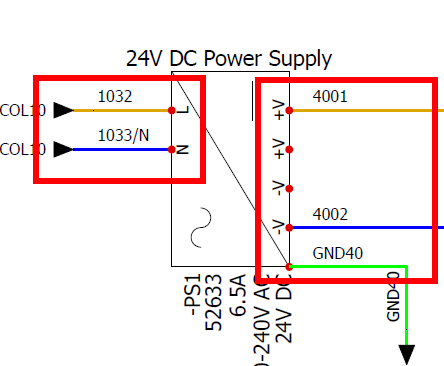

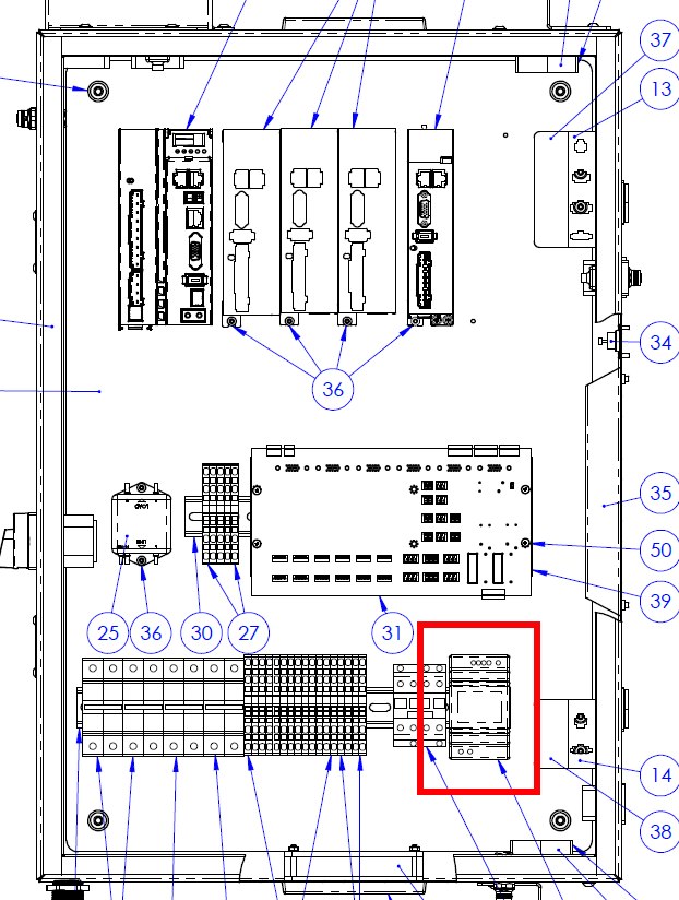

Check the DC Power Supply
Reason: The DC power supply is defective.

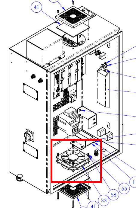

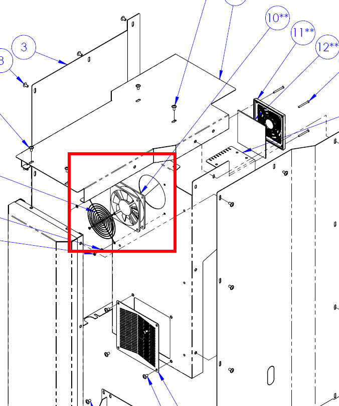

  1. Check if Electrical Cabinet Fan (FAN1) and Spindle Motor Fan (FAN2) are running.
  2. Check for DC OK LED on the PS1 DC power supply.

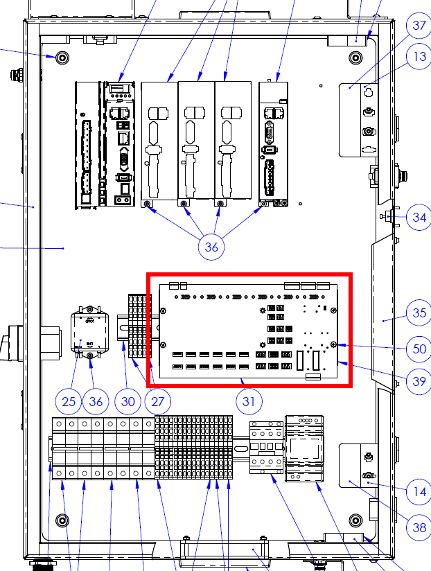

  3. Check for Control Power (D37) LED on E1 Servo IO Breakout Board.
  4. Measure for 208 Vac-240 Vac between wires 1032 and 1033/N at the PS1
    DC power supply.
  5. Measure for 24 Vdc nominal between wires 4001 and 4002 at the PS1 DC
    power supply.
Wire 1032 - 1033/N and 4001 - 4002 Location
Spindle Motor Fan (FAN2) Location
DC Power Supply (PS1) Location
Servo IO Breakout Board (E1) Location
Adjust the DC Power Supply PS1 Output Voltage
Reason: The DC power supply PS1 output voltage is too low.
  1. Check if Electrical Cabinet Fan (FAN1) and Spindle Motor Fan (FAN2) are running. (See images above)
  2. Check for DC OK LED on PS1 DC power supply. (See images above)
  3. Measure for 208-240 Vac between wires 1032 and 1033/N at the PS1 DC power supply. (See images above)
  4. Measure for 24 Vdc nominal between wires 4001 and 4002 at the PS1 DC power supply. (See images above)
  5. If output voltage is less than 24 Vdc, adjust the output voltage using the +V ADJ trim potentiometer on the front of the PS1 DC power supply.

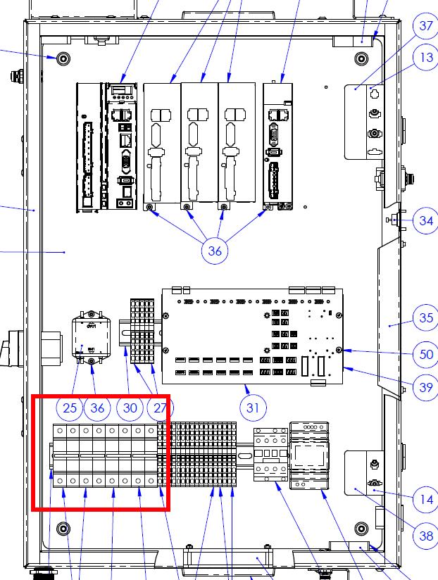

Reset Machine Circuit Breakers
Reason: The CB1, CB2, or CB4 circuit breaker tripped.
  1. Examine the power cords and wires for damaged or exposed wires, and then reset the circuit breaker.
  2. If needed, measure for 208-240 Vac between wires 1005 and 1006/N at the CB1 circuit breaker, between wires 1013 and 1014/N at the CB2 circuit breaker, and between wires 1020 and 1021/N at the CB4 circuit breaker.
Breaker Output Wire Locations
Circuit Breaker Locations
