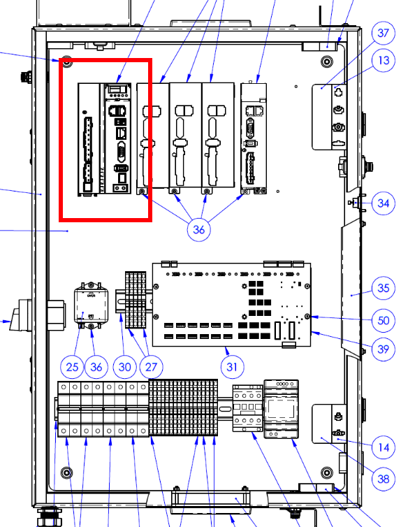

Check Spindle Driver
Reason: There’s no power to the spindle servo drive.
  1. Examine the servo drive display: it has power if its indicator lights are on.
    When power is removed, the servo drive display remains active until the internal capacitors dissipate their energy. That usually takes about five seconds.
    1500MX Spindle Drive Location
