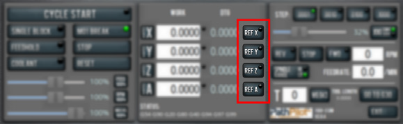

Reference the Machine
NOTE: Unlike past Tormach machines, the 1500MX does not need to be referenced on every start up. For more detailed information, see “About Referencing”.
Figure 1: Reference buttons.
About Referencing
The axes are referenced during assembly and, aside from the A-axis, do not need re-referencing after powering on or once the Emergency Stop button is released. You must reference the X-, Y-, or Z-axis or the ATC at the following times:
  • After replacement of a linear motion component such as linear rails, ballscrew, or servo motor
  • Disconnection of an encoder battery and powering off of the machine
  • Disconnection of the encoder cable from the servo motor
When referencing the X-, Y-, and Z-axis, the machine moves to the end of travel, presses against the bumper on the ballscrew until torque increases, and then backs off to the index pulse of the encoder.

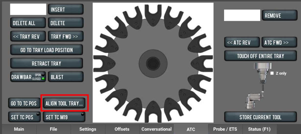

To reference the ATC, select the Align Tool Tray button on the ATC tab. When referencing, an ATC pocket is aligned to the flange of a tool holder in the spindle until both parts of the ATC fork open evenly when engaging the flange of the tool holder.
Figure 2: Align Tool Tray Button

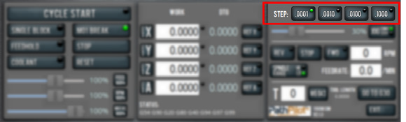

Figure 5: Step buttons (in G20 mode).

About Step Jogging

Provides variable-speed Step button toggles between available jog step sizes.
  • A four-position rotary switch selects the active axis.
Note: In PathPilot, the currently selected axis is shown in the Position Status group. A green light appears next to the Axis DRO to indicate the active axis.
  • A three-position rotary switch selects the jog step size.

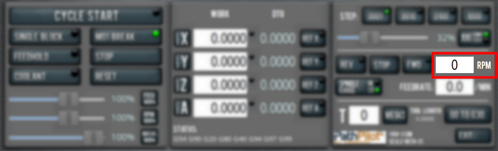

Figure 6: RPM DRO
  1. In the RPM DRO field, type the desired RPM speed. Then select the Enter key.
  2. Select FWD to start the spindle in the forward direction, or REV to start the spindle in the reverse direction.
  3. Select Stop to stop the spindle.

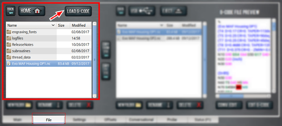

Load G-Code
To run a G-code program on a PathPilot controller, you must first verify that the file is on the controller. For more information on transferring and moving files, see Transfer Files to and From the Controller.
To load G-code:
  2. Select Load G-Code.
Figure 7: Controller Files window on the File tab.

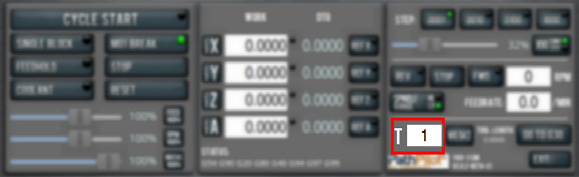

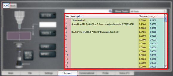

Set Tool Length Offsets
Before running a G-code program, PathPilot must know the length of the tools that are required for the program. For more information on using tool length offsets, see "About Tool Offsets" (page 9).
NOTE: You can import a .csv file with tool length offset data. For information, see “Import and Export the Tool Table”.
To set tool length offsets:
    For information, see "Set Up Tooling".
Figure 8: Tool Table window on the Offsets tab.

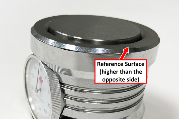

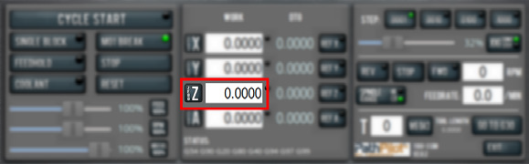

Set a Known Reference Height
  2. Verify that the drive dogs won't contact the reference surface before the end face of the spindle.
  8. While moving the paper back-and-forth across the reference surface, slowly step the Z-axis down (-Z) until you feel a light pull on the piece of paper. This indicates that the paper is contacting the end face of the spindle.
Figure 9: Z-axis work offset DRO field.

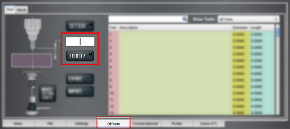

This procedure sets the tool length offset using a known reference height. If you have not yet done so, you must first set the Z zero position; go to Set a Known Reference Height.
Figure 10: Tool DRO field.
Figure 11: Touch Z DRO field and button.
  1. Select Touch Z.

Figure 15: Tool Height Setter

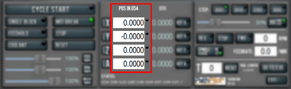

Set Work Offsets
  • Select Zero [Axis].
Figure 16: Work Offset DRO fields.
To change work offsets:
Figure 17: Work offset indicated in the PathPilot interface.
