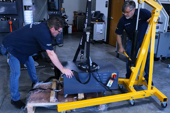

Unpack the Through-Spindle Coolant Kit
WARNING! Lifting Hazard: Only use suitable lifting equipment, ensuring that it's on a stable, level surface. Never lift over people. Heavy loads could tip, fall, or shift unexpectedly, causing death or serious injury.
  1. The TSC pump is approximately 400 lb (180 kg). We strongly recommend lifting it from the shipping pallet with an engine hoist. Due to the uneven weight distribution (one side is heavier), have an assistant help to guide and stabilize the pump during the lift to prevent tipping or injury.
Figure 1: Removing the TSC pump from the pallet.
  1. Remove the pallet, and slowly guide the pump to the ground.
  2. Unpack the shipping box with the remaining components of the TSC kit.

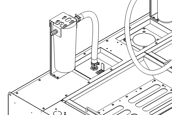

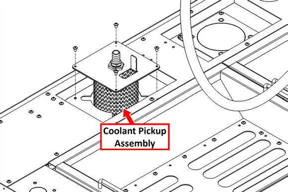

Install the Coolant Pickup and Filter

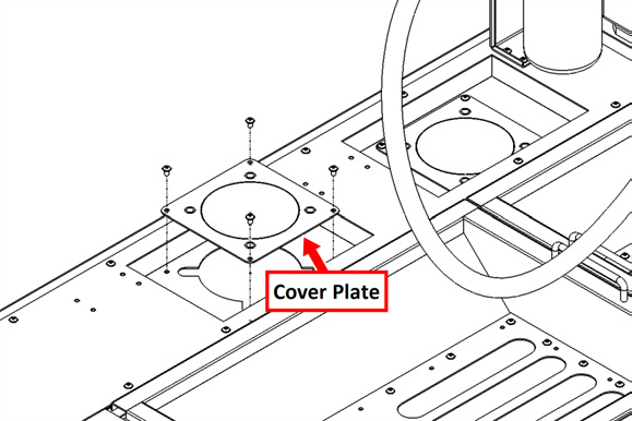

  1. Standing behind the coolant tank, locate the coolant pump cover plate furthest to the right. Remove the four M5 screws securing the pump cover plate with a 3 mm hex wrench. Set the screws aside.
Figure 2: Cover plate for through-spindle coolant on the coolant tank.
  1. Identify the coolant pickup assembly included in this kit. Remove the four bolts and screws that secure the assembly together with a 5/16 in. wrench. Put the basket into the coolant tank hole, then put the coolant filter on top so that the opening flap is nearest to the machine. Secure the assembly to the coolant tank with the M5 screws that you set aside and a 3 mm hex wrench.
Figure 3: Installing the coolant pickup assembly into the coolant tank.

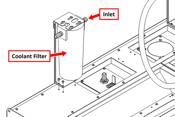

  1. Identify the coolant filter assembly and four M5 screws included with this kit. Put it onto the coolant tank so that the inlet is facing the pickup assembly. Secure it to the coolant tank with four M5 screws and a 3 mm hex wrench.
Figure 4: Installing the coolant filter assembly onto the coolant tank.
WARNING! High-Pressure Hazard: Ensure all hose connections are secure and properly tightened. High-pressure coolant can cause hoses to burst or become dislodged if not correctly installed, leading to serious injury or equipment damage.
  1. Identify the shortest PVC hose included in this kit. Using two 1.25 in. hose clamps, connect the hose between the barbed fitting on the pickup assembly and the inlet of the filter assembly.
Figure 5: Hose connection between the coolant pickup assembly and the coolant filter.

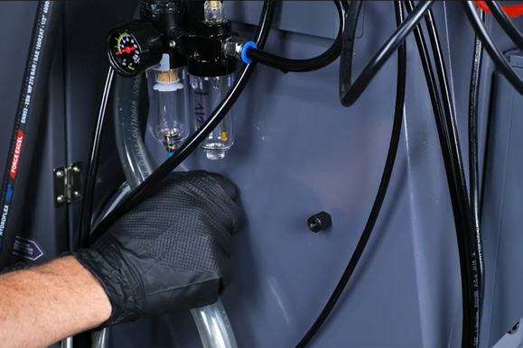

  1. Identify the longest piece of 3/4 in. ID PVC hose. Using two 1.25 in. hose clamps, connect the hose between the barbed fitting on the outlet of the filter assembly and the inlet of the TSC pump labeled Coolant Inlet.

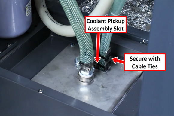

  2. Identify the 1/2 in. ID PVC hose. Connect one end of the hose to the barbed fitting on the TSC pump labeled Pressure Relief with a 1 in. hose clamp. Insert the loose end into the slot on the top of the coolant pickup assembly, and secure it to the vertical tab with two cable ties.
Figure 6: 1/2 in. ID hose installed in the coolant pickup assembly.

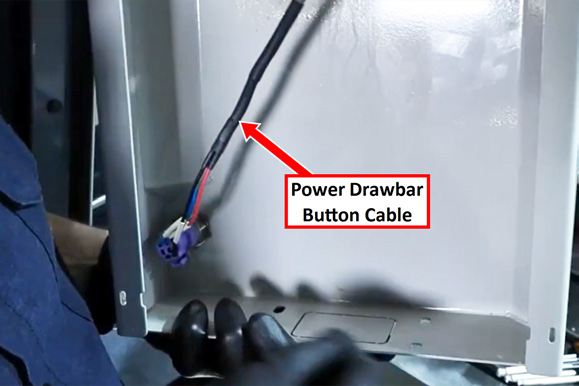

  4. Before removing the remaining screws on the front panel, snip off the cable ties holding the power drawbar button cable along the inside edge of this panel.
  5. Remove the screws along the bottom front edge of the panel and lower the panel slightly to access the cable along the top left. Snip the cable tie holding this cable in place.
  6. Disconnect the power drawbar button cable from the front panel by pressing in the connector's latch and removing it from the drawbar button.
Figure 7: Power drawbar button cable on the front panel.
  1. Remove the front panel and set it aside, along with all of the screws.

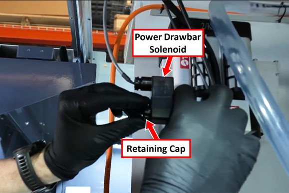

  2. Remove the retaining cap from the drawbar solenoid. Let the solenoid dangle, but temporarily replace the cap to avoid losing it.
Figure 8: Removing the retaining cap from the drawbar solenoid.

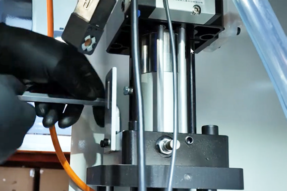

  1. Remove the four socket head cap screws that secure the power drawbar to its mounting plate using a 10 mm hex wrench. Set the screws aside.
Figure 9: Removing the screws securing the power drawbar to its mounting plate.

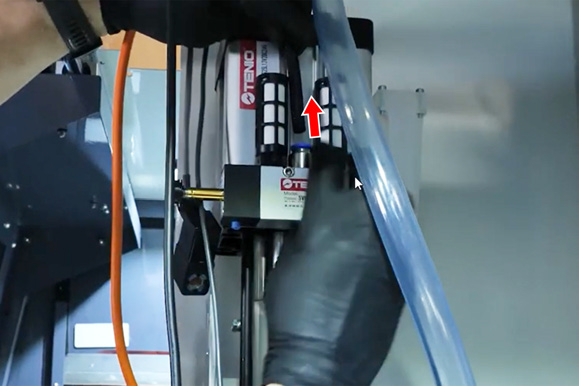

  1. Press down on the push-to-connect fitting and disconnect the air line by pulling it out.
Figure 10: Removing the air line from the push-to-connect fitting.
  1. Lift the power drawbar away from the mounting plate, being careful not to tug on the cables. Then set the power drawbar aside.

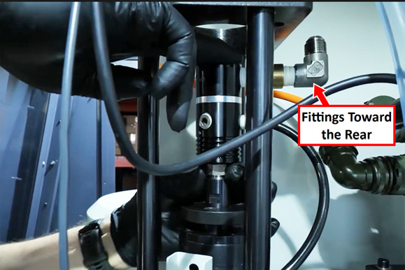

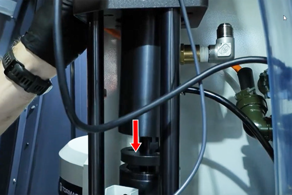

  2. Identify the piece of 1/4 in. OD tubing and the rotary union included in this kit. Insert one end of the tube into the push-to-connect fitting on the rotary union.
  3. Orient the rotary union so that the fittings are pointed toward the rear of the machine.
Figure 11: Orienting the rotary union.
  1. Thread the rotary union into the top of the spindle and tighten with a 22 mm wrench.
IMPORTANT! The rotary union has a left-hand thread.
  1. Re-install the power drawbar. Align the slot in the power drawbar extension with the fittings of the rotary union. Then secure it to the mounting plate with its original four screws that you set aside earlier.

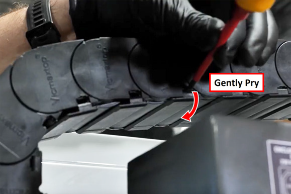

  1. The high-pressure hose is routed through the energy chain. To avoid damaging other cables, we strongly recommend removing several of the retaining covers from the chain. Gently pry up each cover with a flat-blade screwdriver and lift them off, continuing down the chain, including around the electrical connection cover. Set the covers aside.
Figure 13: Removing the covers from the energy chain.

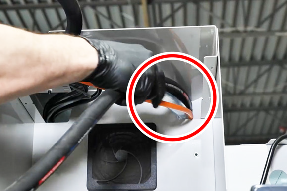

  1. Identify the high-pressure hose included with this kit. Route it through the energy chain channel, curving it to run towards the pump. Pull the loose end of the hose through the top section of the energy chain and pass it through the opening on the top right of the spindle, guiding it toward the rotary union.
Figure 14: Opening at the top of the spindle head cover.

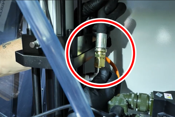

  1. Attach the end of the hose to the rotary union and tighten the hose nut with an open-end wrench. You may need to use a second wrench to hold the rotary union’s extension in place while tightening.

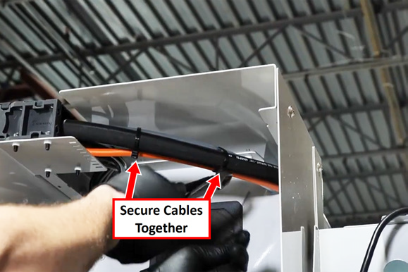

  1. At the top of the spindle head cover, cut off the front cable tie securing the cables. Re-secure the cable and the high-pressure hose to the channel with a new cable tie.
  2. At the rear of the machine, adjust the hose so that it's the same length as the other cables running through the energy chain, then secure them all together with two cable ties.
Figure 16: Securing the energy chain cables together.

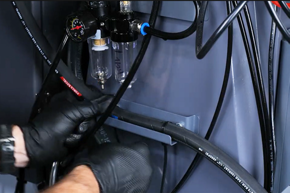

  1. Identify the hose bracket included with this kit, and align it onto the standoffs. Secure it with two cap head screws and a 5 mm hex wrench.
  2. Put the high-pressure hose onto the bracket, and secure it with two cable ties.

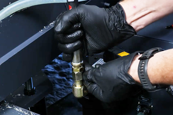

  1. Remove the cap from the TSC pump's outlet, and attach the loose end of the high-pressure hose. Securely tighten it with an adjustable wrench.
Figure 19: Connecting the high-pressure hose to the TSC pump.

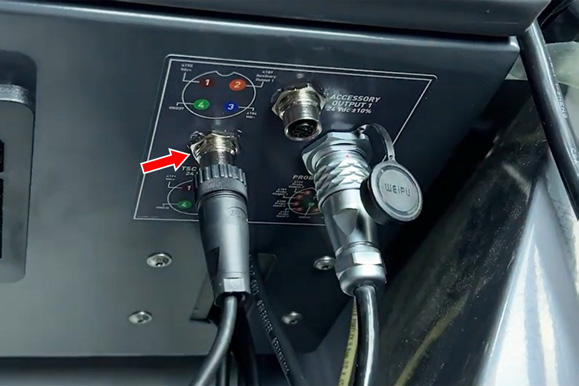

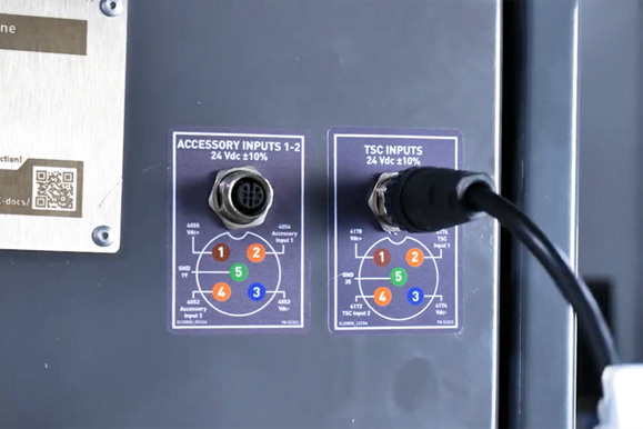

  1. Route the two electrical cables toward the electrical cabinet.
  2. On the side of the electrical cabinet, connect the cable labeled TSC Sensor to the TSC Inputs outlet.
Figure 20: TSC Inputs connection.
