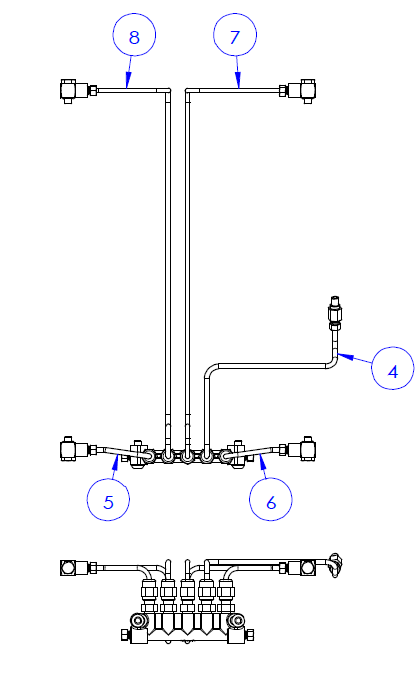

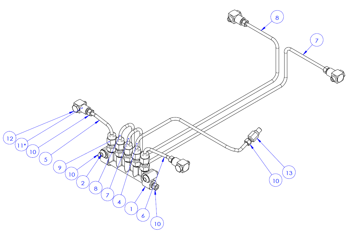

1500MX Knowledge Base
Alternative Part Number
5-Port Manifold (PN 33955)
Screw, Button Head Cap, M6 × 1 - 20, Stainless Steel
McMaster-Carr: 92095A240
Tubing, Nylon, 4 mm OD
McMaster-Carr: 50405K33
Lubrication Line, Copper, 1500MX X-Axis Ball Nut*
Lubrication Line, Copper, 1500MX X-Axis Bearing 1*
Lubrication Line, Copper, 1500MX X-Axis Bearing 2*
Lubrication Line, Copper, 1500MX X-Axis Bearing 3*
Lubrication Line, Copper, 1500MX X-Axis Bearing 4*
Fitting, Proportional Orifice, M8 × 1 (Male) - 4 mm (OD) Tube (PN 52511)
Fitting, Compression Nut, 4 mm Tube (PN 31310)
11
Fitting, Ferrule, 4 mm Tube (PN 31309)1
12
Fitting, Banjo Elbow, M6 × 1 - 4 mm Tube (PN 31311)
13
Fitting, Adapter, M6 × 0.75 P (Male) to M8 × 1 (Female) (PN 52512)
1Hidden inside fittings. See tube and ferrule connections reference in "Lubrication Assembly".
