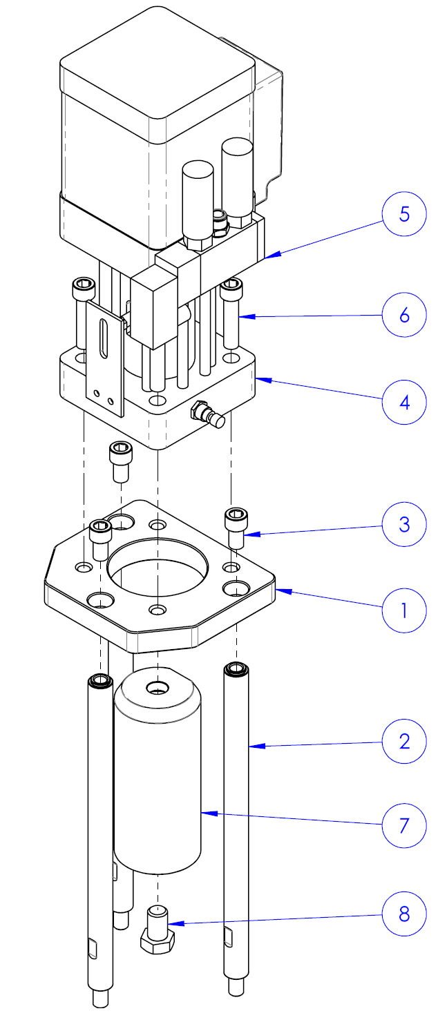

Power Drawbar Mount Plate, 1500MX*
Standoff, 299.5 mm, M12 × 1.75 - 20 Male, M12 × 1.75 - 15
Female, 45C*
Screw, Socket Head Cap, M12 × 1.75 - 20
McMaster-Carr: 91290A612
Power Drawbar Cylinder, 2.5T × 13 mm*
Drawbar Solenoid Assembly, 1500MX Drawbar (PN 53663)
Screw, Socket Head Cap, M12 × 1.75 - 50
McMaster-Carr: 91290A626
Power Drawbar CTS Extension Sleeve, 1500MX*
Screw, Hex Head Cap, M16 × 1.5 - 25
McMaster-Carr: 91180A913
