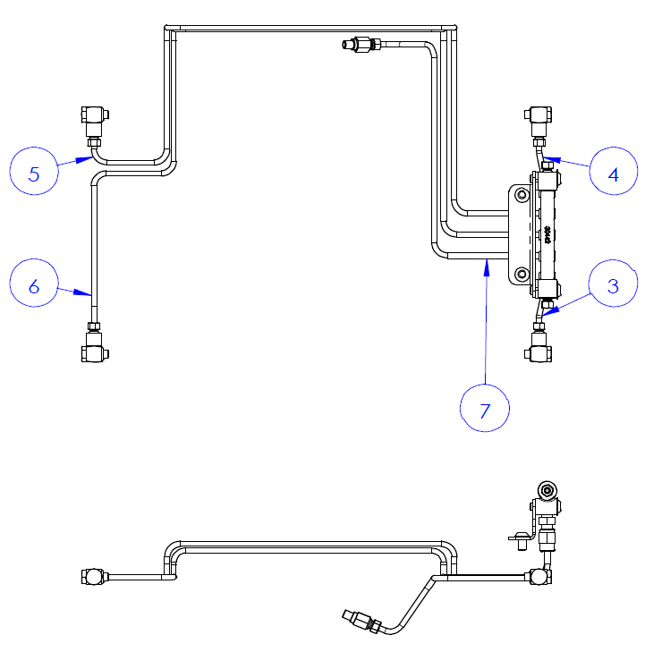

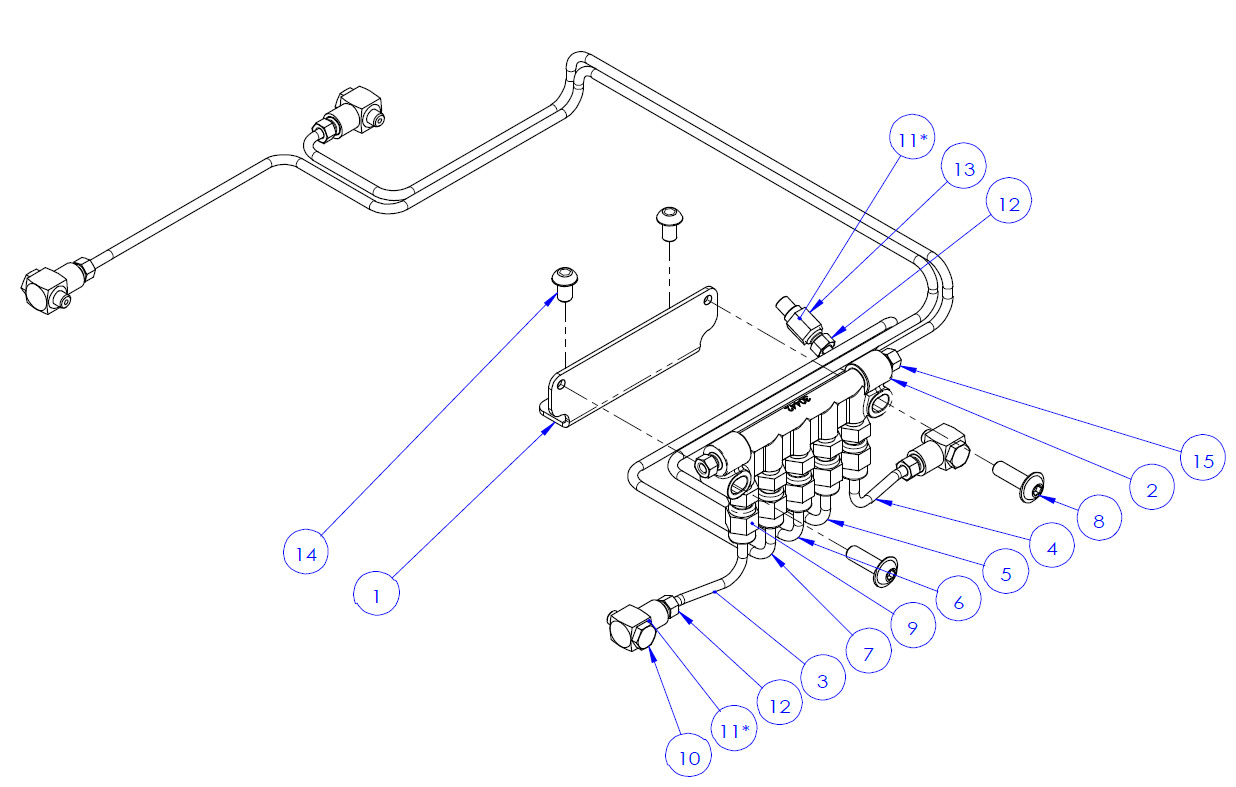

Y-Axis Lubrication Manifold Bracket, 1500MX (PN 51408)
5-Port Manifold (PN 33955)
Lubrication Line, Copper, 1500MX Y-Axis Bearing 1 (PN 52233)
Lubrication Line, Copper, 1500MX Y-Axis Bearing 2 (PN 52234)
Lubrication Line, Copper, 1500MX Y-Axis Bearing 3 (PN 52235)
Lubrication Line, Copper, 1500MX Y-Axis Bearing 4 (PN 52236)
Lubrication Line, Copper, 1500MX Y-Axis Ball Nut (PN 52231)
Screw, Button Head Cap, Flanged M6 × 1 - 20, 18-8 Stainless
(PN 51418)
McMaster-Carr: 90909A729
Fitting, Proportional Orifice, M8 × 1 (Male) - 4 mm (OD) Tube
(PN 52511)
Fitting, Banjo Elbow, M6 × 1 - 4 mm Tube (PN 31311)
11
Fitting, Ferrule, 4 mm Tube (PN 31309)1
12
Fitting, Compression Nut, 4 mm Tube (PN 31310)
13
Fitting, Adapter, M6 × 0.75 P (Male) to M8 × 1 (Female)(PN 52512)
14
Screw, Button Head Cap, M6 × 1 - 10, Stainless Steel
McMaster-Carr: 92095A224
15
Fitting, Plug, M8 × 1, Compression Type (PN 53005)
1Hidden inside fittings. See tube and ferrule connections reference in "Lubrication Assembly"
