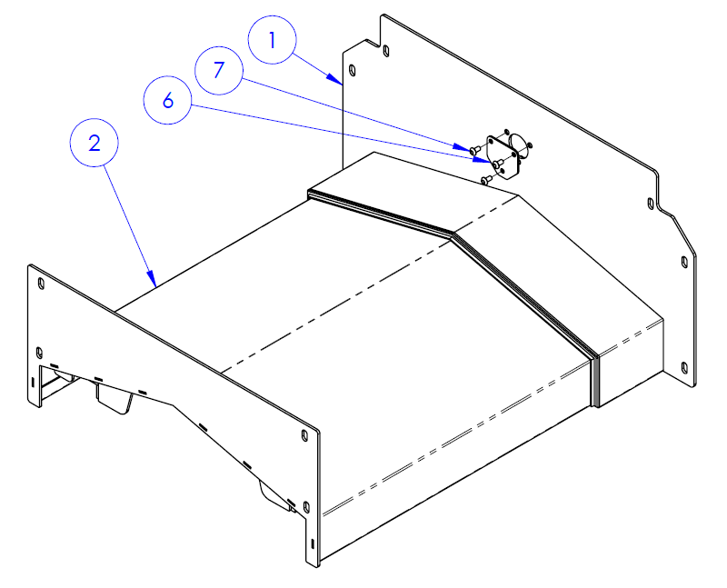

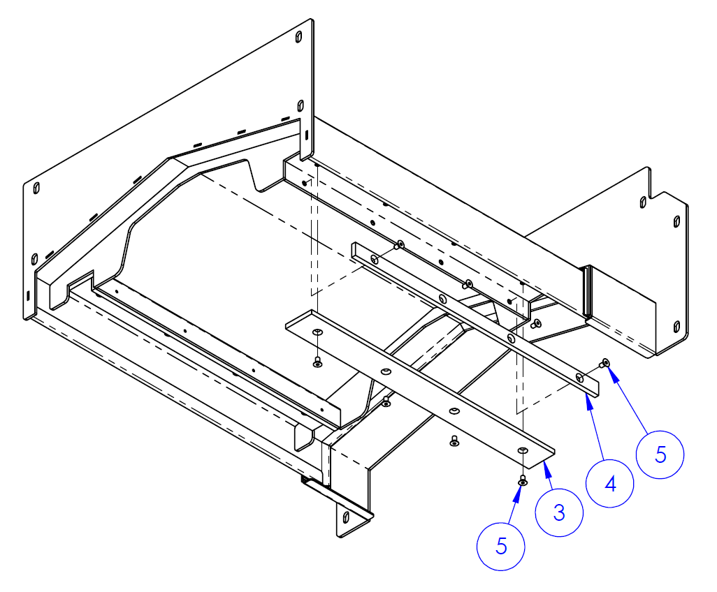

Base Segment, Y-Axis Rear Way Cover, 1500MX*
Moving Segment, Y-Axis Rear Way Cover, 1500MX*
Wide Slide Plate, Y-Axis Rear Way Cover, 1500MX*
Narrow Slide Plate, Y-Axis Rear Way Cover, 1500MX*
Screw, Socket Head Countersunk, M4 × 0.7 - 8, Stainless Steel
McMaster-Carr: 92125A188
16
Washdown Cover Plate, Y-Axis Rear Way Cover, 1500MX
(PN 51675)
Screw, Button Head Cap, M4 × 0.7 - 8, Stainless Steel
McMaster-Carr: 92095A189
