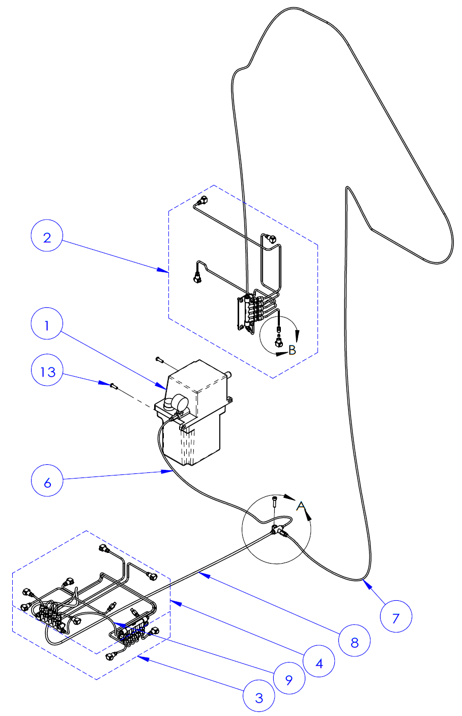

Lubrication Assembly - 1500MX
Alternative Part Number
Automatic Oiler Kit: 230 Vac (PN 31374)
Z-Axis Lubrication Assembly, 1500MX*
Y-Axis Lubrication Assembly, 1500MX*
X-Axis Lubrication Assembly, 1500MX (PN 51407)

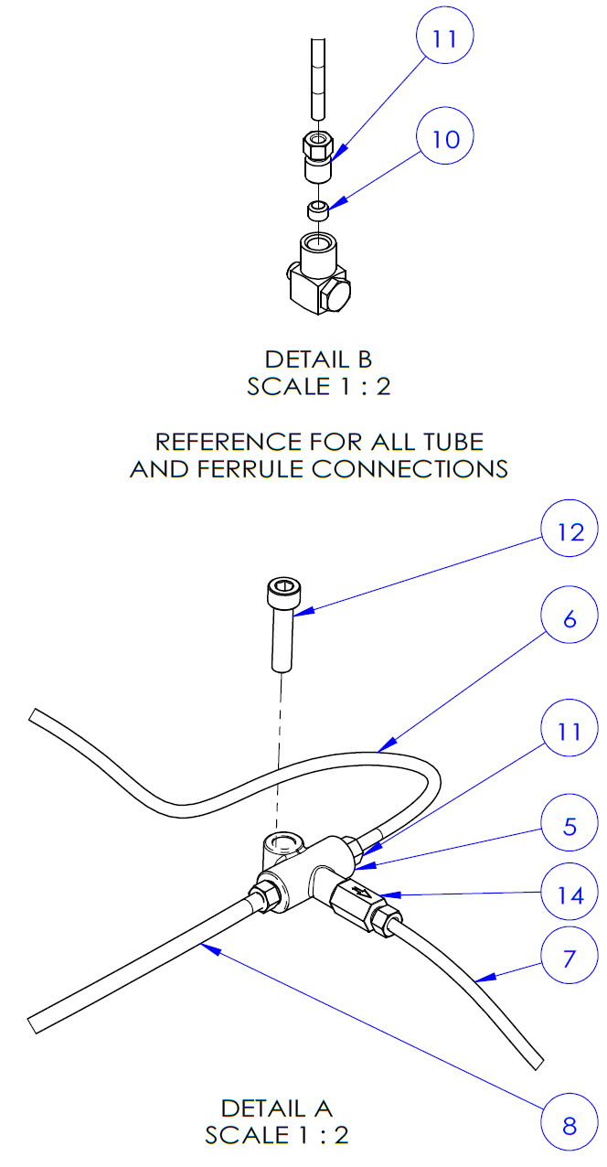

Fitting, Tee, 4 mm Tube, M8 × 1.0 Thread (PN 32354)
Tubing, Nylon, 4 mm OD, Semi-Clear, 72 cm Long
McMaster-Carr: 50405K33
Tubing, Nylon, 4 mm OD, Semi-Clear, 430 cm Long
Tubing, Nylon, 4 mm OD, Semi-Clear, 140 cm Long
Tubing, Nylon, 4 mm OD, Semi-Clear, 29 cm Long
Fitting, Ferrule, 4 mm Tube (PN 31309)
11
Fitting, Compression Nut, 4 mm Tube (PN 31310)
12
McMaster-Carr: 91290A330
13
Screw, Button Head Cap, M6 × 1 - 20, Stainless Steel
McMaster-Carr: 92095A240
14
Fitting, Check Valve, M8 × P1.0 - 4 mm Tube (PN 52912)
