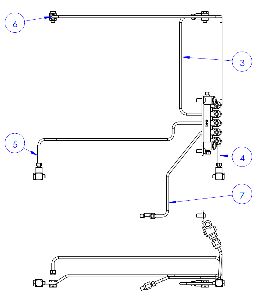

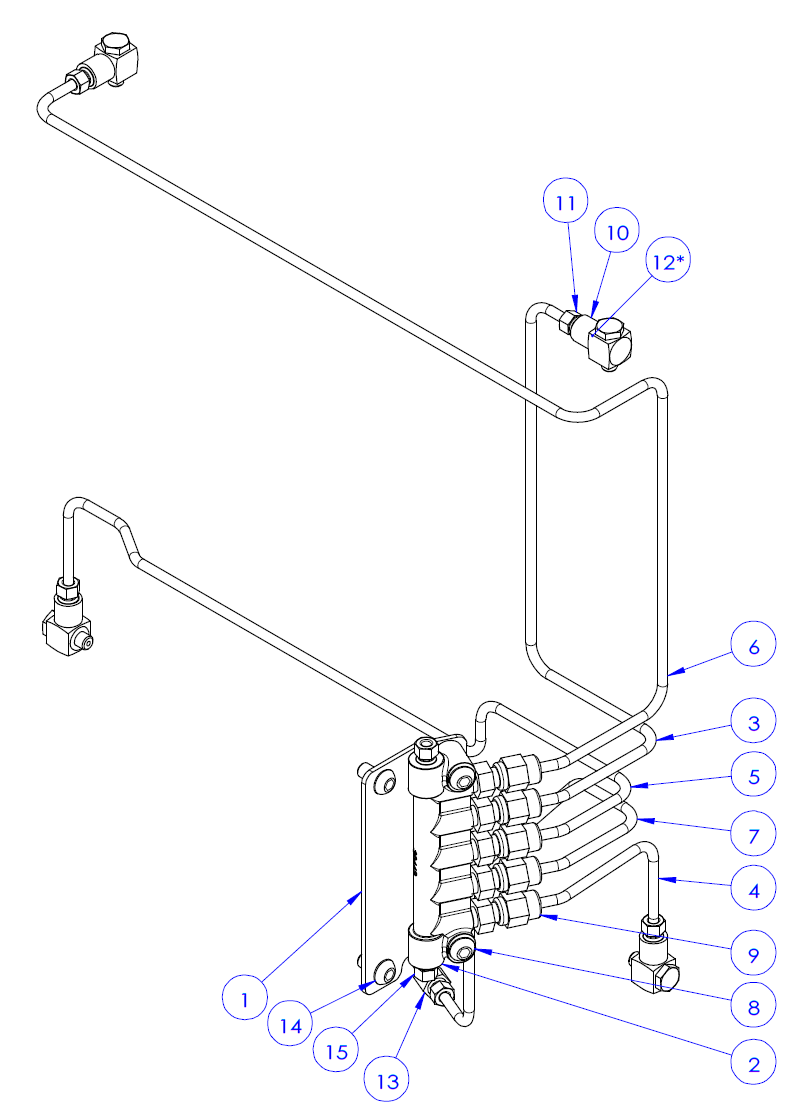

Bracket, Z-Axis Oil Distributor Mount, 1500MX (PN 51402)
5-Port Manifold (PN 33955)
Lubrication Line, Copper, 1500MX Z-Axis Bearing 1 (PN 52238)
Lubrication Line, Copper, 1500MX Z-Axis Bearing 2 (PN 52239)
Lubrication Line, Copper, 1500MX Z-Axis Bearing 3 (PN 52240)
Lubrication Line, Copper, 1500MX Z-Axis Bearing 4 (PN 52241)
Lubrication Line, Copper, 1500MX Z-Axis Ball Nut (PN 52237)
Screw, Button Head Cap, M6 × 1 - 20, Stainless Steel
McMaster-Carr: 92095A240
Fitting, Proportional Orifice, M8 × 1 (Male) - 4 mm (OD) Tube
(PN 52511)
Fitting, Banjo Elbow, M6 × 1 - 4 mm Tube (PN 31311)
11
Fitting, Compression Nut, 4 mm Tube (PN 31310)
12
Fitting, Ferrule, 4 mm Tube (PN 31309)1
13
Fitting, Adapter, M6 × 0.75 P (Male) to M8 × 1 (Female)
(PN 52512)
14
Screw, Button Head Cap, M6 × 1 - 12, Stainless Steel
McMaster-Carr: 92095A226
15
Fitting, Plug, M8 × 1, Compression Type (PN 53005)
1Hidden inside fittings. See tube and ferrule connections reference in "Lubrication Assembly".
