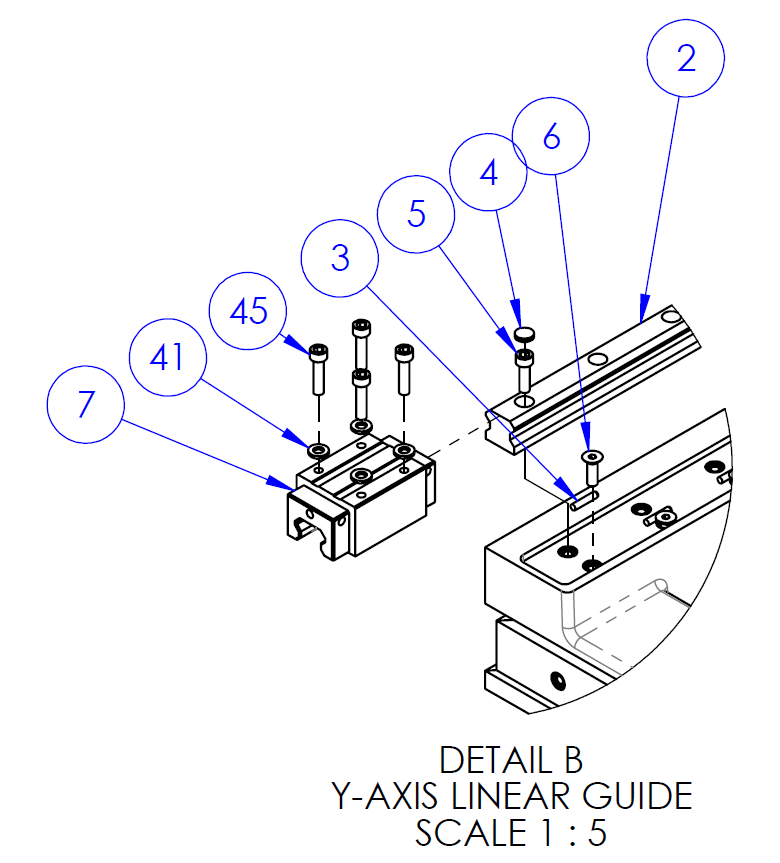

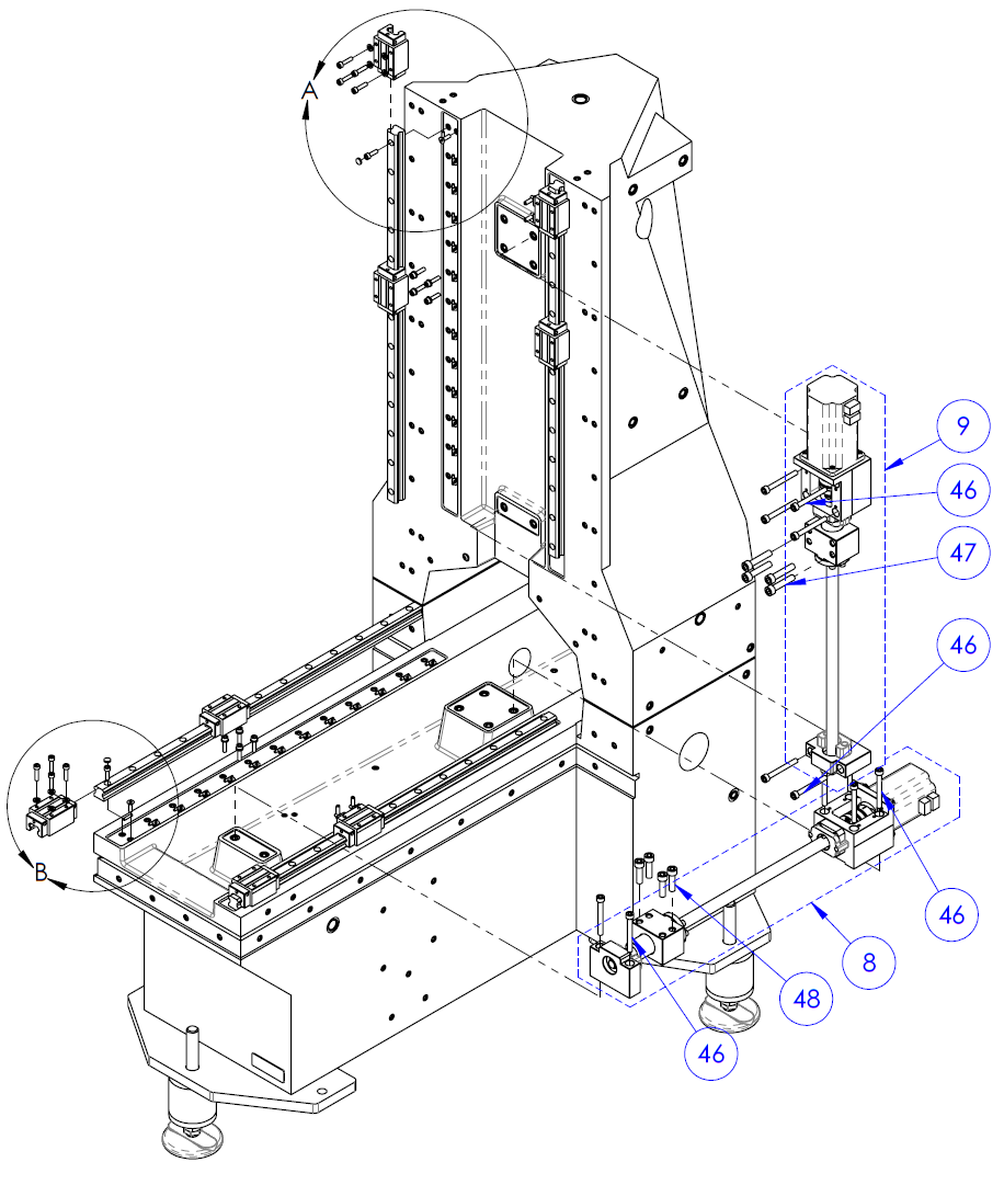

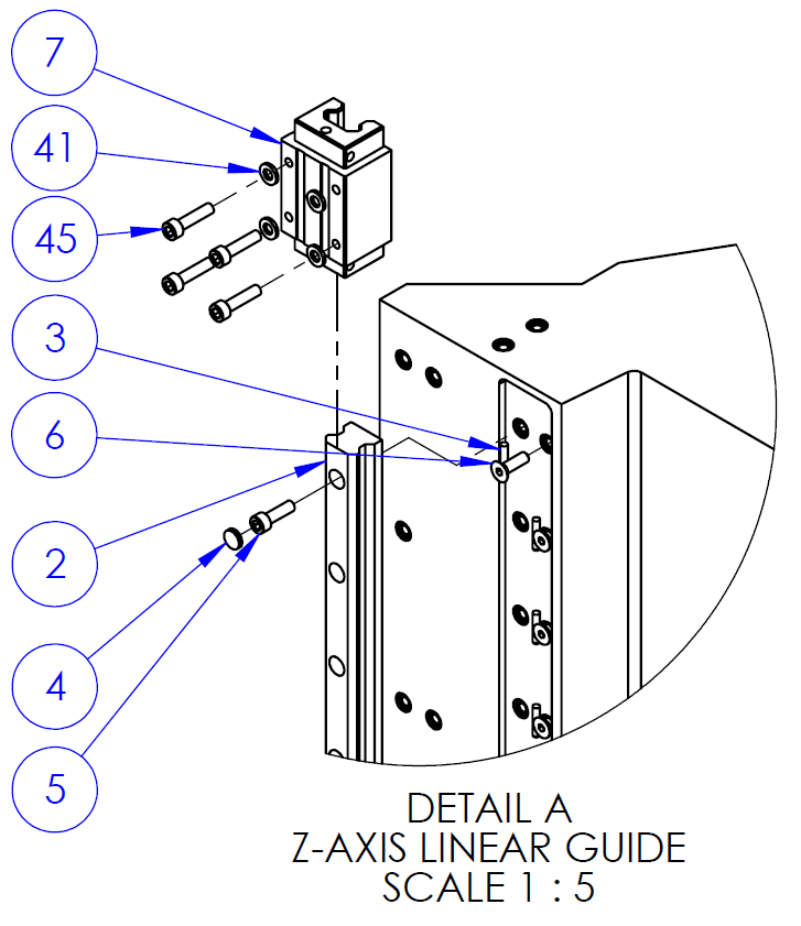

Base-Column Subassembly, 1500MX*
Linear Rail, 25 mm, 760 mm Long, Precision H, M6 Top Down Mount (PN 51340)
Pin, 4 × 20 (PN 51342)
60
Linear Guide Rail Bolt Cap, M6, Plastic with O-Ring (PN 51350)
52
Screw, Socket Head Cap, M6 × 1 - 20
McMaster-Carr: 91290A326
54
Screw, Socket Head Countersunk, M6 × 1 - 20
McMaster-Carr: 92125A240
60
Linear Guide Block, 25 mm, Precision H, ZA Preload, Interchangeable, M6 Top Down Mount (PN 51341)
Linear Actuator Assembly, 350 mm Travel, 10 mm Lead (PN 51334)
Linear Actuator Assembly, 356 mm Travel, 5 mm Lead (PN 51335)

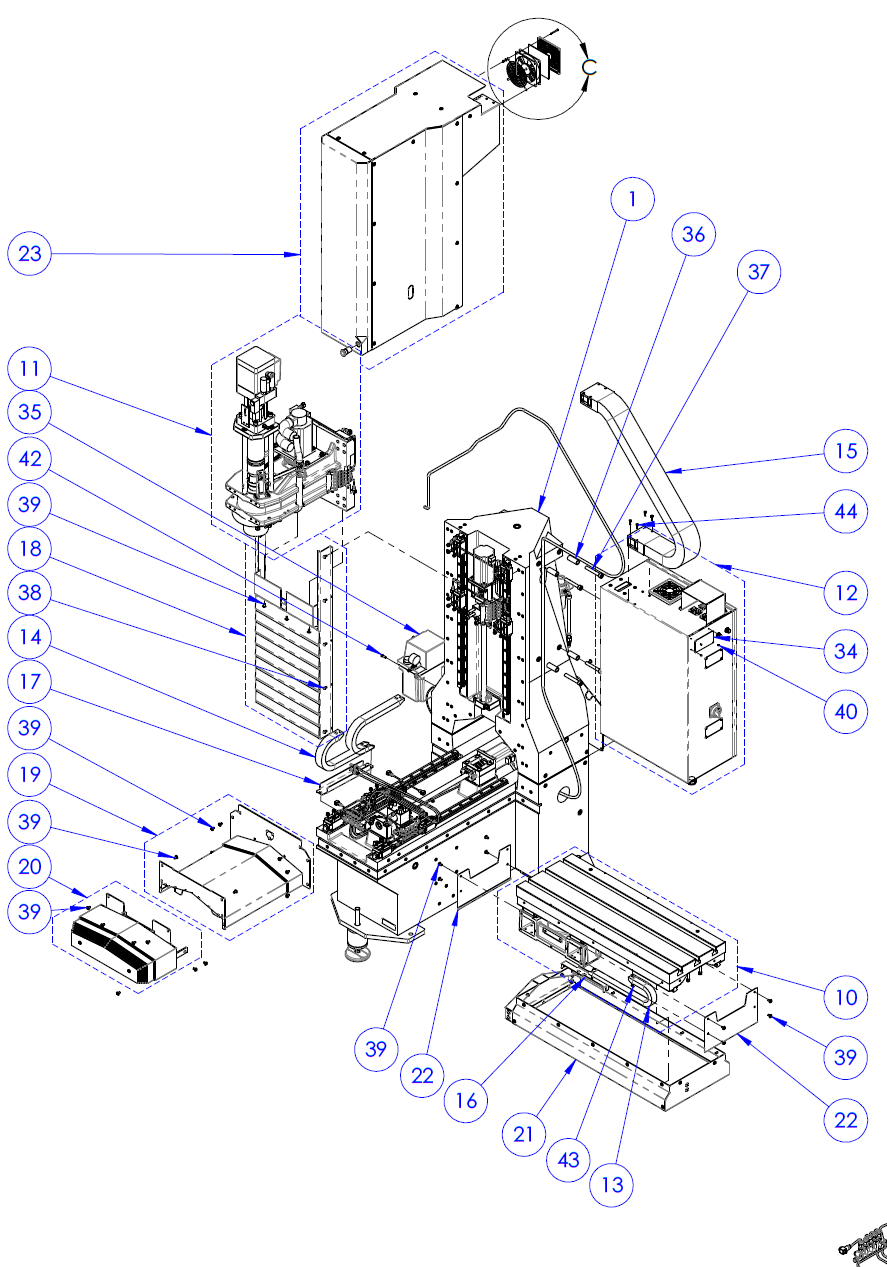

X-Axis Subassembly, 1500MX (PN 51223)
11
Spindle Head Assembly, 1500MX (PN 51127)
12
Electrical Cabinet Assembly, 1500MX (PN 51228)
13
X-Axis Drag Chain, 1500MX (PN 51422)
14
Y-Axis Drag Chain, 1500MX (PN 51423)
15
Z-Axis Drag Chain, 1500MX (PN 51424)
16
X-Axis Drag Chain Guide, 1500MX (PN 51767)
17
Y-Axis Drag Chain Guide, 1500MX (PN 51773)
18
Z-Axis Way Cover Assembly, 1500MX (PN 51204)
19
Y-Axis Rear Way Cover Assembly, 1500MX (PN 51205)
20
Y-Axis Front Way Cover Assembly, 1500MX (PN 51206)
21
X-Axis Sheet Metal Cover Assembly, 1500MX (PN 51231)
22
Saddle Cover Right/Left Panel, 1500MX (PN 51448)
23
Spindle Head Sheet Metal Cover Assembly, 1500MX (PN 51398)
24
Base-Column Rear Access Panel, 1500MX (PN 51743)
25

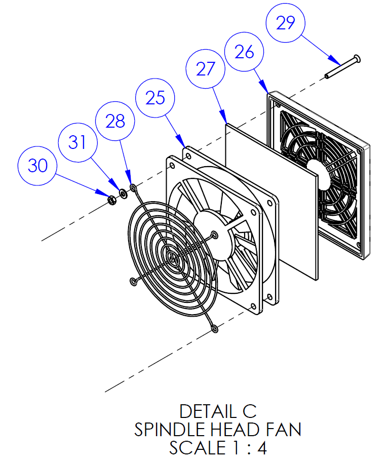

Fan (24 Vdc, 120 mm) (PN 37526)
26
Electrical Cabinet Exhaust Cover Retainer (PN 37947)
27
Electrical Cabinet Exhaust Filter (PN 37948)
28
Fan Guard, Wire (PN 30515)
29
Screw, Phillips Head Countersunk, M4 × 0.7 - 40, Zinc Plated
McMaster-Carr: 91420A250
30
Nut, Hex, M4, Zinc Plated
McMaster-Carr: 90591A255
31
Washer, Flat, M4
McMaster-Carr: 91166A230
32

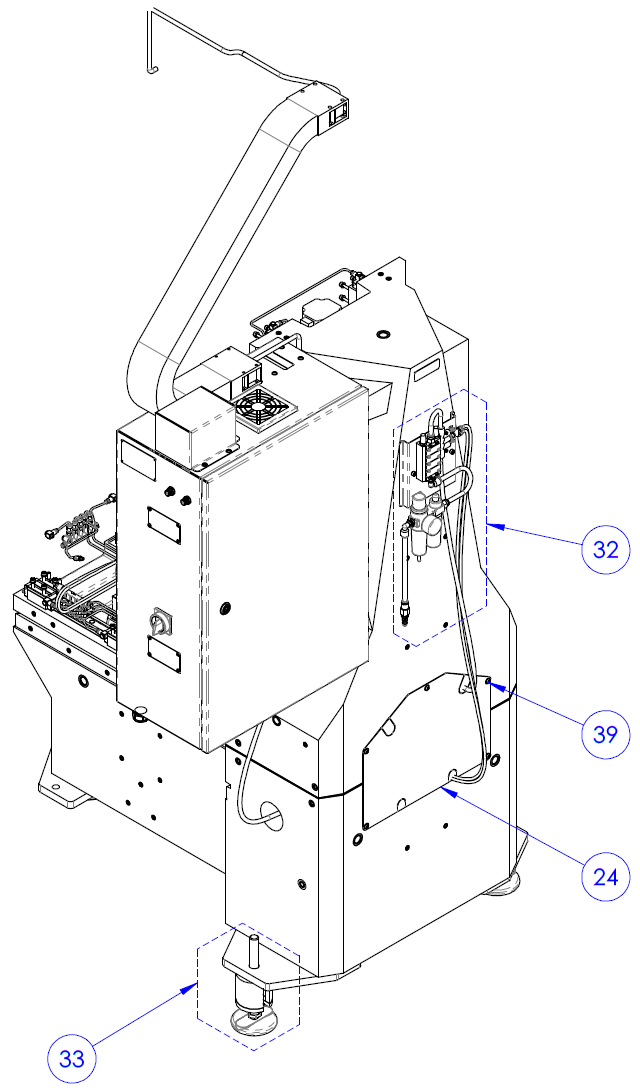

Machine Pneumatics Assembly, 1500MX*
33
Machine Foot Assembly, 1500MX (PN 51309)
34
Serial Number Plate, 1500MX (PN 51715)
35
Lubrication Assembly, 1500MX*
36

Screw, Socket Head Cap, M8 × 1.25 - 70
McMaster-Carr: 91290A460
12
47
Screw, Socket Head Cap, M10 × 1.5 × 50
McMaster-Carr: 91290A218
48
Screw, Socket Head Cap, M10 × 1.5 - 35
McMaster-Carr: 91290A526
49
