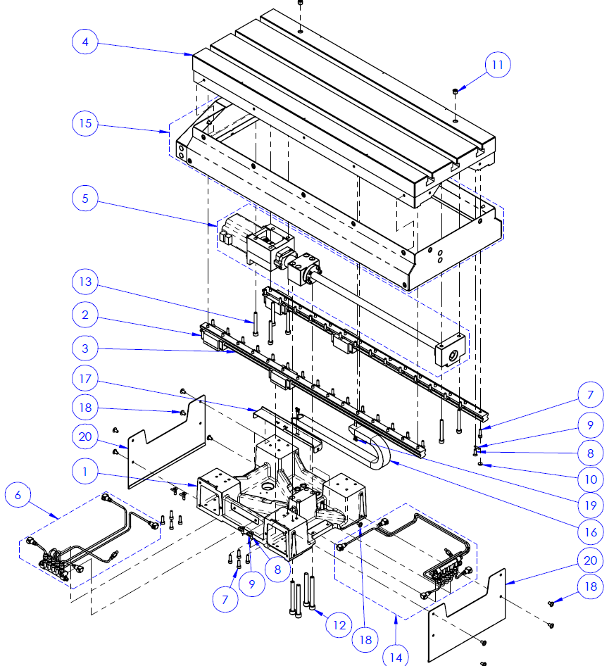

X-Axis Assembly - 1500MX
Alternative Part Number
Saddle Casting, 1500MX*
Linear Guide Block, 25 mm, Precision H, ZA Preload, Interchangeable, M6 Top Down Mount (PN 51341)
Linear Rail, 25 mm, 880 mm Long, Precision H, M6 Top-Down Mount (PN 51339)
Mill Table Casting, 1500MX*
Linear Actuator Assembly, 500 mm Travel, 10 mm Lead (PN 51333)
X-Axis Lubrication Assembly, 1500MX (PN 51407)
Screw, Socket Head Cap, M6 × 1 - 20
McMaster-Carr: 91290A326
46
Screw, Socket Head Countersunk, M6 × 1 - 20
McMaster-Carr: 92125A240
34
Pin, 4 × 20
McMaster-Carr: 91595A167
34
Linear Guide Rail Bolt Cap, M6, Plastic with O-Ring (PN 51350)
30
11
Screw, Cup Point Set, M12 × 1.75 - 12
McMaster-Carr: 91390A169
12
Screw, Socket Head Cap, M10 × 1.5 - 100
McMaster-Carr: 91290A548
13
Screw, Socket Head Cap, M8 × 1.25 - 70
McMaster-Carr: 91290A460
14
Y-Axis Lubrication Assembly, 1500MX*
15
X-Axis Sheet Metal Cover Assembly, 1500MX (PN 51231)
16
X-Axis Drag Chain, 1500MX (PN 51422)
17
X-Axis Drag Chain Guide, 1500MX (PN 51767)
18
McMaster-Carr: 97654A380
19
Screw, Socket Head Cap, M3 × 0.5 - 10
McMaster-Carr: 91290A115
20
Saddle Cover Right/Left Panel, 1500MX (PN 51448)
