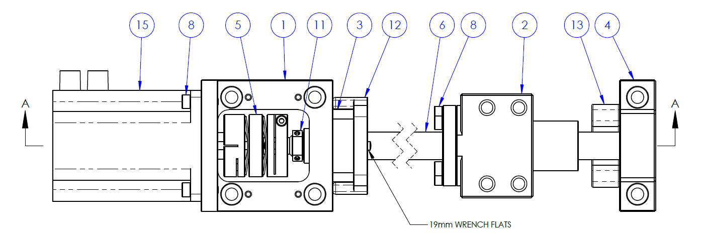

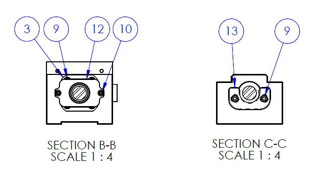

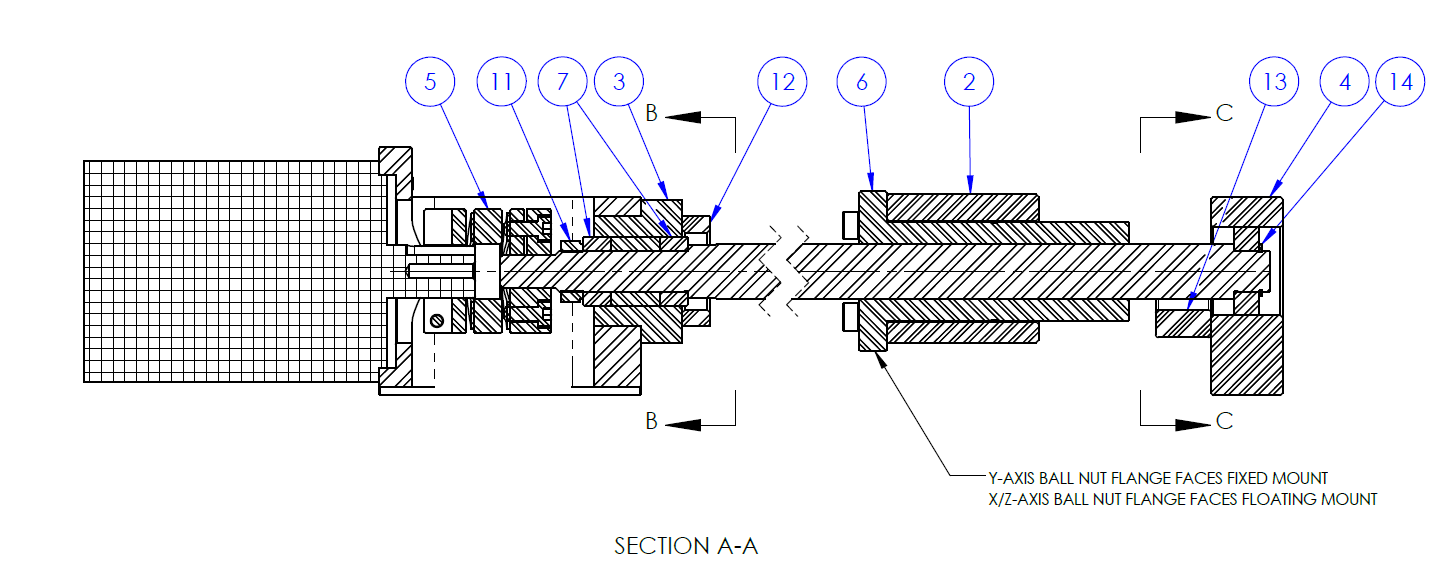

Servo Motor Mount, 80 mm Frame, 70mm Pilot (PN 51260)
Ball Nut Bracket, 20 mm*
Ball Screw Support, Fixed-Side (PN 51256)
Ball Screw Support, Floating-Side, 15 mm ID, 45 mm Bore Height (PN 51261)
Coupler, Double Disc, 12 mm Bore × 19 mm Bore (PN 51300)
X-Axis Ball Screw Assembly, 20 mm OD (PN 51744)
Y-Axis Ball Screw Assembly, 20 mm OD (PN 51279)
Z-Axis Ball Screw Assembly, 20 mm OD (PN 51745)
Spacer, Ball Screw Fixed Side Support, 25 mm OD × 15 mm ID × 10mm Thick (PN 51336)
Screw, Socket Head Cap, M6 × 1 - 20
McMaster-Carr: 91290A326
Screw, Socket Head Cap, M5 × 0.8 - 16
McMaster-Carr: 91290A232
Screw, Socket Head Cap, M3 × 0.5 - 20
McMaster-Carr: 91290A123
11
Ball Screw Lock Nut, M15 × 1
Misumi: BNRC15
12
Servo Motor Mount Bumper*
13
Ball Screw Support Bumper (PN 51303)
14
Retaining Ring, External, OD, 15 mm
McMaster-Carr: 98541A410
15
X-Axis/Y-Axis Servo Motor, 750W (PN 51810)
Z-Axis Servo Motor, 750W (PN 51258)
16
X-Axis Servo Power Cable (PN 51571)
Y-Axis Servo Power Cable (PN 51572)
Z-Axis Servo Power Cable (PN 51573)
17
X-Axis Servo Encoder Cable (PN 51568)
Y-Axis Servo Encoder Cable (PN 51569)
Z-Axis Servo Encoder Cable (PN 51570)
