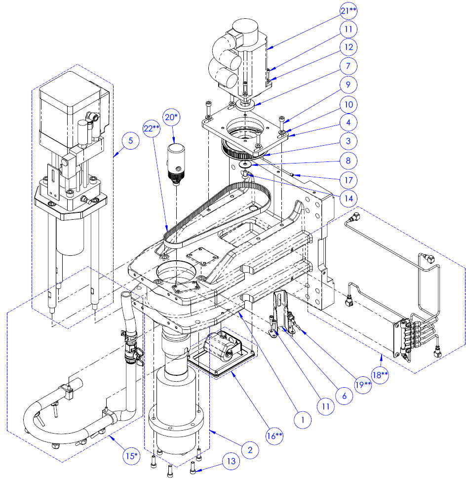

Spindle Head - 1500MX
Alternative Part Number
Spindle Head Casting, 1500MX (PN 51234)
1500MX Spindle Cartridge Assembly, BT30, 10000 rpm, 5MHTD-36T Pulley, Through Spindle Coolant (CTS) (PN 51347)
Spindle Motor Pulley, 1500MX (PN 51235)
Spindle Motor Mount Plate, 1500MX (PN 51236)
Power Drawbar Cylinder Assembly, 1500MX (PN 51237)
Spindle Index Sensor Bracket, 1500MX (PN 51244)
Spindle Motor Pulley Spacer, 1500MX (PN 52217)
Spindle Motor Pulley Washer, 1500MX (PN 52218)
Screw, Socket Head Cap, M8 × 1.25 - 30
McMaster-Carr: 91290A434
Washer, Flat, M8
McMaster-Carr: 91166A270
11
Screw, Socket Head Cap, M6 × 1 - 20
McMaster-Carr: 91290A326
12
Washer, Flat, M6
McMaster-Carr: 91455A120
13
Screw, Socket Head Cap, M8 × 1.25 - 25
McMaster-Carr: 91290A432
14
Screw, Socket Head Countersunk, M8 × 1.25 - 20
McMaster-Carr: 91294A284
15
Coolant Ring Assembly, 1500MX (PN 51247)*
16
Spindle Head Camera Assembly, 1500MX (PN 52463)**
17
Screw, Cup Point Set, M6 × 1 - 8
McMaster-Carr: 91390A127
18
Z-Axis Lubrication Assembly, 1500MX (PN 51433)**
19
Proximity Sensor, PNP-NO, 3-Wire, 8 mm Body (PN 51547)**
20
Through Spindle Coolant Rotary Union, 1500MX (PN 51604)*
21
Servo Motor, 1500 W, 220 V, 10.8 A, 3000 RPM, Oil Seal (PN 51152)**
22
Belt, 1500MX Spindle**
Gates 800-5M-15
McMaster-Carr: 7939K26
*Optional accessory, not included with base machine.
**component not included in this assembly, but shown here for context.
